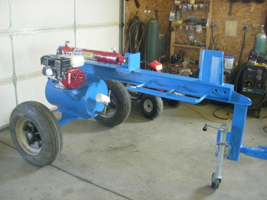

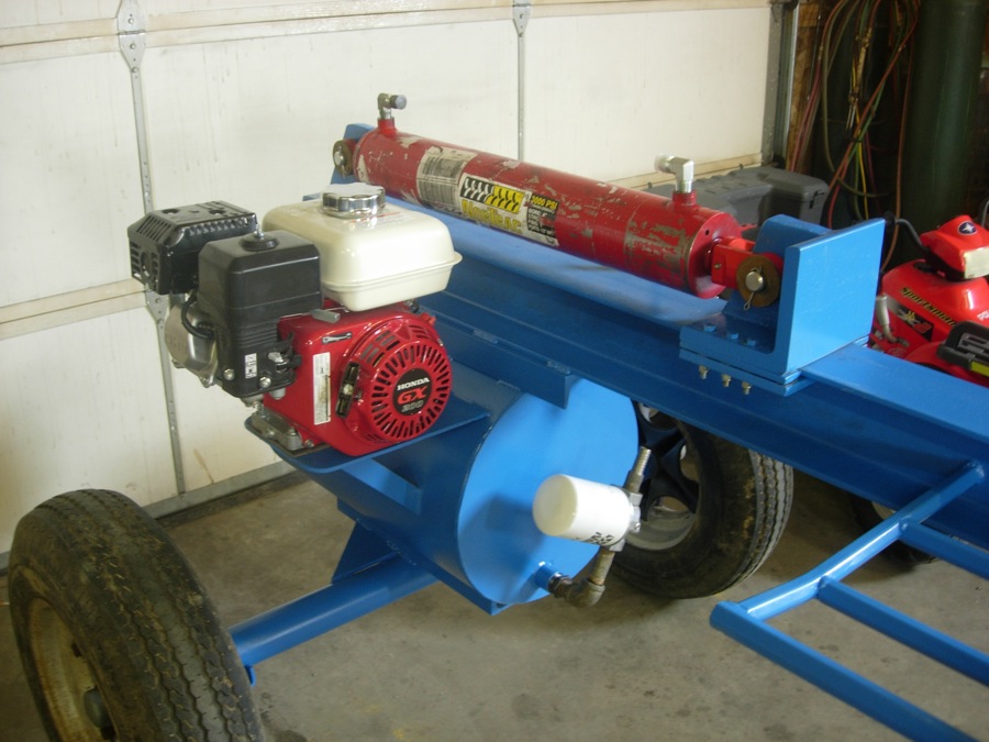

Waiting on hoses, other than that i think she is done!
   / show your homemade splitter pics here #93
Nice Job Moose!!!! I like what you did with the tank and motor mount.
Let the fun begin!!!!
   / show your homemade splitter pics here #94
I started gathering materials for the next build. Box blade for my driveway.
All the rain we've been having has wrecked havoc on it.
   / show your homemade splitter pics here #96
one problem is thelocation of the pin in your wedge related to the hieght of your wedge, a slanted log will pop the front bolt on your slider like butter
   / show your homemade splitter pics here #97
I would possibly look into moving the added separators on the wedge further toward the knife edge. Doing this will increase the speed of the splitter tremendously.
   / show your homemade splitter pics here #98
Moose, that wouldn't happen to be the 5x30 Nortrac cylinder i had my eye on from ebay a month or so ago would it???
   / show your homemade splitter pics here #99
No its a 4x24 from Northern. Still not happy with how it arrived.
Not sure if you can see in the pics but it has packing and shipping stickers all over it not to mention about half of the paint has been scratched off.
Shipped it bare with no bubble wrap, box or even wrapped in paper.
   / show your homemade splitter pics here #100
Moose-I bought a used Lion 4x24 for the last splitter i built and that's how it arrived also, but since i got it off ebay for cheap i didn't complain. I'm gonna pitch a good gripe if i spend $200 on a 5x24 nortrac from Northern and it arrives half as bad as yours looks! Good looking machine though!
