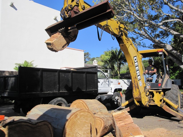

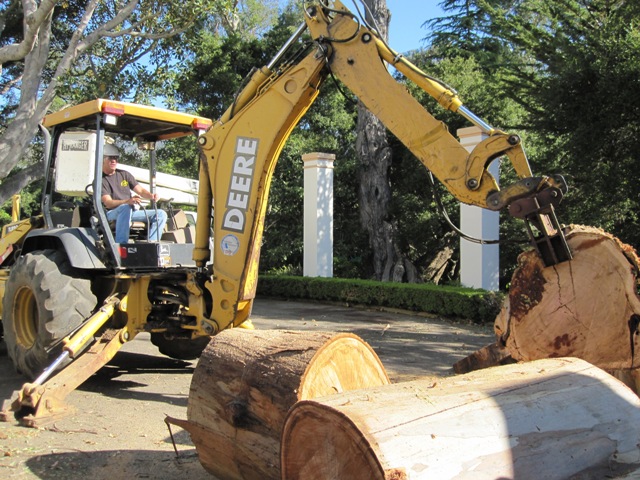

Used the splitter on a job today:

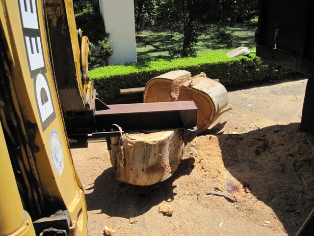

   / show your homemade splitter pics here #84
Forgot how much fun this thing is, splitting across the grain 30" dia log!

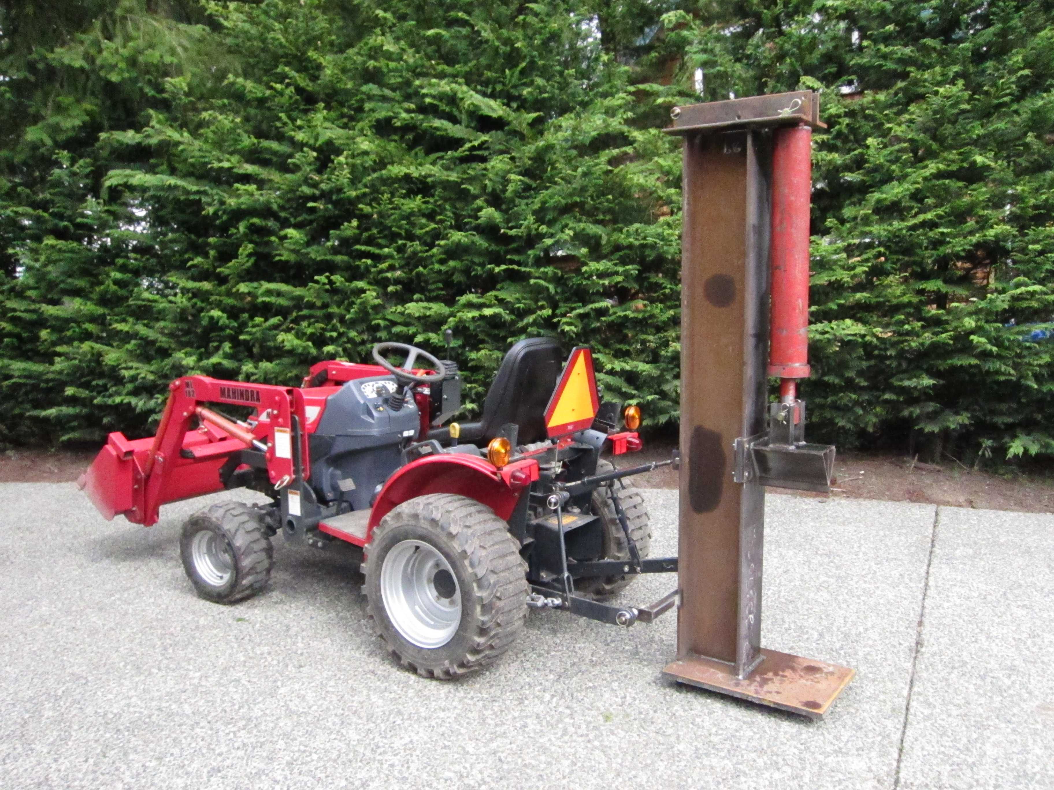

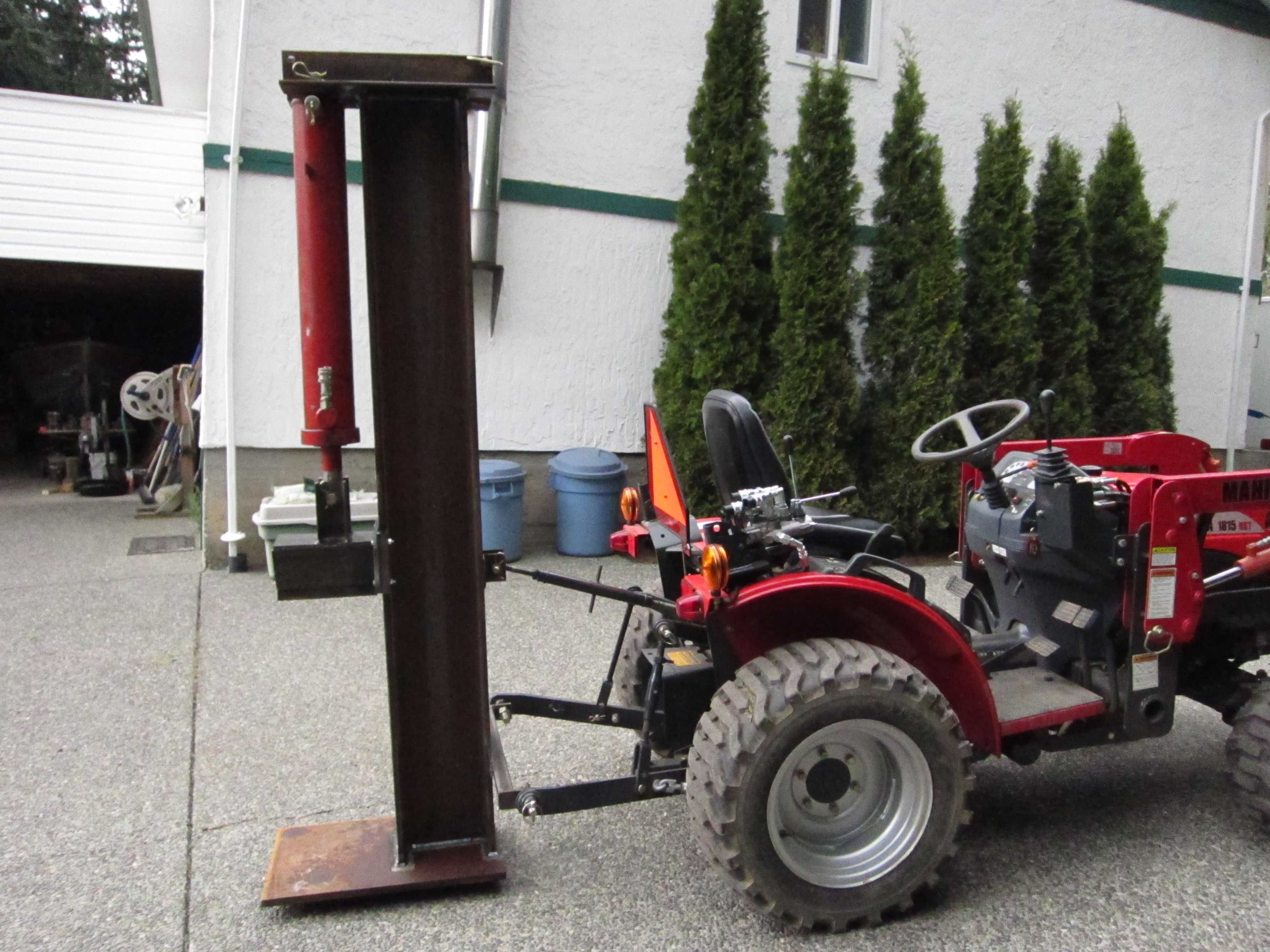

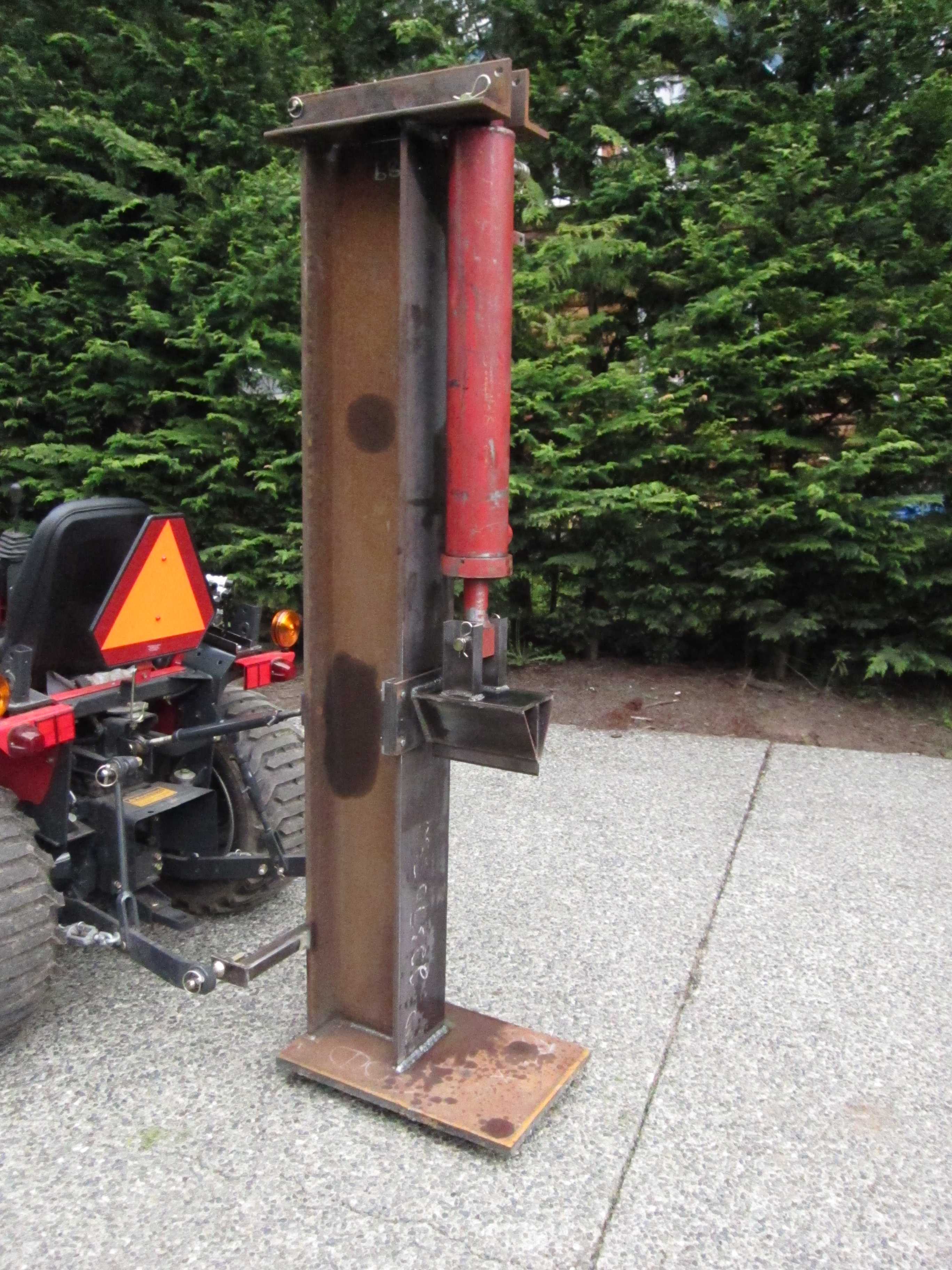

   / show your homemade splitter pics here #85
Here's mine, just finished.
One of the hoses I have is a bit too short so haven't been able to try it out.
   / show your homemade splitter pics here #86
How long do you think that wedge skid will last? It looks short on beef,
   / show your homemade splitter pics here #89
I know what you mean now.
I tried it tonight and the pieces on the backside of the wedge guide bent a bit. I split some pieces that have been sitting for a while and had some big knots in them.
I'll need to get some heavier material but should be easy to fix.
The wedge itself worked well, just need to beef up the guide part.
