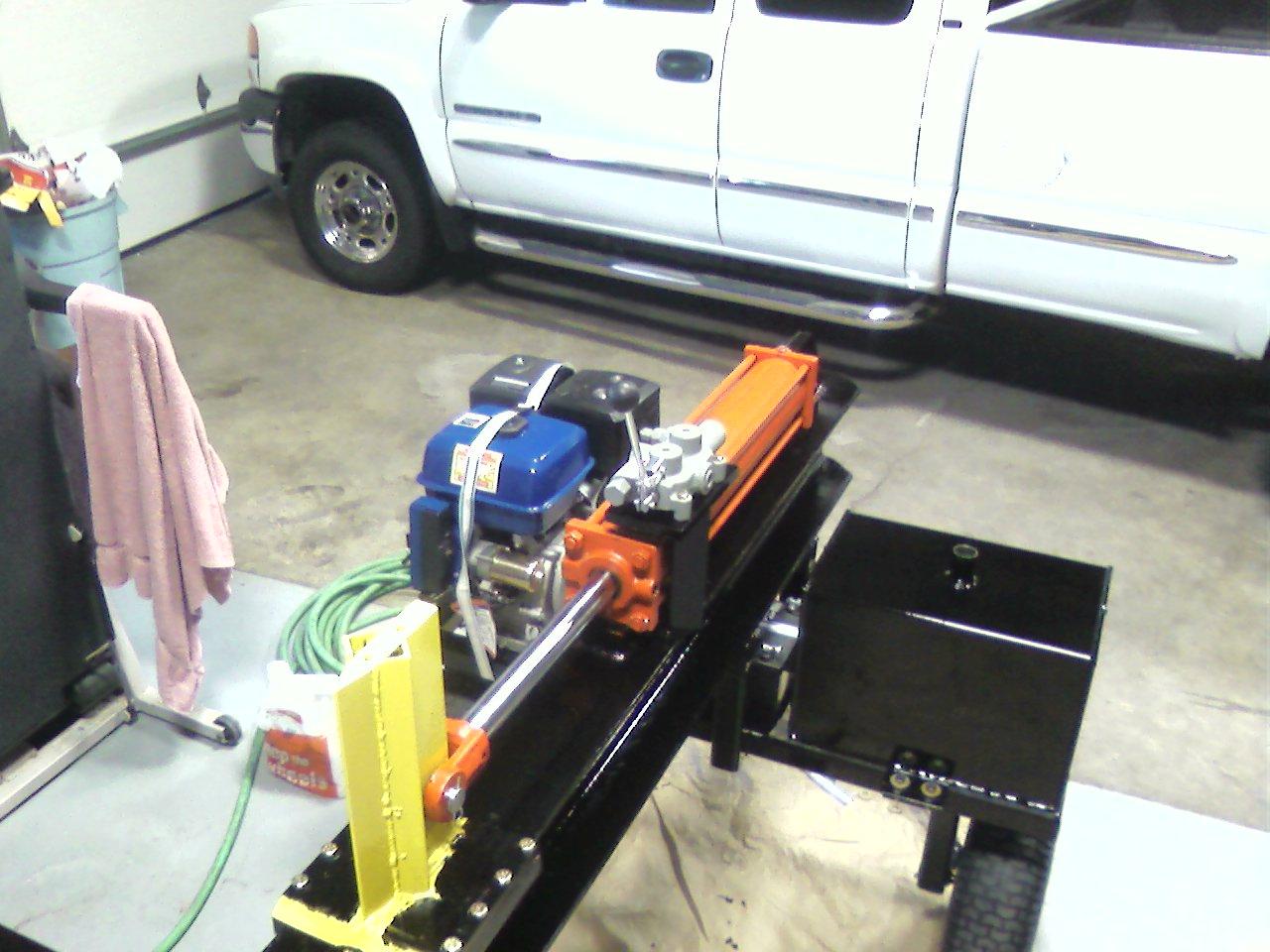

Here is mine I call her (Lickity Split). got the idea to make it after finding this site.
Thanks for all the great ideas and more projects to come:D:D:D:D

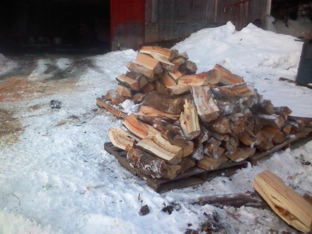

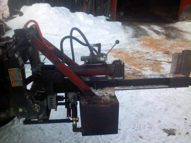

Some of you folks have most likely seen this one. I initially built it to run off the pto and it was ok. Now that it is self contained it really puts out the wood. It has about a 7 sec cycle rate and will shear just about anything. I still use the 3pt to move it and when handling large diameter wood it is good to have the stablization of the tractor hooked to it. If you notice the knife, it is in the fashion of a T. This way it splits two pieces off the bottom, leaving the main block in one piece to lower for the next push. Take a couple of pushes, rotate with the tongs and work it on down.

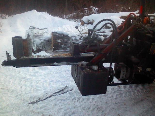

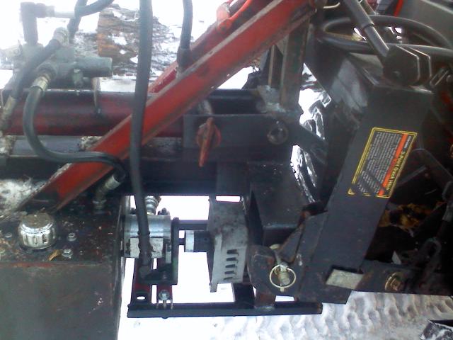

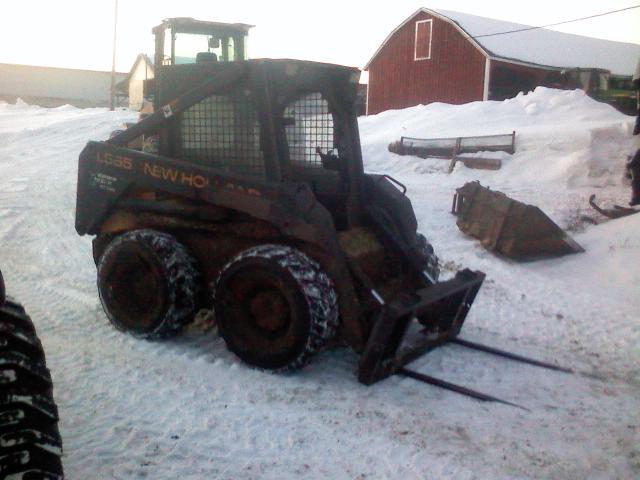

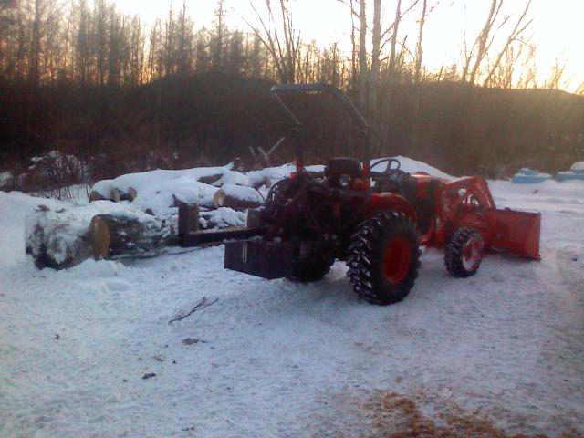

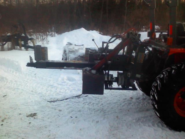

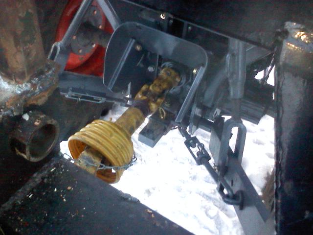

here a few pitures of the splitter that I have been creating. I purchased it as a stand alone home made unit and converted it over to three point hitch and ran it off of the hydraulic on my b7510. I was some what happy with it until I changed tractors. When I set up my b3200 with the power beyond It just never realy ran the splitter good. It was faster than the 7510 but had less power. I decided to build it to run off the pto. I used a gear box from a pto generator that no longer made power and adapted it to a hydrualic pump I had laying around. I used love joy couplers. I had to machine the one for the gear box on my chinese lathe to allow it to work on the tapperd shaft. I am much happier with this set up. I do not have a very big cyl. so I made it adjustable so I can split 16" or 24" wood. The one problem I do have is the pto shaft is real short and will come apart if I lower the splitter down so no loading big chunks down low. My last picture shows what I used to move the logs around with.
Rob
sorry if pics are not great I used my cell phone to take them.

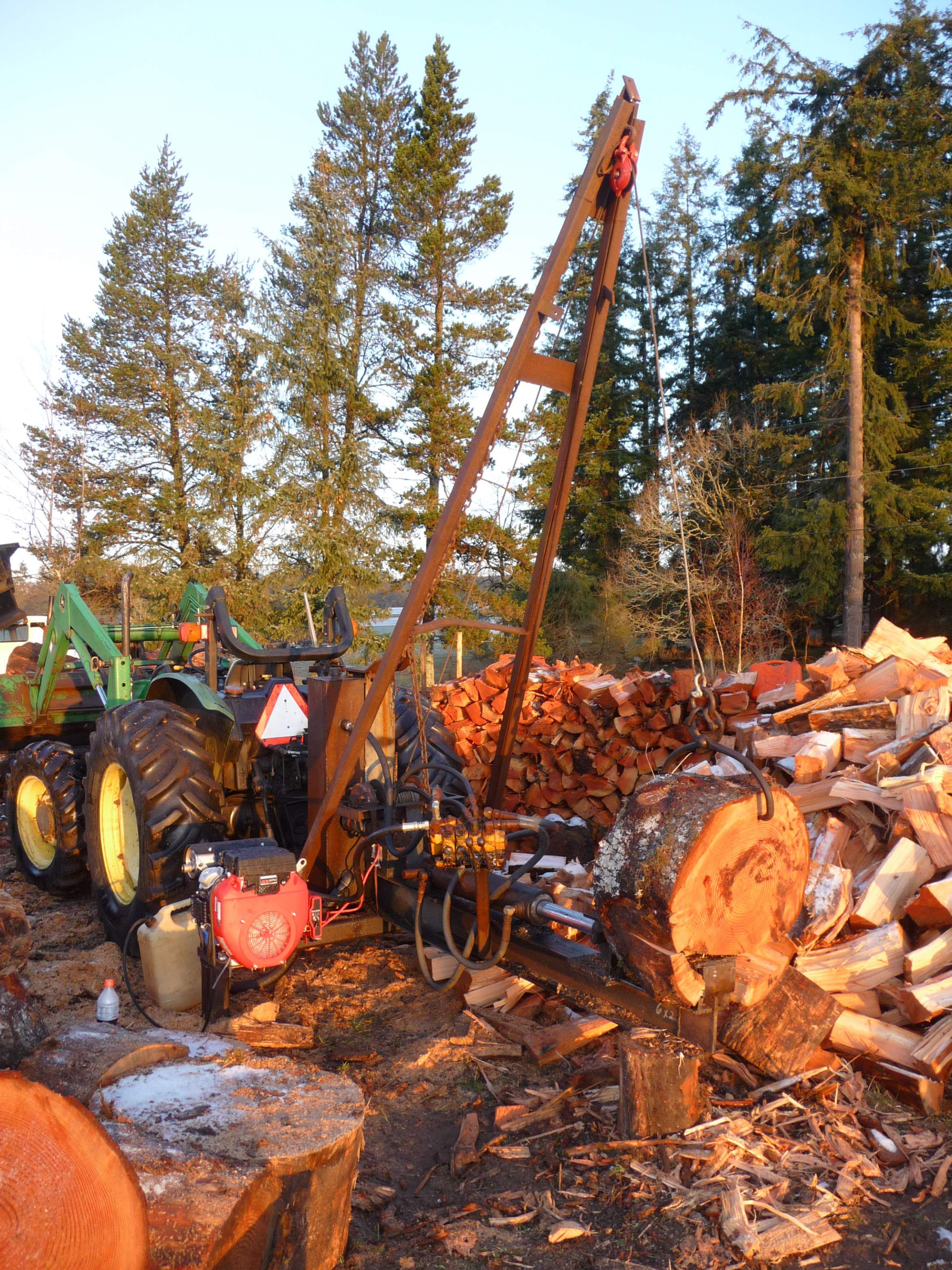

Hello all. I've been a long time lurker around other parts of this site and just ran across this thread, thought I'd share a few pics of my continuing splitter project.
Just after I got it together this fall. Still doesn't have the wedge adjust cylinder on yet.
Fetching a round too big to pick up out of the pile.
After a relaxing afternoon splitting last Saturday.
It's built on 12x12 W beam, 10 hp K series electric start Kohler, yes, it still has points, 22 gpm 2 stage pump, 5 x 30 cylinder, autocycle valve, hydraulic adjustable 4 way wedge, and an electric winch on the hoist with wireless remote. Still need to put a log lift on it. I'm hoping to incorperate it into a processor this summer.
