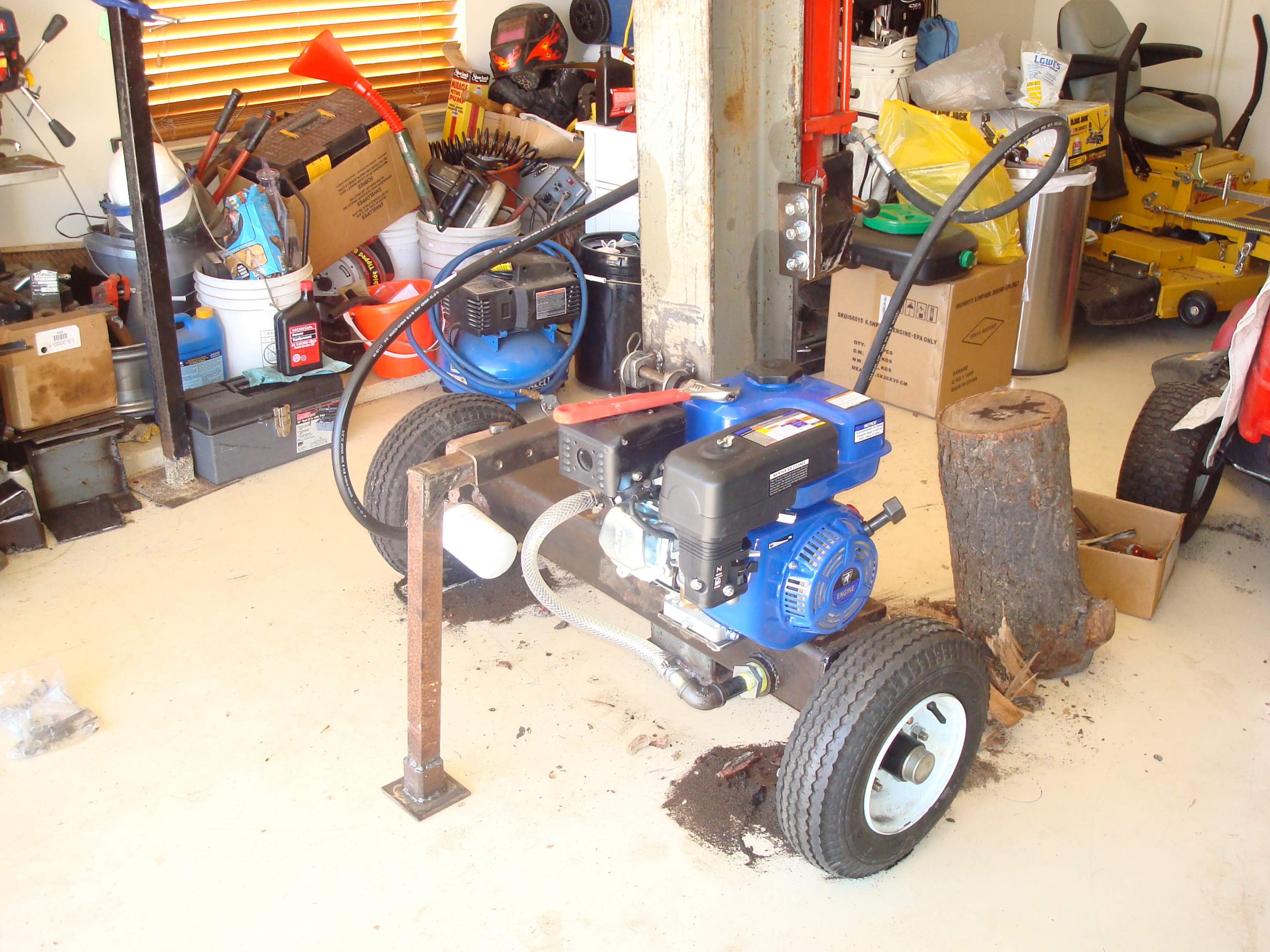

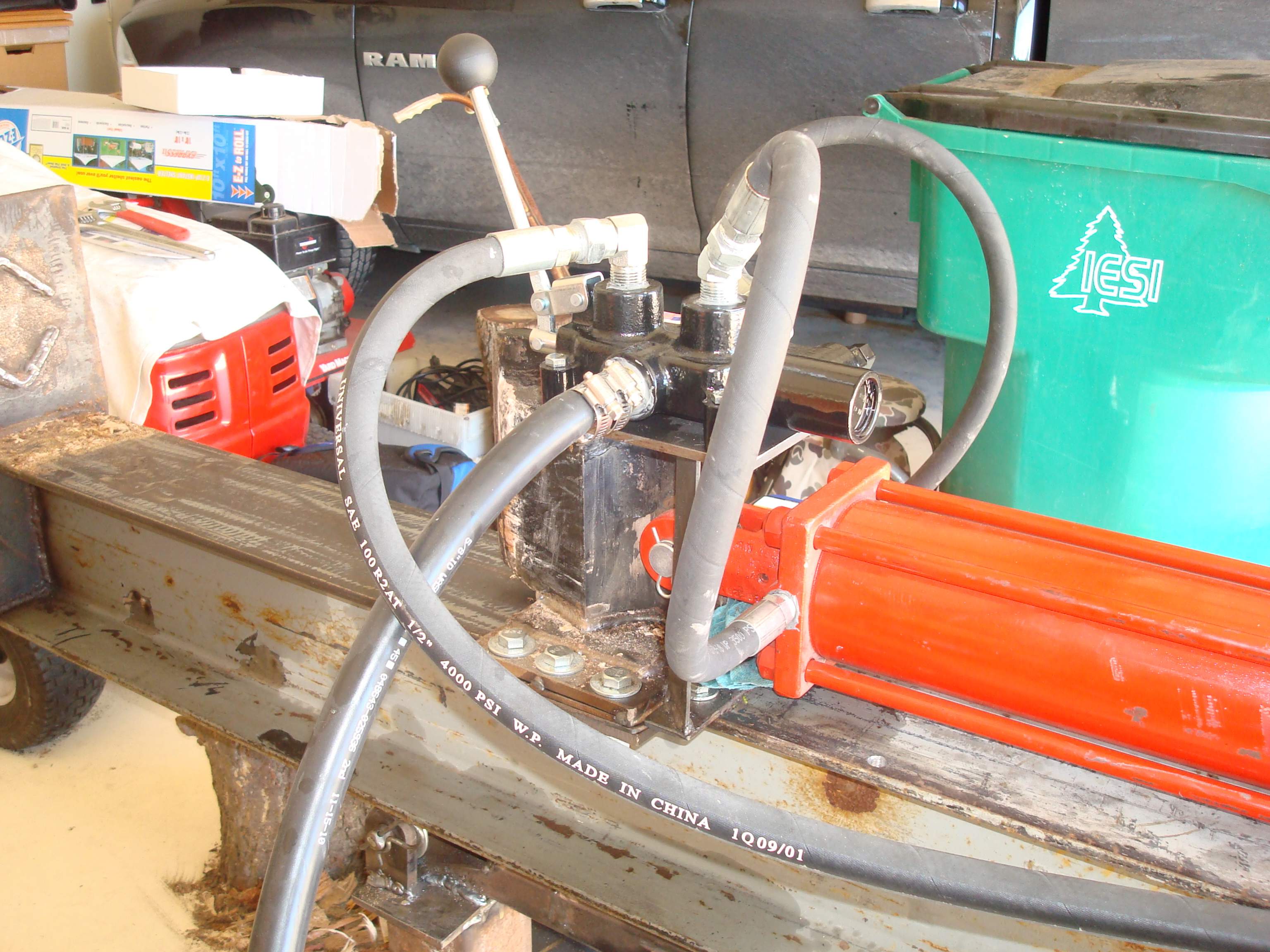

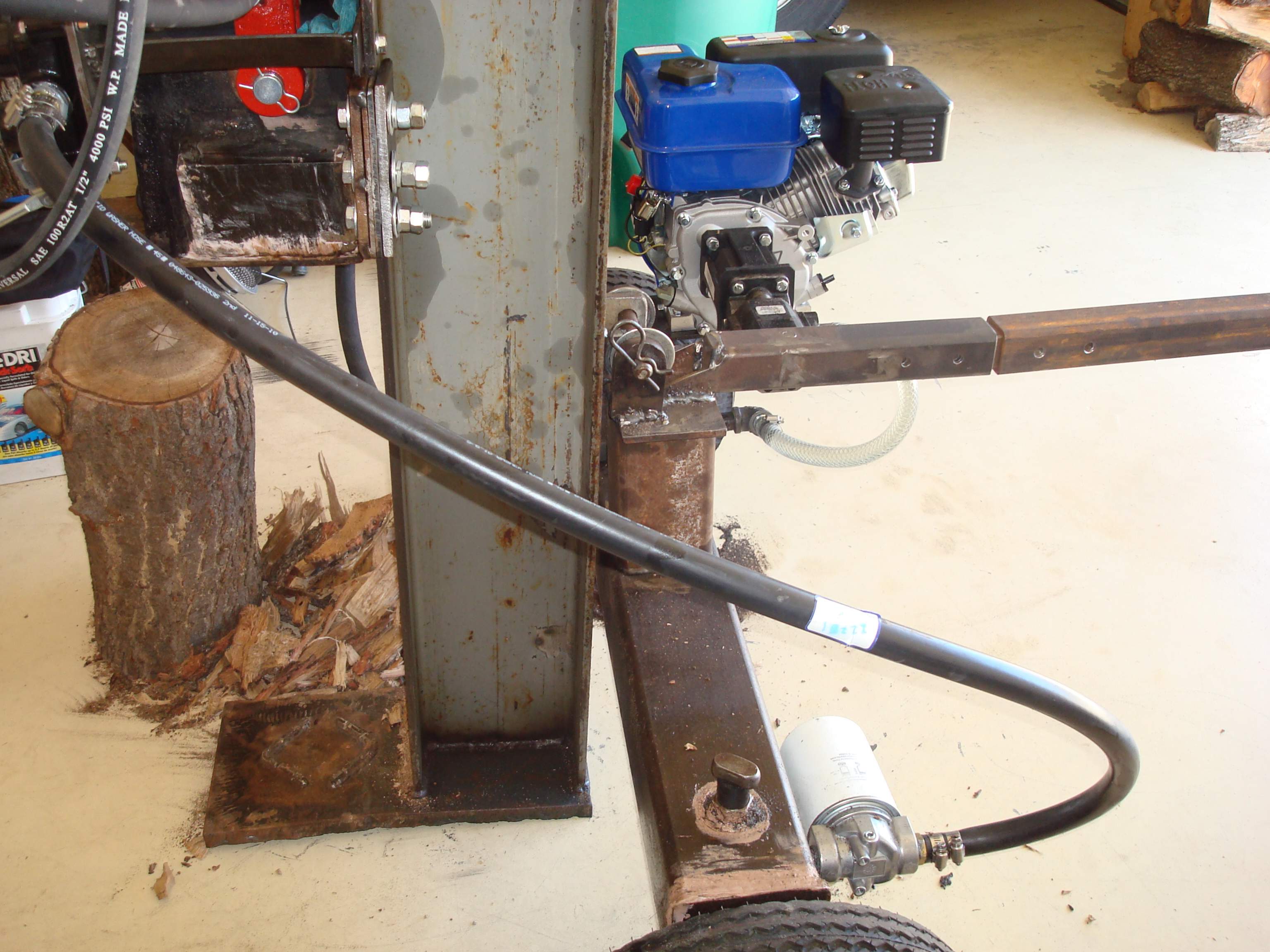

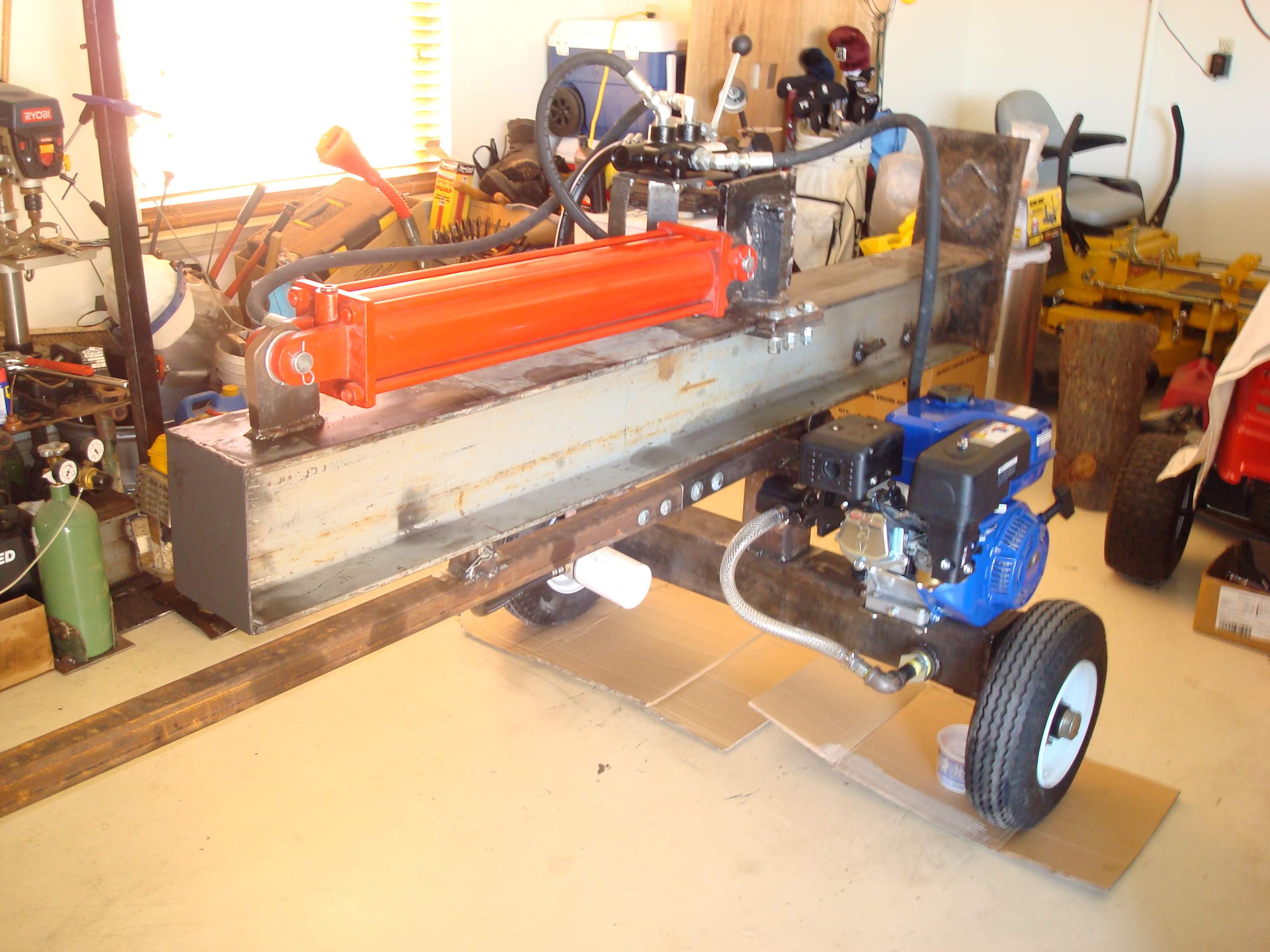

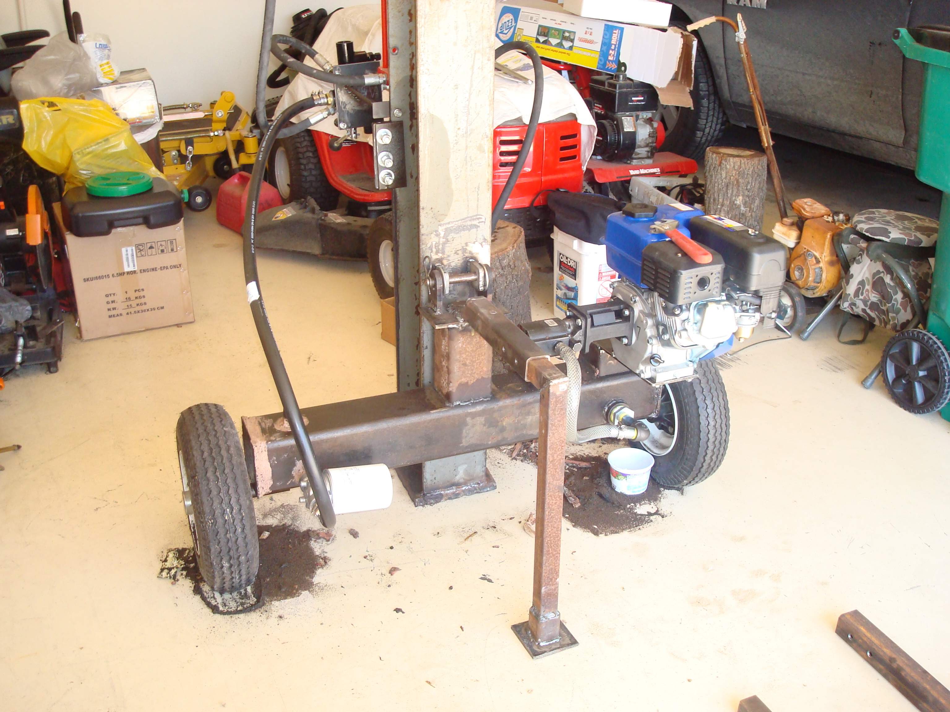

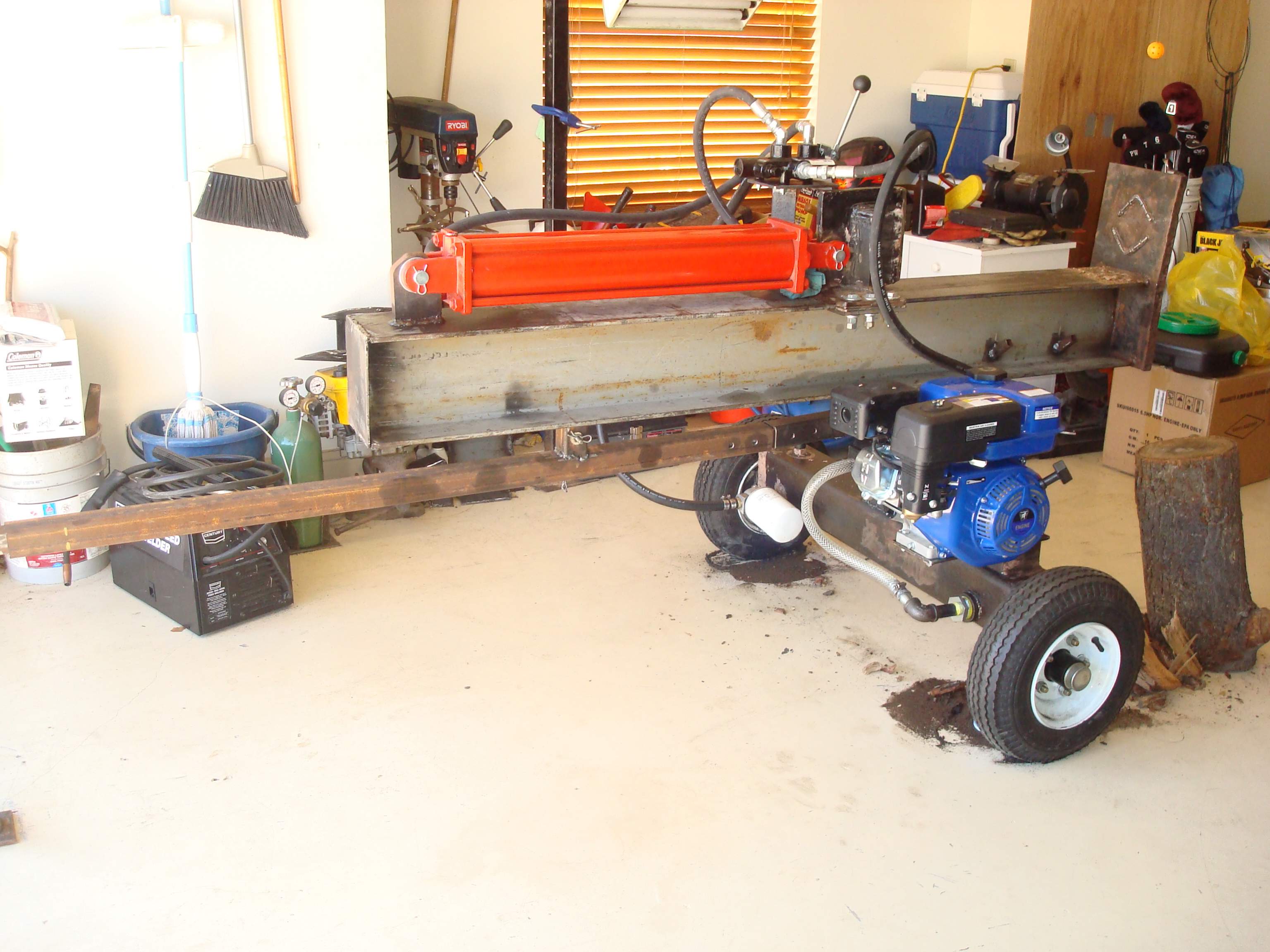

I'm a self-taught hobby welder and this is the first major fabrication project I've taken on. I worked strictly off of photos, memory and reading a lot of the fabrication threads here and elsewhere.
It still needs a good paint job and a few modifications/tweaks. My intent was to use as much recycled material as possible. The only purchased items are the valve, cylinder, hoses, wheels/tires, pump and eventually the engine. I had a scrapped 5.5 HP mower engine that I brought back to life but it had an accident while I was away from the project for a few weeks... Gas tank was cracked and engine was leaking oil... Who knows what happened?
The ram carrier/wedge are built from steel I found laying in the street several years ago! I stuck it in my garage and pulled it when I started the project.
I incorporated a lot of small items from my late father's tool chest (nuts, bolts, washers, pins) and used his wrenches and sockets. I had plenty of new stuff, and my own tools; I did it mainly as a tribute to him.
I had picked up this 6.5 chinese clone on sale at Harbor Freight a while bvack and still had it in the box, so I cut off the old engine mount and re-built it to accept the pump and hydraulics. It sat quite a bit higher, so I had to cut the 4x4 square tube down by about 5 inches so the pump would clear the I-beam. I'm running an 11gpm two-stage pump, Prince valve, Prince 4x24 cylinder. It cycles around 14 seconds; not blazing fast, but plenty of power. I don't have a ton of wood to split ,so I'm in no hurry. I enjoy running the machine and seeing the fruits of my labor (and frustration!) I can split up to 23 inch logs although I keep most of mine around 18-20. The blade stops just less than a 1/2 inch from the base plate, and the angle iron wings I put on the wedge do a pretty good job of splitting the logs by then.
I still have a pesky leak from the reservoir/axle where I must have had a pinhole when I welded the end caps on to the square tube. The base plate has developed a slight bend in it - it may be a bit "tall" for the knotty oak I've been splittin'... In any case, I can use it either horizontal/vertical and I made the tongue where I could remove it for storing the machine away in my garage and still have room for my daughter's car. I also built a removable table to handle the splits, but I had it off during the pics.
I have picked up quite a few tips and tricks from reading a lot of the posts and I plan to make a few changes to it after seeing some of the pics in this thread. It's been a lot of fun building this thing; now. I just need to track down some oak for next years logs!

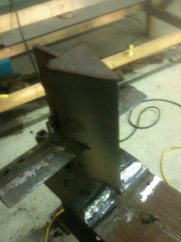

Here is my splitter under construction, big beam, adjustable wedge, log lift. I have a Honda 13 hp engine, 5 x 24 prince cylinder, 22 gpm pump, 25 gallon reservior. Need two more small cylinders, one for the lift and one for the wedge, need control valves, hoses, fittings and the know how to put it all together. No plans, just winging it [/IMG]

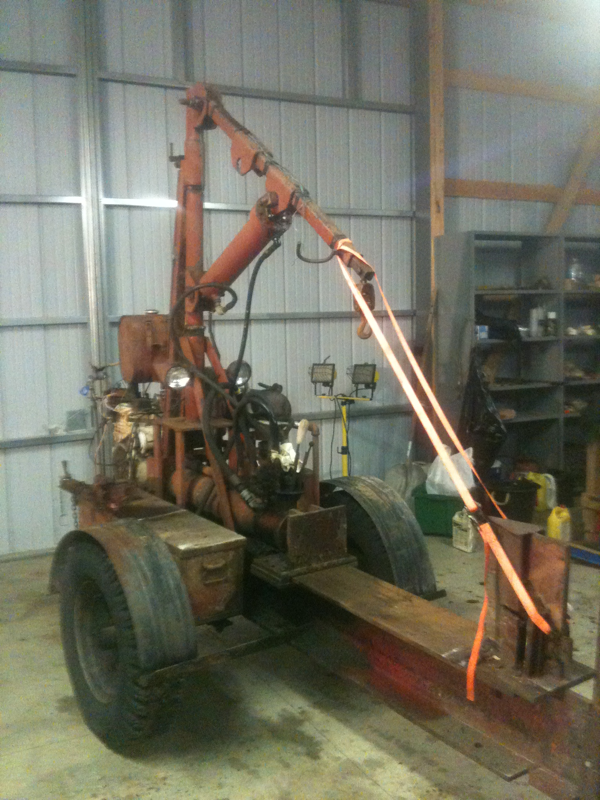

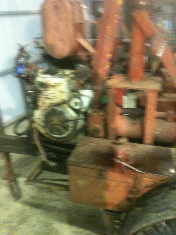

   / show your homemade splitter pics here #69
Nice splitters guys. Didn't build this one found it for sale for a great price. 16inch tall wedge with 6inch cyl. , log lift and an automotive A/C compressor added to fill an air tank. Definitely an older build with alot of scrap material used, but the builder put some thought into it and it works very well Please excuse the dirty weathered look and poor pics. Just got it and wanted to share.
