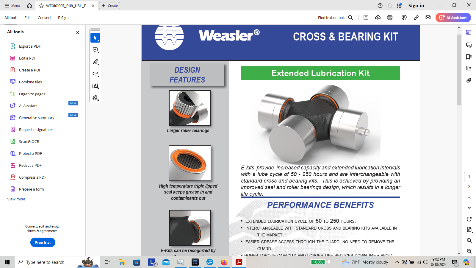

A few reasons;
1) they move through a greater angle of motion
2) they are built to a price point
As an example a Splicer 35 series u-joint is built in many price ranges and hp and lube requirement,
a 201-3500 is rated for 70 hp and a 50-250 hour lube cycle
a 200-3500 is only rated for 51 hp with a lube cycle of up to 8 hours,
they will physically fit the same u-joint and look very similar.
LouNY, that was an eye opening and educational response. I had no idea it could be that simple.
