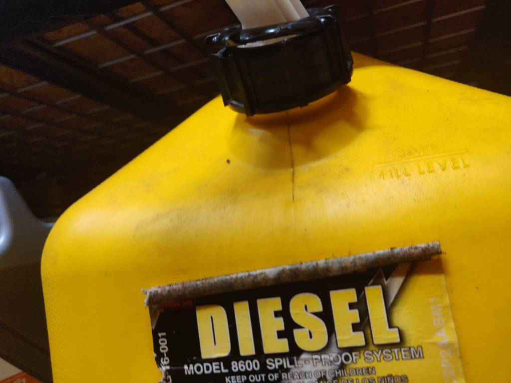

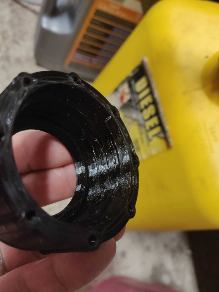

Not a tractor part, but most with a tractor probably have run into this. The new style fuel cans have super weak cap rings. One came broken, then a second one broke even after getting rid of the spring loaded junk that make them take forever to pour. Modeled in Freecad, printed with PETG on my Ender 3 pro, added holes around the edges so that I can add screws later if layer adhesion becomes an issue.
