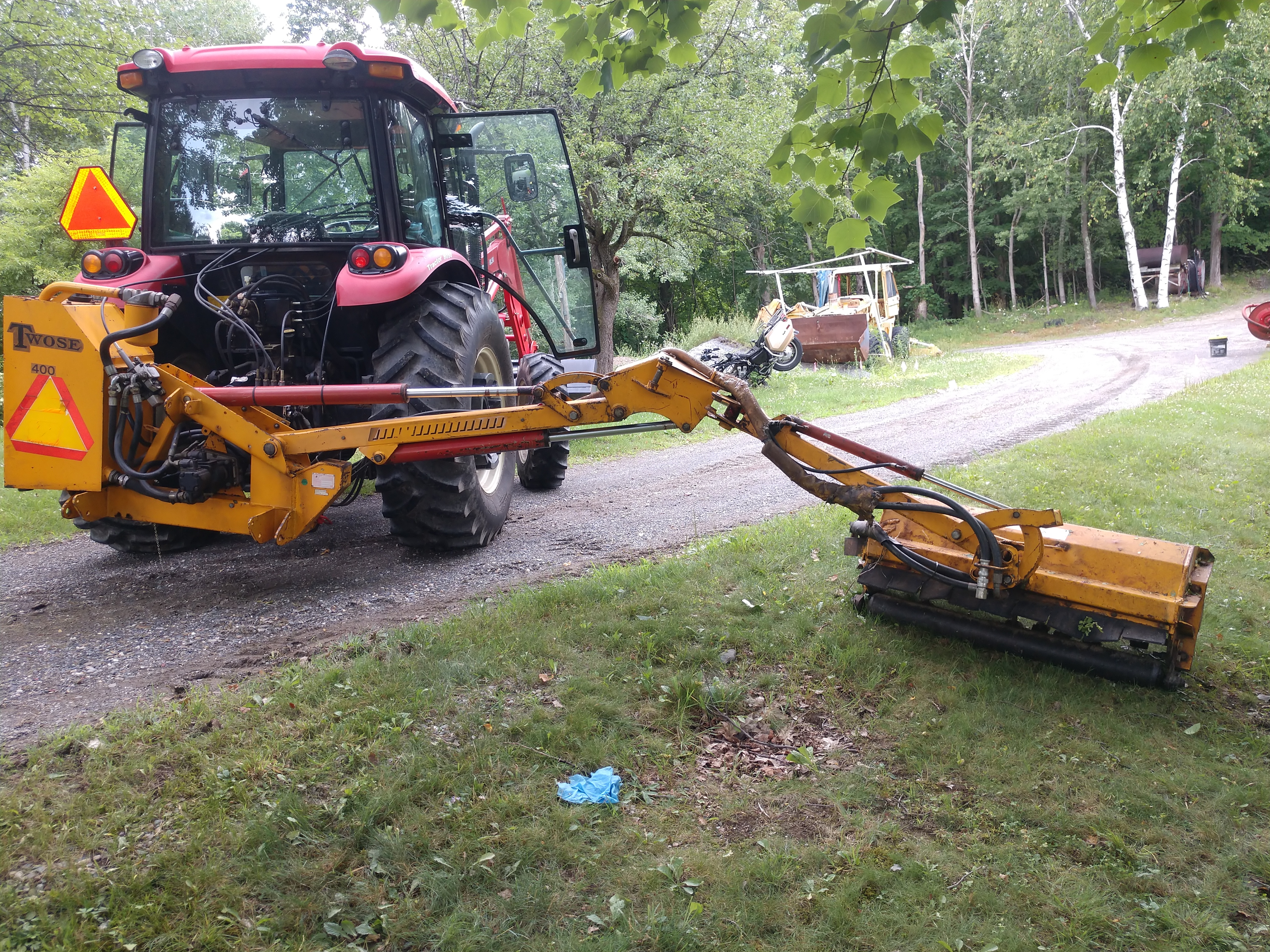

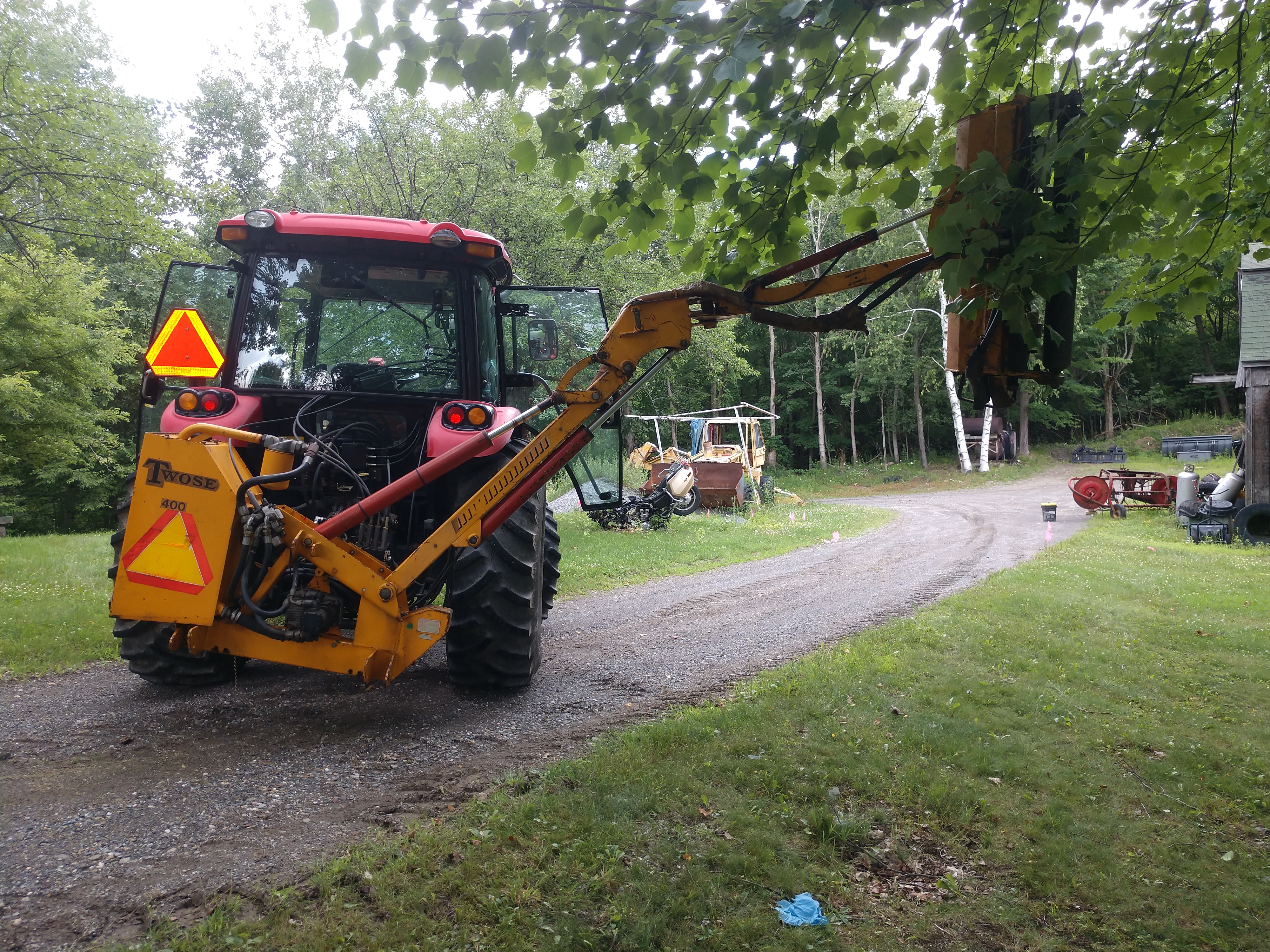

This is a flail;
you can get a lighter version with a sickle bar or heavier with a rotary type.

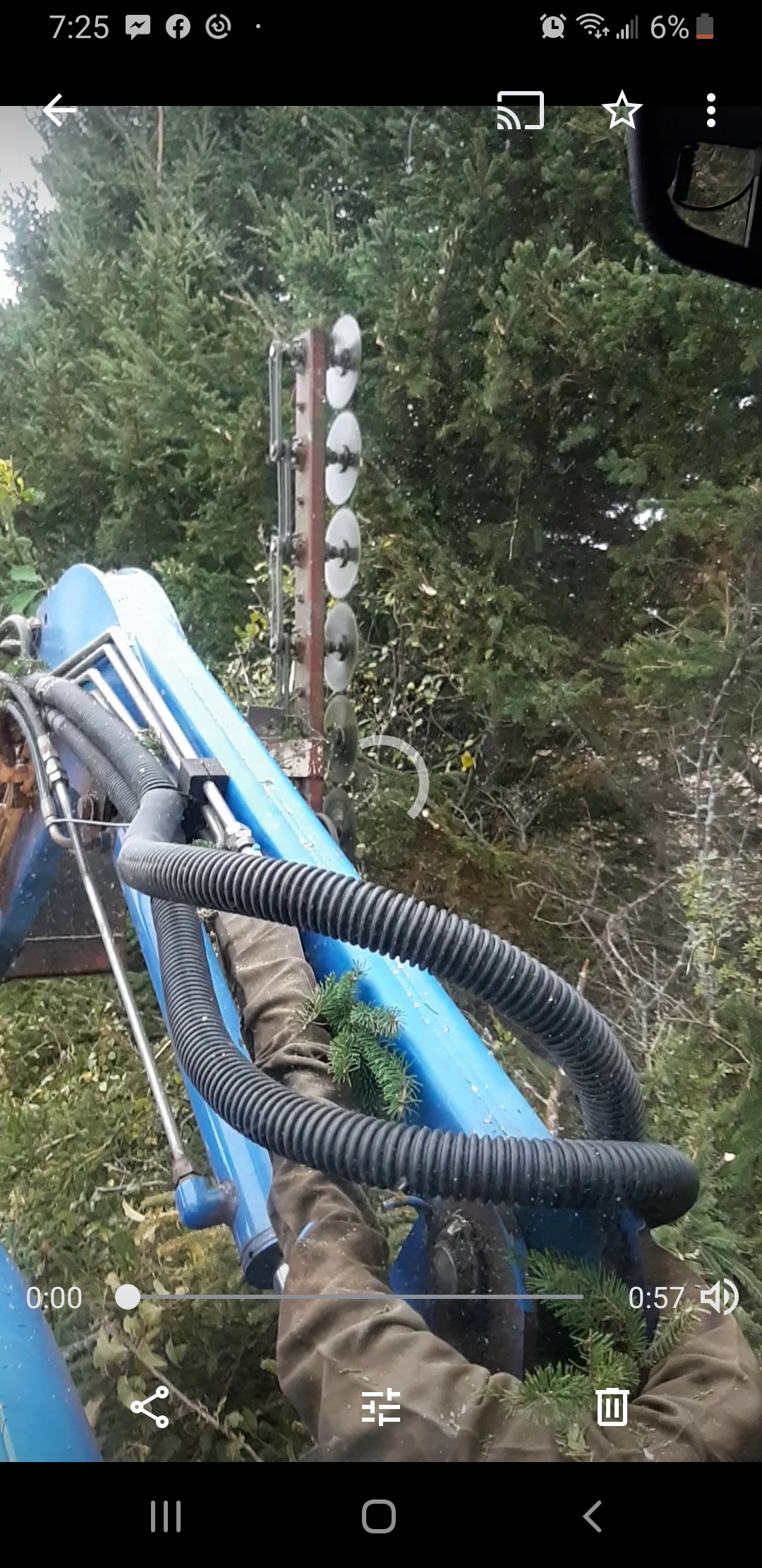

I built this a few years ago. Works great. Uses 10" saw blades. Hydraulic motor turns the first sprocket, then each shaft feeds the following one. Screenshot_20200812-192525_Photos.jpg

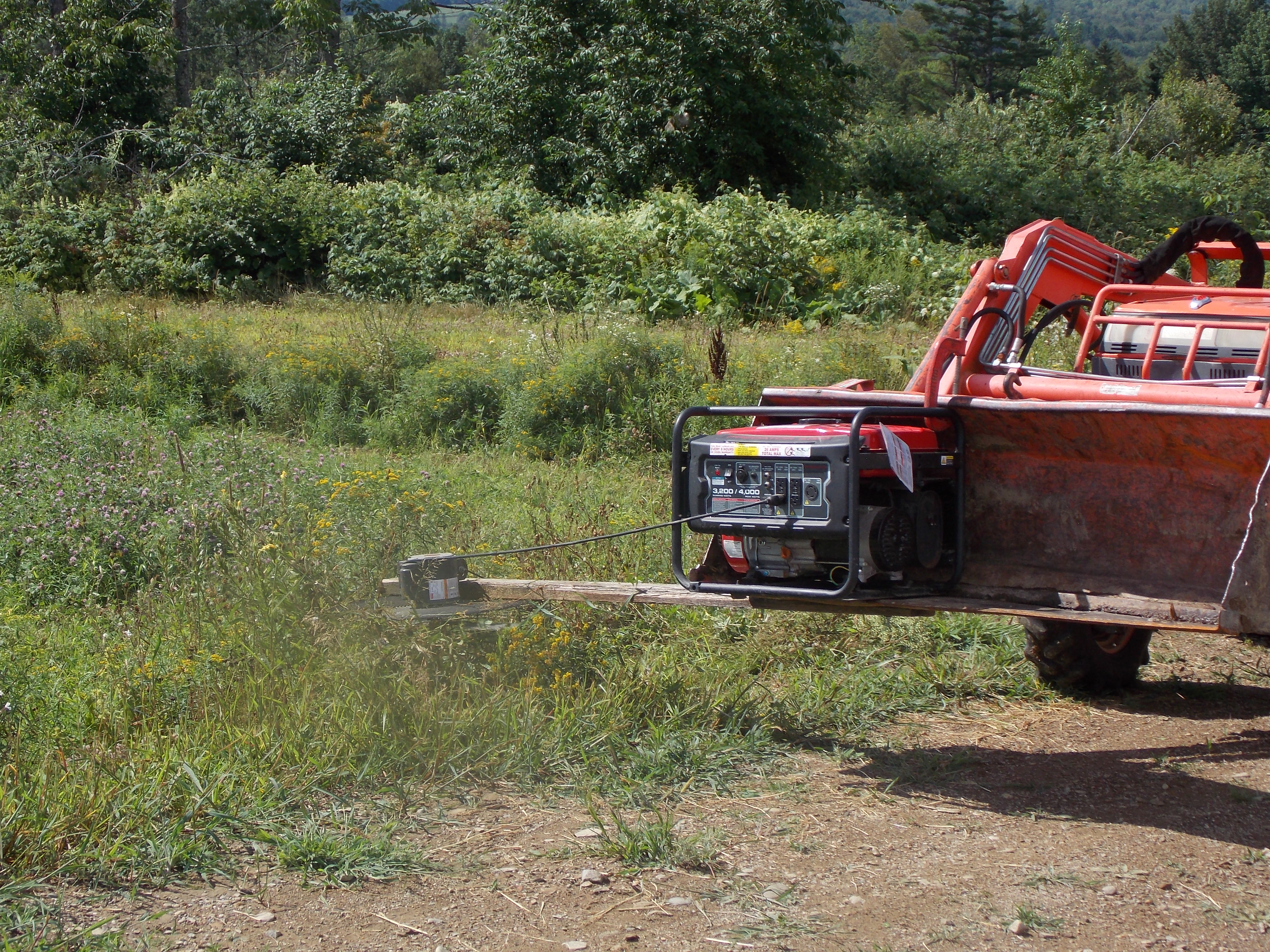

I built a homemade ditch mower for $0.00, but mine was electric and not hydraulic.
I was pretty much testing it to see if the concept would work, and it did.
If I was to build one, I would use a PTO generator, and an electric motor just to make things more simple.

That's GREAT. What are the large plastic tubes? Does stuff get caught in the chain?
I have a 3ph ditch bank mower/slasher, but anything out front would me vastly easier to use. Hard to watch where the tractor is going, what the mower is doing and operate ten controls all at once, with an out back mower.
