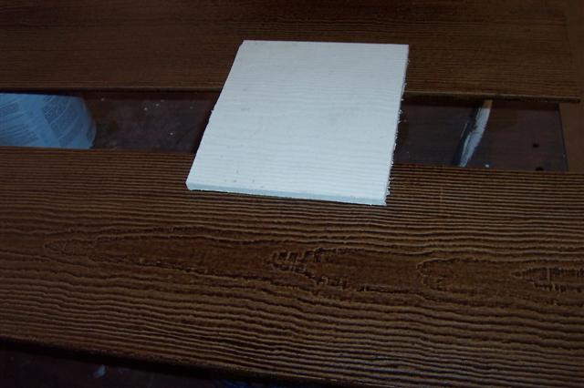

It's cold and windy outside today and I'm not enjoying being outside at all. I added more corn to my deer feeder and fed my ducks, but that was about all I wanted to deal with.
So I played around in my shop with the sign. It's just about done, I'm just waiting on the paint to dry before attaching the letters and the fish.
The first pictures show's the James Hardi siding that I'm using for the sign. It's a cement fiber material used for siding on homes with a nice clear wood grain stamped into it. I stain it with Minwax Gel Stain. It's not like wood stains, it's more like Jello that you brush on like paint. I goes on uneven, which gives it that natural wood look. I've had quite a few people look at it who know wood and can't figure out what type of wood that it is. I've never had anybody recognized it for James Hardi siding. The lighter colored square in the picture is a piece of scrap that I put on the stained pieces to show the difference.
I was looking for a bluegill and found this one on Ebay. It's fancier then I was originally looking for, but that's a good thing, because I made the frame nicer because of the fish. The seller makes them by hand and his wife paints them. It's a one of a kind that's 18 inches long.
The Hardi is attached to the frame with self tapping screws that are left over from my metal roof. I then painted them brown to blend in with the stain. The cattails are layered in paint to give them a small amount of realism. I'm still not sure about the tips, but I'm leaning towards making them darker with some black paint.
The pole is a light pole that's part of the fence surrounding the pond and a 4 acre pasture. I drilled and tapped the holes for 3/8's bolts. There will be three bolts holding it onto the pole.
