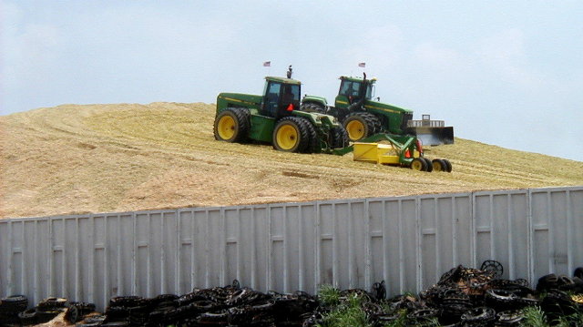

This silo is owned by a consortium of 6 dairies; the largest of which is milking 6,000 cows. They also own 3 more silos like this one, but this is the biggest one. And yes, that's 9000 series John Deeres spreading, smoothing, and packing the silage - 4 of them. I didn't ask why some have a blade on the front, some on the rear, and some on both ends.

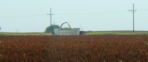

The corn is being harvested by 6000 series John Deere forage harvesters; don't know how many since I only saw two, and I didn't want to get in the way, so I was a long ways off when I made this picture that doesn't even show the harvester. All you can is one of the trucks driving alongside it to receive the silage. And in the foreground is milo; the corn field was farther back from the road.
The guy told me that, this year at least, the farmers could make 10% to 15% more money per acre selling the corn green as silage than they could get selling shelled corn later in the year.

Well those are just a tad bigger than the ones on our dairy 40'x100' and 30'x100' I would think they would have to have move than two harvesters going to keep that many trucks busy and 4 tractors busy packing.

Yeah, Spencer, I'm sure they had more than two harvesters running, and I don't even know how many trucks. They had trucks coming and going from the south and they had them coming and going from the east, so I just followed one of the empty trucks east 5 or 6 miles, saw where he went, and could see two of the harvesters from there. I don't know how far the ones coming from the south were traveling; just know they went a few miles south down the highway, then turned east, but I didn't follow any of them.
I think the thing that fascinated me most was seeing those big articulated tractors up on top of that mound. I knew the silage was packed pretty tight, but for those tractors to not sink in at all . . . and that's a lot of weight.
