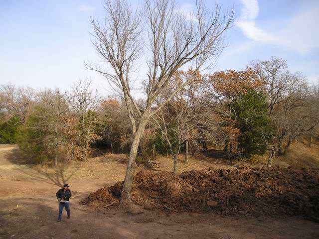

Here's a picture of about 10 yd of dryed silt pushed up into a pile from cleaning the pond sides. I haul this off and build terraces out of it. If I line the terraces with rock, hopefully the silt won't end up back in the pond the first time it rains. /forums/images/graemlins/tongue.gif /forums/images/graemlins/smirk.gif

99% of the water will come down the chute on the left side. I'm going to shape the sides into more of a "V" and cover the bottom with rock. On the right side, I plan to collect the water that runs off the hillside and let it drop over a small rock waterfall.
)</font>
Jim,
From what I've read and personally experienced, most of your silt will enter your pond the first season it rains. After that, the vegitation will grow back and the level of silt will decrease dramataclly.
This is a concern I have with my lake I'm building, and it happened with the two other ponds I dug.
One of the ponds are on the land I sold with the container barn. The new owner brought in a crew to create some pastureland for cattle. They also noticed the silt starting to build up in the pond.
First they dug the silt out with a trackhoe, then they dug a pit before the pond along the main route the water traveled before entering the pond. It was sort of like your situation. The water travels to a funnle type area, then int to pond.
The pit they dug caught the water and allowed a large amount of silt to settle in the pit, then the water would enter the pond in much cleaner state.
We've only had a few rains since he bought the land, but he's had to clean out the pit each time due to the amount of silt he's cought in the pit. Anything that stays in the pit is somehting that wont go into the pond.
I'm gonna try somehting like that on my lake, but allot longer to see if it helps. I'm also going to dig a few pits on the bottom of the lake along the shoreline to catch the silt from the first few seasons of rain.
Thanks for all the updates and pics. Sure looks like it's gonna be a real nice pond when your done with it!!!
Eddie

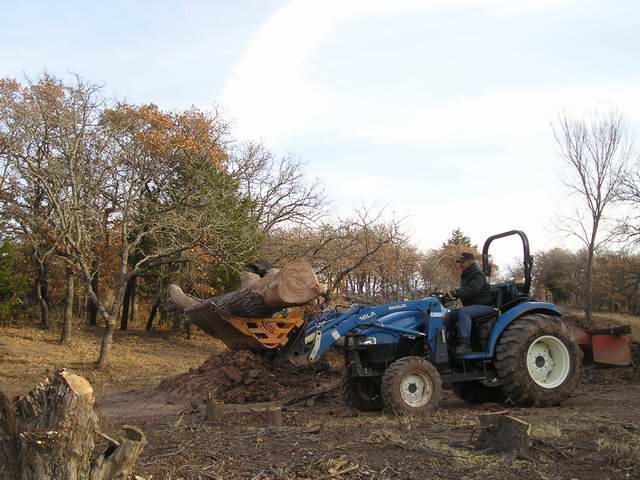

R/C tractors /forums/images/graemlins/grin.gif There are a couple guys who take 1/16 Ertl tractors and turn them into R/C models. Here is One of them
And another
In Action
Also, Ertl has made some before and just recently released a 1/10 scale John Deere 9520 and 9620. It is a monstor of a RC. I attached a pic of it

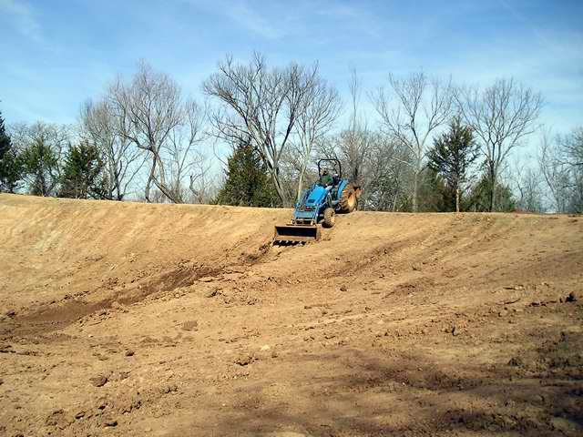

I guess it's time for an update on my project. I've been snatching every chance I can to work on the pond and have divided my time about equally between smoothing out silt and digging down the sides of the pond where the dozer didn't get before he had to go to another job. The silt pile has been brutal. On top it is dry and dusty, but underneath it is still pudge. I've been leveling off with my tractor, but some of the silt "boulders" are 3' in diameter and as soon as you cut into them they are just pudding in the middle. I've had to push myself out of so many stuck spots using the bucket that I'm a virtual expert, it's second nature. One of these days I'll get stuck when I don't have the loader on and I won't know what to do. /forums/images/graemlins/crazy.gif /forums/images/graemlins/laugh.gif
This week, I took two vacation days to try and get more work done in the pond and take care of about 1/2 days worth of business (getting my new bride her military dependent ID card). Thursday was a perfect day for working in the pond and Kathy came down to take some pictures of me getting "down and dirty." /forums/images/graemlins/smile.gif
This first picture shows how I use a trench to cut down through the silt. By making a trench with my bucket, it stabilizes my tractor on the downslope so it doesn't tend to crab sideways as the rear wheels spin, pushing the bucket into the silt. As you can see, the bank is quite steep and the silt is still very deep when I started. I've worked my way all around the dam doing this same routine and moved hundreds of yards of this red gummy-clay silt. Many times I've had to stop and use a shovel to clean out my bucket because the silt just refused to come out. /forums/images/graemlins/tongue.gif

Here I go... into the trench. Once you commit, there is no turning back. /forums/images/graemlins/shocked.gif
