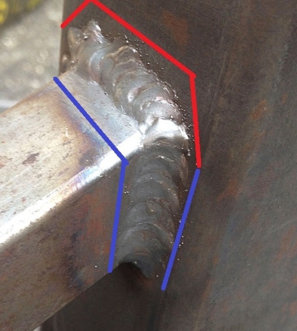

Overall I think the solution is a good one - bet the designers didn't think about the exhaust.
The weld in question, while not likely to break in this specific case, has some problems. (Double blue line border)
Definition: "Insufficient throat usually occurs in fillet weld and butt joint profiles that are concave. Excess concavity reduces throat thickness, which considerably reduces weld strength."
It is a very bad type of error that, in some cases, can cause a crack while cooling, or just break suddenly when a load is applied.
Like I said, with welds on four sides in this case it will likely not be an issue - but defending the weld does not make sense to me either.
Could just be a camera optical illusion - in that case, my appologies.
NO! As usual Dave you nailed it!;)

Welding 101.... Lesson #5, #6 and #7.
1. A larger/wider weld does not give more strength. It gives an over estimation of strength. 2. Fillet weld leg length only needs to be the size of the thinner material to achieve maximum strength. This of course is based on a flat or slightly convex fillet and not a concave fillet. Too convex causes a notch effect at the toe. Too concave doesn't provide proper reinforcement and can fail as mentioned already. 3. A properly done weld should break in the weld, not the heat affected zone or the toe of the weld. Fillet weld break tests will confirm a proper welding technique.
General life lesson #1.
Don't tick off the craftsmen with years of experience that are willing to share it. :duh: They'll go away and people wanting advice will have to rely on wannabe's that can only wish they had the experience. ;)
