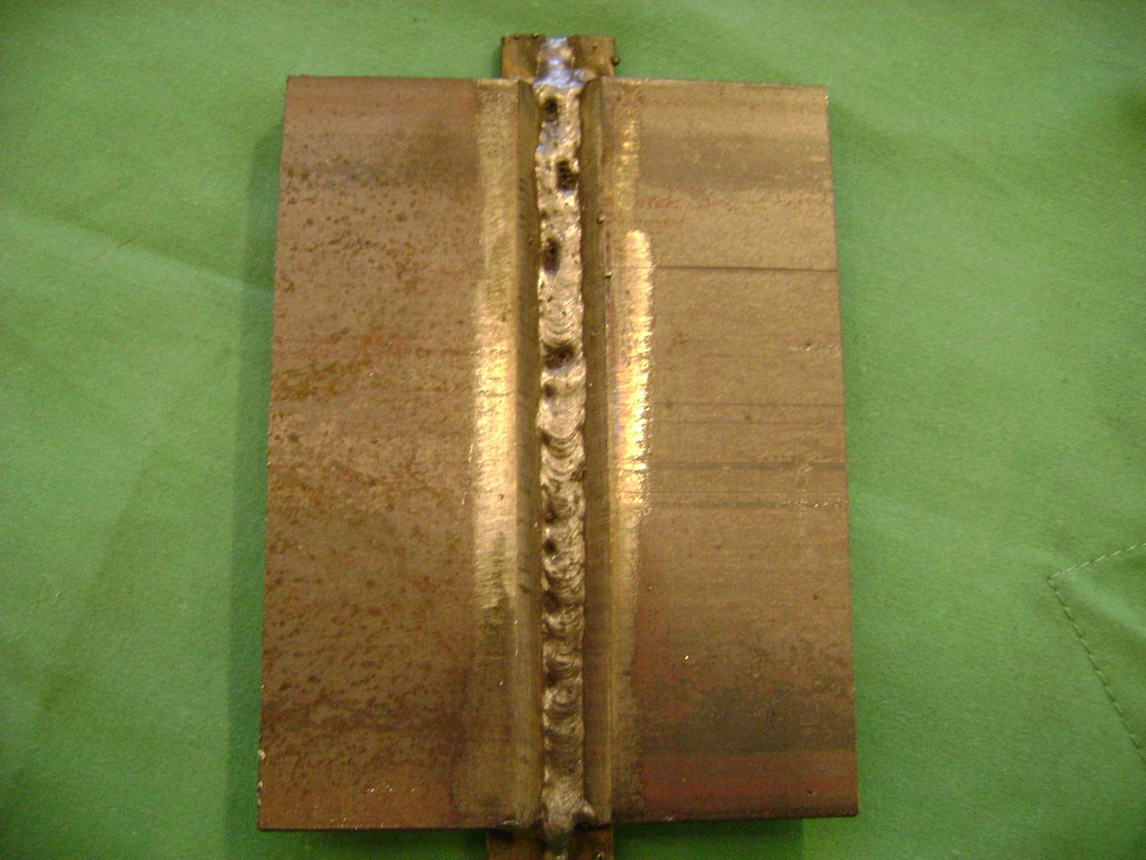

Ken would you rather me lie to you guys, and say the welds are perfect? Or be honest with you guys? I can blow sunshine all over you guys, if that's what you want:confused3:! But is that going to help?
I've yet to meet a weldor who hasn't made a bad weld. Here is one of mine. It's all me:eek:! I can't blame the welding machine one bit.;)

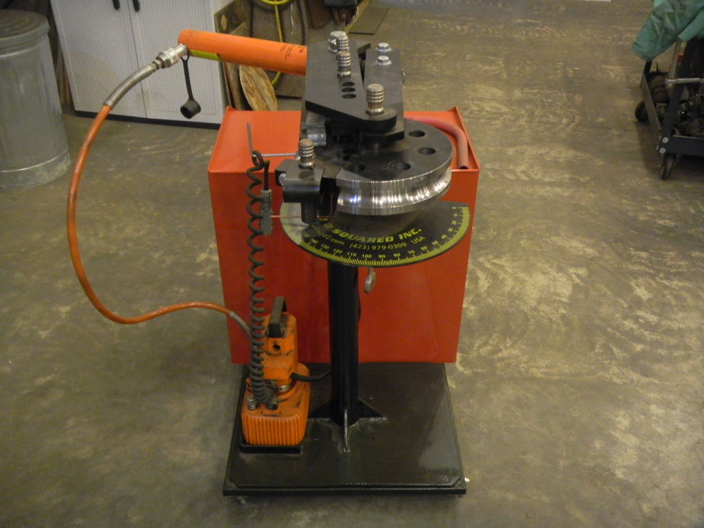

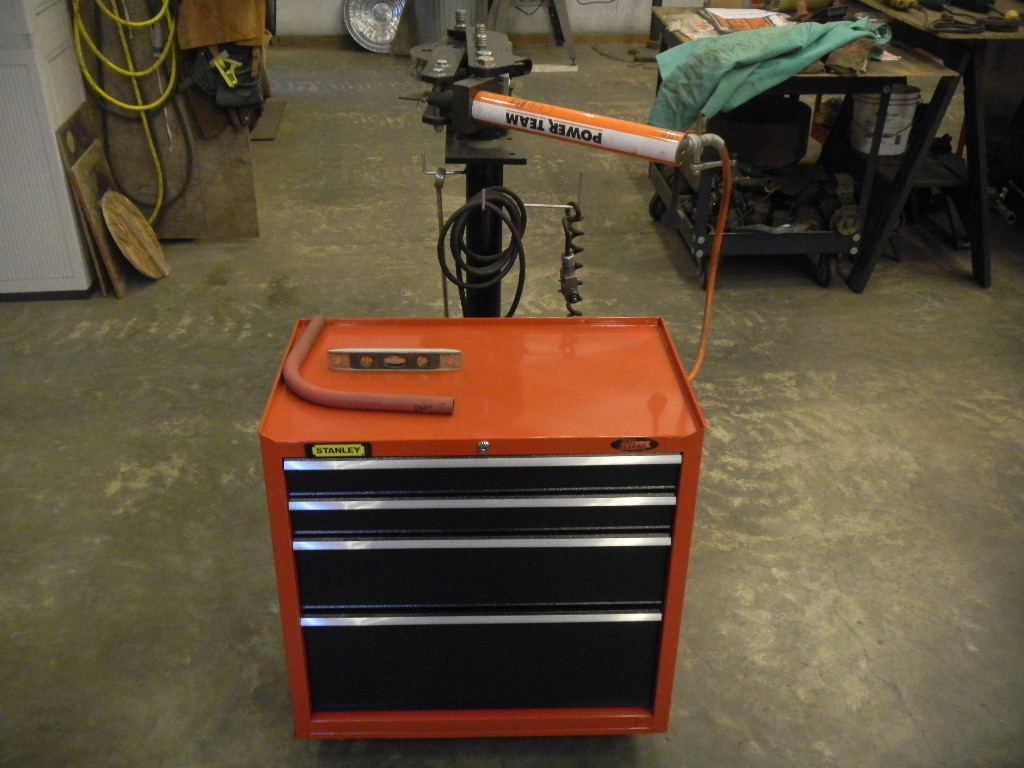

Have you had any trouble with it?
No I haven't. But I've not used it a whole lot. I got a really good deal off Craigs list. Then bought the hydraulic kit for it. I already had a 120-volt power pump that I use with it.

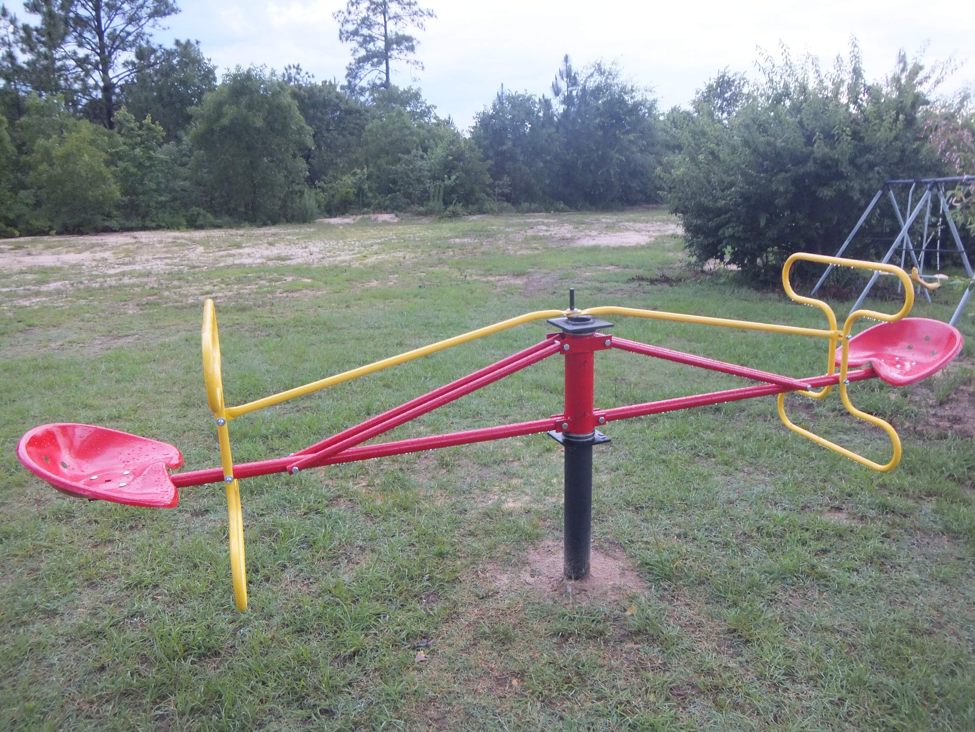

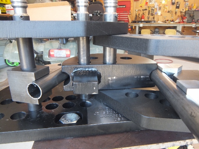

To cover by bases, this ride on playground equipment was welded with a 220v mig welder, however, I would not have hesitated to use my Hobart 120v welder if that was all I had. I don't have any good pics of the bender on my computer, however, this one was sent to jd2 to show the problems with there die set. I paid for a 180 degree die set, does it look like 180 to you? Any way, after having a machine shop make the proper parts for me, I was able to make the handles for the ride on toy for my son. I played on one of these when I was a kid, we never had any money, so it belonged to someone who live in our neighborhood. I wanted my son to have one, so I built it myself.
No it doesn't!:shocked: Your die is different than mine:confused:. My keeper looks like it has a better fit to control the tail of the pipe.
You did a fantastic job on the playground equipment!:thumbsup::cool2:

On the mode 3 and 32, the forming die rotates to bend the pipe. On the model 4, the forming die is stationary and a following die is used to bend the pipe to the forming die. In the pic, the block on the left side is called the u-block, notice how much of the forming die is missed because it is too short? The response from jd2 was less than stellar, basically no help at all. At some time in the future I plan on doing a video on utube to show the pros and cons of this bender. There was no such material available online at the time I purchased mine. One thing I would add, if anyone is thinking about getting a electric hydraulic pump to use in this application, make sure it has a brake on the electric motor, this will help prevent overshoots when bending.

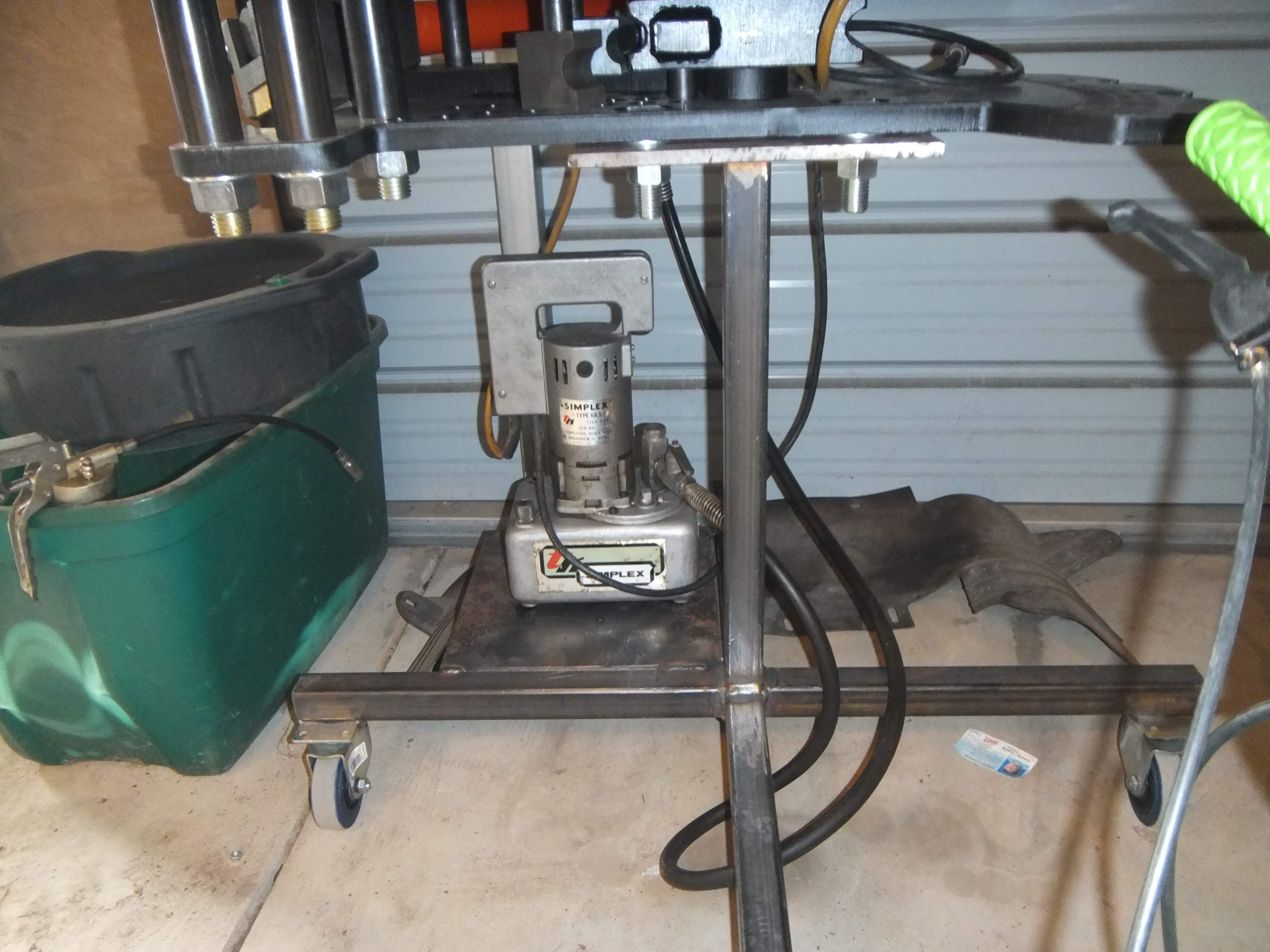

Here is a poor pic on the bender with the stand I made for it. This should be the poster child for a new thread on proper heat management to prevent deformation. I had to shim the wheels when I welded them on the account for my over zealousness to "get her done"
