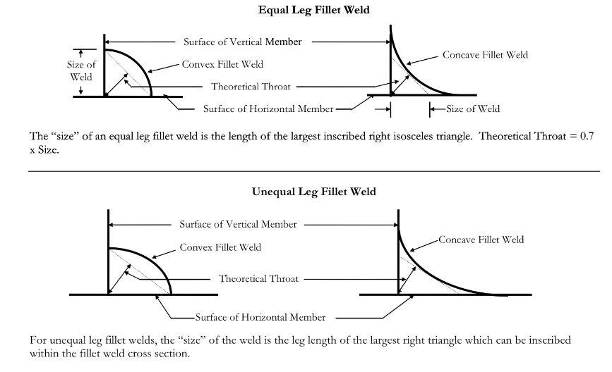

Welding 101.... Lesson #5, #6 and #7.
1. A larger/wider weld does not give more strength. It gives an over estimation of strength. 2. Fillet weld leg length only needs to be the size of the thinner material to achieve maximum strength. This of course is based on a flat or slightly convex fillet and not a concave fillet. Too convex causes a notch effect at the toe. Too concave doesn't provide proper reinforcement and can fail as mentioned already. 3. A properly done weld should break in the weld, not the heat affected zone or the toe of the weld. Fillet weld break tests will confirm a proper welding technique.

I wanna hear more about this, preferably with pics, so I can better assess my welds.
I'll leave the rest of the stuff alone....
Thanks!

Overwelding can be bad for a number of reasons. On most things the object flexes some . You overweld a joint and you now you eliminate a flex point and something has to give. Overweld is actually a weld defect. If I remember it I will post a weld defect sheet from my college class tonight.
Vertical up produces the most penetration because heat rises and preheats the base metal, down the opposite. Down will produce a flatter bead and is better for thinner material.
Thanks!
Here is a decent pic of what is being discussed.
Notice in the concave weld, the actual area that is considered to be a weld is smaller than it looks.
If the legs were supposed to be 1/4" long, and the weld is convex - the actual leg length, and throat, are smaller than required.
In the convex weld, the material past the throat is wasted weld metal and can cause a notching effect at the toe lines.
The "Arcs" should feel free to critique, or add to my description :)
Does that help?
A decent set of pics with some discussion: Fillet welded joints - a review of the practicalities - Job knowledge 66
And here: Design - part 1 - Job knowledge 90
Design part 2 - Job knowledge 91

Dave, your pic didn't come across. Thanks for the links, I'll take a look at them later!
Another question: where does one get one of those neat looking welding doo-hickeys that Arc shows in some of his pics? The "Made In USA" one?
Thanks,
That's weird, it was there before - here is another look at it:
