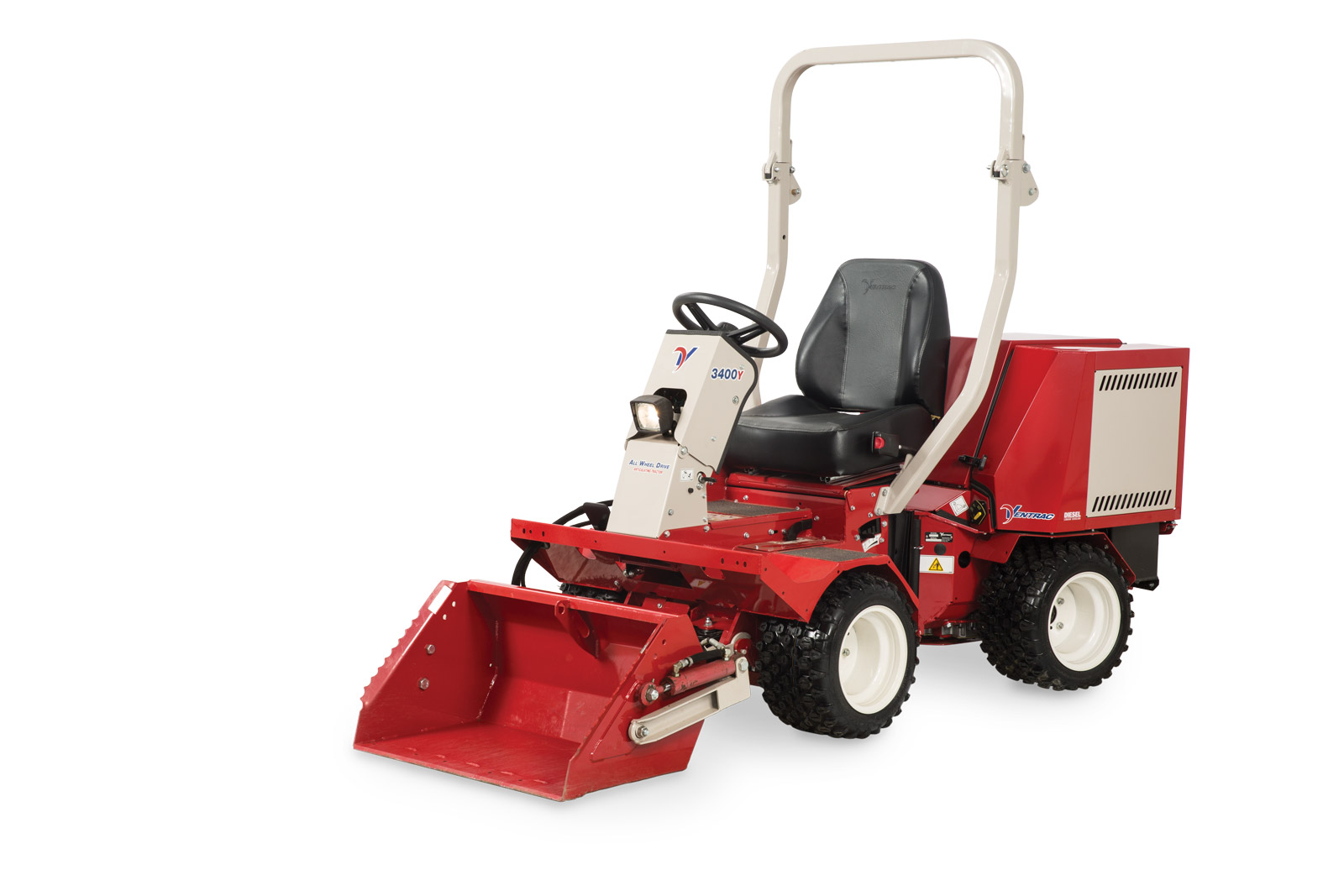

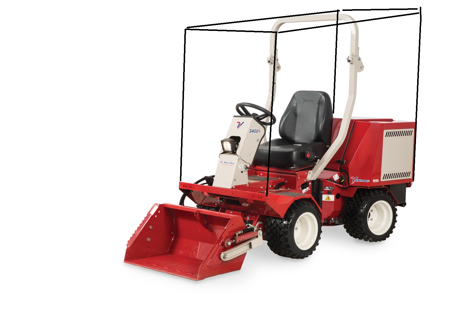

Like lots of other people, I want a cheap, simple to build "cab" on my Ventrac 3400 for blowing snow. (Snow blower mounts to the front of the tractor.) This is only for homeowner use so 30 minutes to an hour is usually the longest I would be outside but I hate the wind and don't like snow being blown on me.
The main thing is that I want to keep the wind and snow off of me so I'm thinking I will only have a front, sides and possibly a roof. I will not put any type of heat inside but I don't want the glass, lexan, or plastic to fog up. If I leave the back open, will this keep the inside cold enough so it does not fog up?

I have a soft cab that is reasonably sealed all around with no heat and never have fogging unless I'm breathing a few inches from the windows. You shouldn't have a problem.

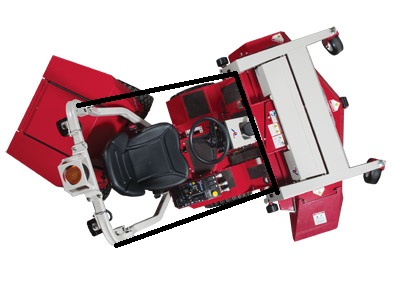

This tractor pivots in the middle so I can't cover the engine. But, I was thinking I would go from the front to the ROPS like this:3400_Top_2261.jpg

Since it pivots in the middle, you'd probably want to keep the cab very short, but it still might be worth using an inexpensive golf cart cab and just cutting it down. Or let it extend back over the engine, but cut it short so it clears the engine housing. When I did mine, I cut it in a few places and sewed it on a regular sewing machine.

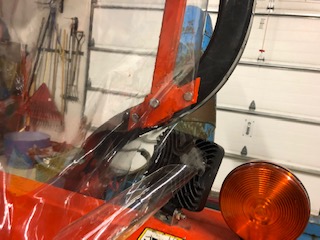

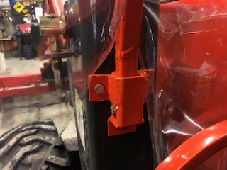

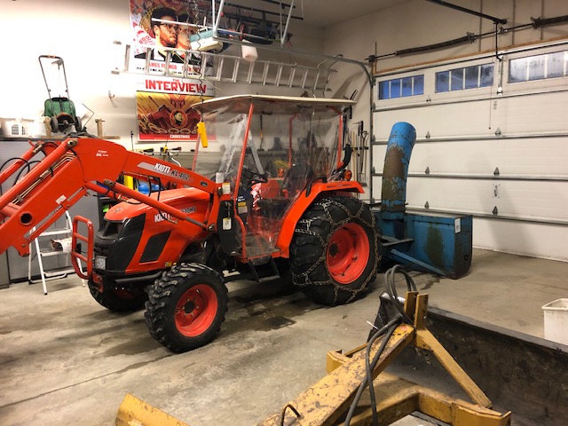

Just thought I would share, I got a roof from a golf cart, welded receiving brackets for the uprights and bolted to Loader frame and ROPS. Made uprights of 1x1 1/4" tube. Bought marine grade vinyl, which wouldn't last if the unit was stored outside. If it does start to crack at corners etc I'll get some outdoor fabric to do the edges and corners. I need to add some ducting to capture the engine heat ie the old heater houses. I'm just going to have the door as over lap for now.
I blew snow yesterday in -16 C, very comfortable. I need to clean up the vinyl install yet but so far real happy for $120.
The unit will only be on for the winter.

Nice job. I found that breaking the wind was 90% of the battle. You don't need a lot of heat to make it comfortable, it even has solar gain on a cold but sunny day.

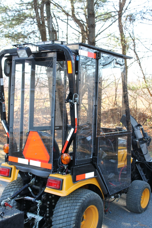

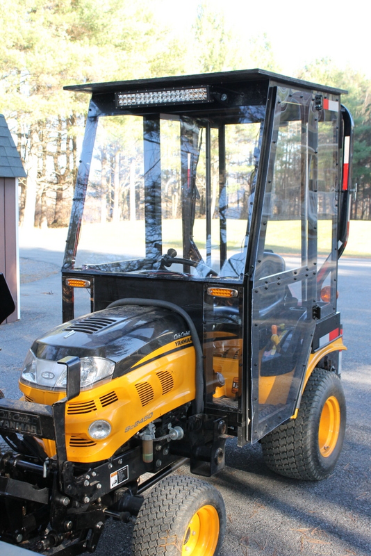

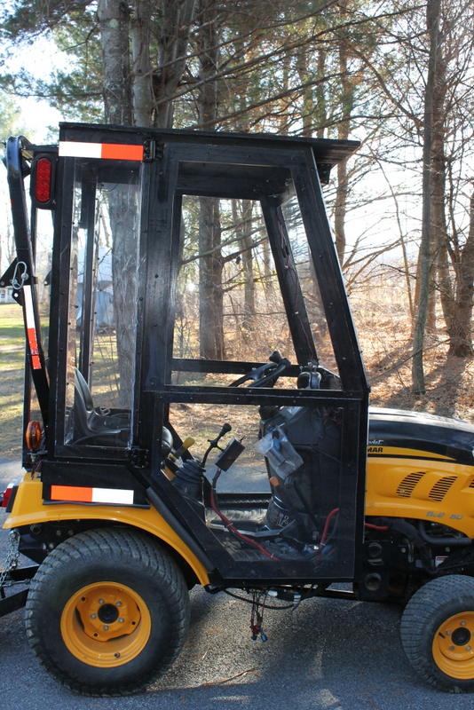

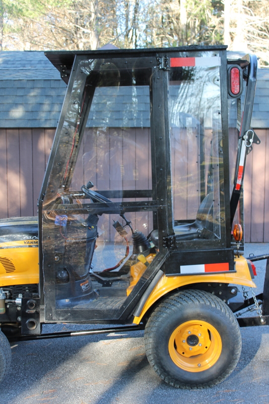

Here are some pictures of the winter cab I built for my tractor, I have lexan for the windows no issues with fogging.
/ Simple Tractor Cab #15
Yes it is made out of wood, It is held together with pocket screws. The lexan is held on by metal roofing screws with the rubber gasket.
Before you start make sure to get the lexan first so you can build it to the dimentions of the lexan you have. I built mine then went to get the lexan from Home Depot and in the stores they do not carry 4'X8' sheets
as my front windshield is about 4'. I had to order 4x8 sheets and they were on not cheap. the front windshield is 1/4" thick and the rest is 1/8" thick I spent about $400 on just the lexan.

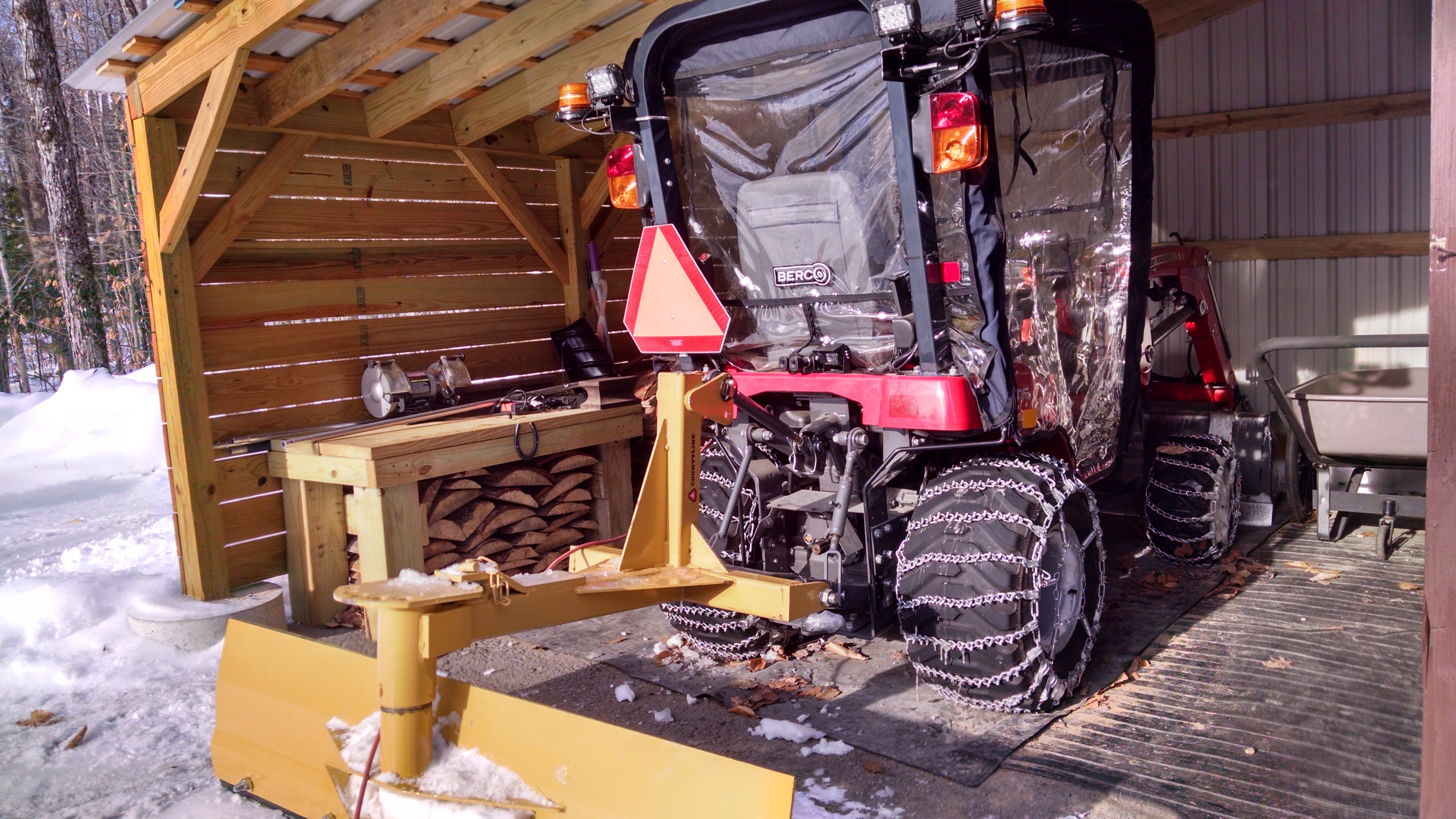

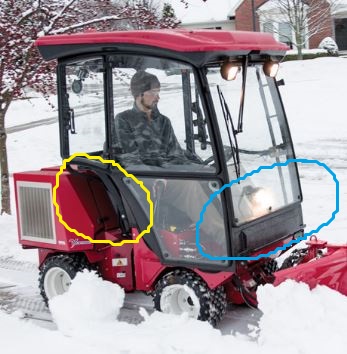

You can buy one of these for three hundred dollars.. Bercomac. Works for me.

I don't think I could make that work. I'm not sure if the clear plastic would be low enough in the front (blue circle in picture) to see the snow blower. But, the main problem is the back where I have circled in yellow. Since the tractor is center articulating, the cab needs to be very narrow behind the seat. For another picture of how the tractor articulates, see post #4 in this thread.

I see and agree that it probably would not work well on that machine..
