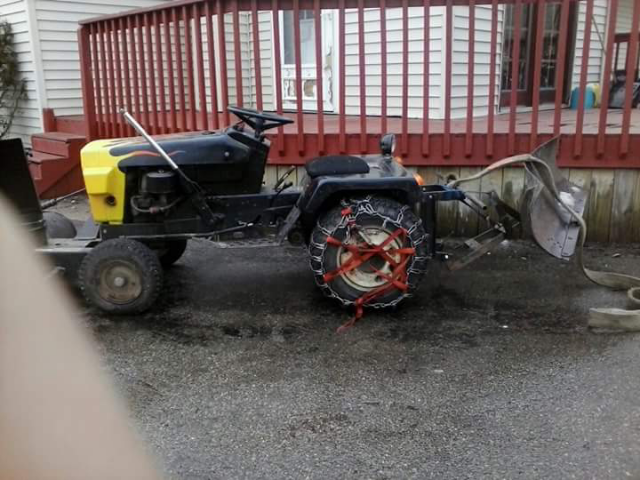

I need a wiring diagram for the engine/starting. tried to find one a while ago but it don't work. Any ideas?? Tractor is right around the 80s I would say

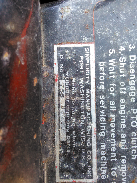

if by some chance it is a starter/generator combo this is correct can you see any numbers on the starter this will help us i/d the unit as to what it does or possibly a picture would be most helpful.

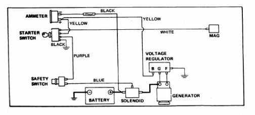

Can do tomorrow. It's a combo. The generator/starter is good. What I need is a diagram to figure out the voltage regulator like the one I found and am going to try out
/ simplicity 3410garden tractor #6
most of these combos are regulator that are specific to the combo can you see if the unit has a delco number on it . if not let me know i will supply part numbers that are possible fits dont get scared they may only be about 3 or 4 numbers of which some are interchangeable
