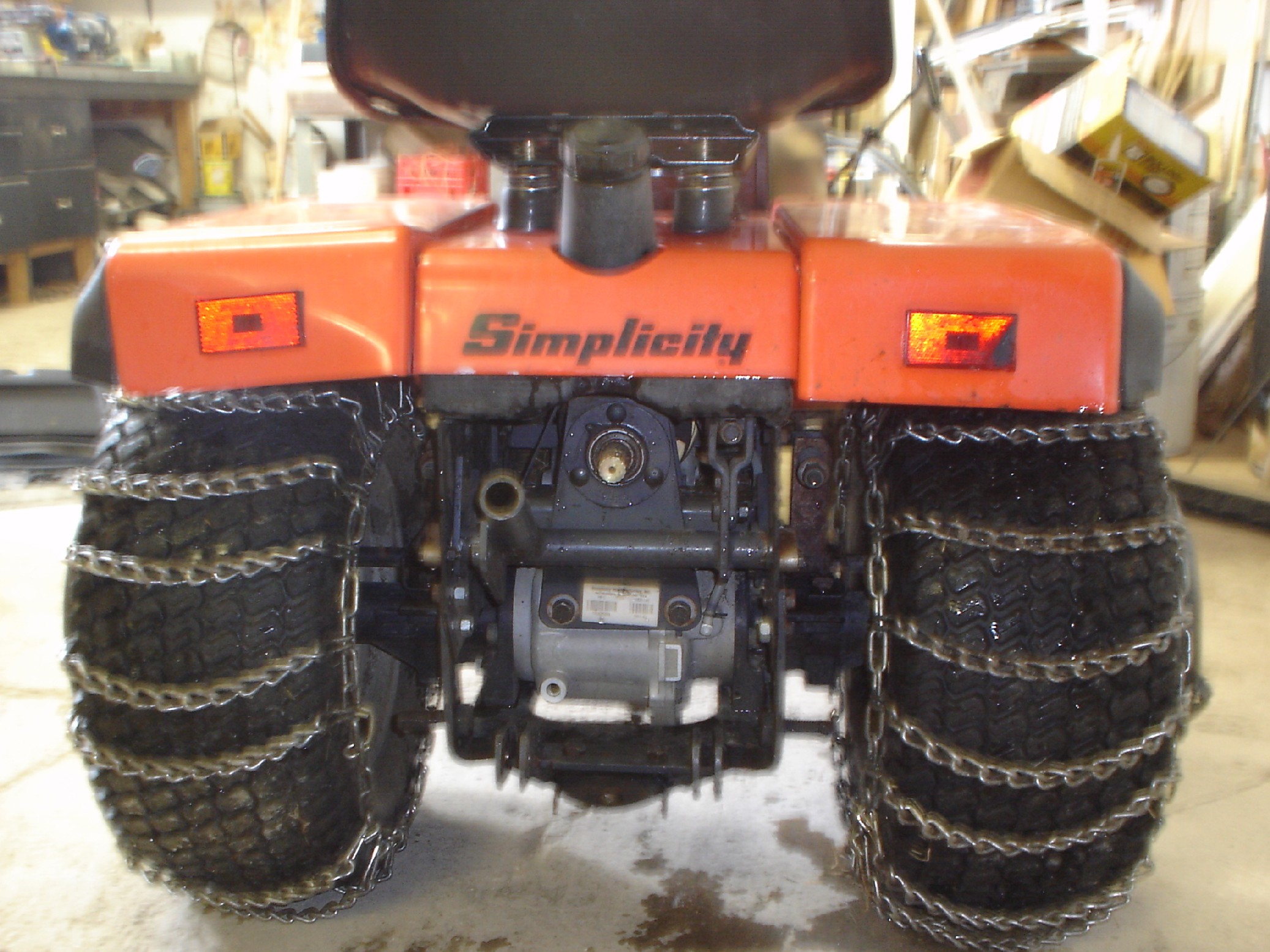

I got a response from the guy selling the Sunstar near here. He sent me some pictures and a little bit of info:
"I bought the unit new in 1997.
897 hours on the tractor as of today.
Serviced by myself. Regular maintence, change oil, grease, wash and stored inside all the time.
It was used on our acreage only, not for commercial work."
I will attach a couple of the pictures.
Even considering the price I think I am going to go and see it in a couple of days. I want to see if it really does look good. The mower and the tiller look as if they have been worked a bit. Peeling paint on the mower is fine as long as the structure and sheet metal is good. The engine looks good in the picture, but what should I be looking for in an engine of this age and hours. Are there any issues that the Kohler Command has had?
I'm going to be looking at the frame very closely for strength and rust. I'm interested in seeing what the PTO's look like, wear and tear.
Am I missing anything? Price is still going to be an issue. I am getting the impresson that prices are fairly high around these parts.

/ Simplicity Sunstar #23
Hey Klorinth, from the pictures it looks in pretty good shape. The Kohler Commands had a issue with the valve covers leaking in the eailer years, but I think thats about it. If that motor was taken care of, it has several hundered or thousand hours left in it. The battery may need to be changed soon, looks like a org. battery, or he just went to Simplicity dealer for a new one. I have never had a deck peel paint like that. May want to repaint the deck sometime. Also i see he backed into something, sheetmetal is bent up on the left side (sitting on the seat). The PTO and rear of the tractor look very clean. Need to get a picture of the tiller and snowblower.
If I am not mistakin, the PTO and 3pt were around $500-$600 option new I think. The tillers were around $1500-$2000. Used on E-bay, a tiller will run around $400-$600 if you can find one, like I said they are very rare. I still think $5800 is high. Around here in Illinois, I would say that setup would be around $4000-$4500. It all depends if you find someone who wants a Sunstar with a tiller, they may pay more.

Hey all. Thanks for the help, it has been very useful.
Just got back from looking at the Sunstar. It basically looks as you saw in the photos. Clean and well cared for. Son did back it into the fence(minor). Right side ball joint is being replaced. And he said that he is taking it in to be seviced before selling it. He says that there is a pin in the rear PTO that needs to be replaced. According to the repair guy it is what holds the PTO together, and they eventually wear out. Does this make sense to you guys? He wasn't positive about either. He is taking the other guys word for it. He had noticed extra noise coming from the PTO last summer when using the tiller and had asked the repair guy to look at it.
Anyway... he will be having all this service done before selling it. Ball joint has already been ordered.
Implements look good. Tiller has minor dents and scrapes. Paint is peeling off the mower, both top and underside. minor rust spots, and a repair to a side wheel. Rollers are wearing, but still usable. Hollow.
He is firm at $5500. Simplicity does not last long around here. States he has others looking at it as well. He admits to being a salesman of course. Doesn't want to just trade it in because he will get less for it, and it will then be sold for more than he is asking. Example being that other picture I posted at $7800. He is giving me a couple of days to think about it before he goes back to the dealer about his upgrade.

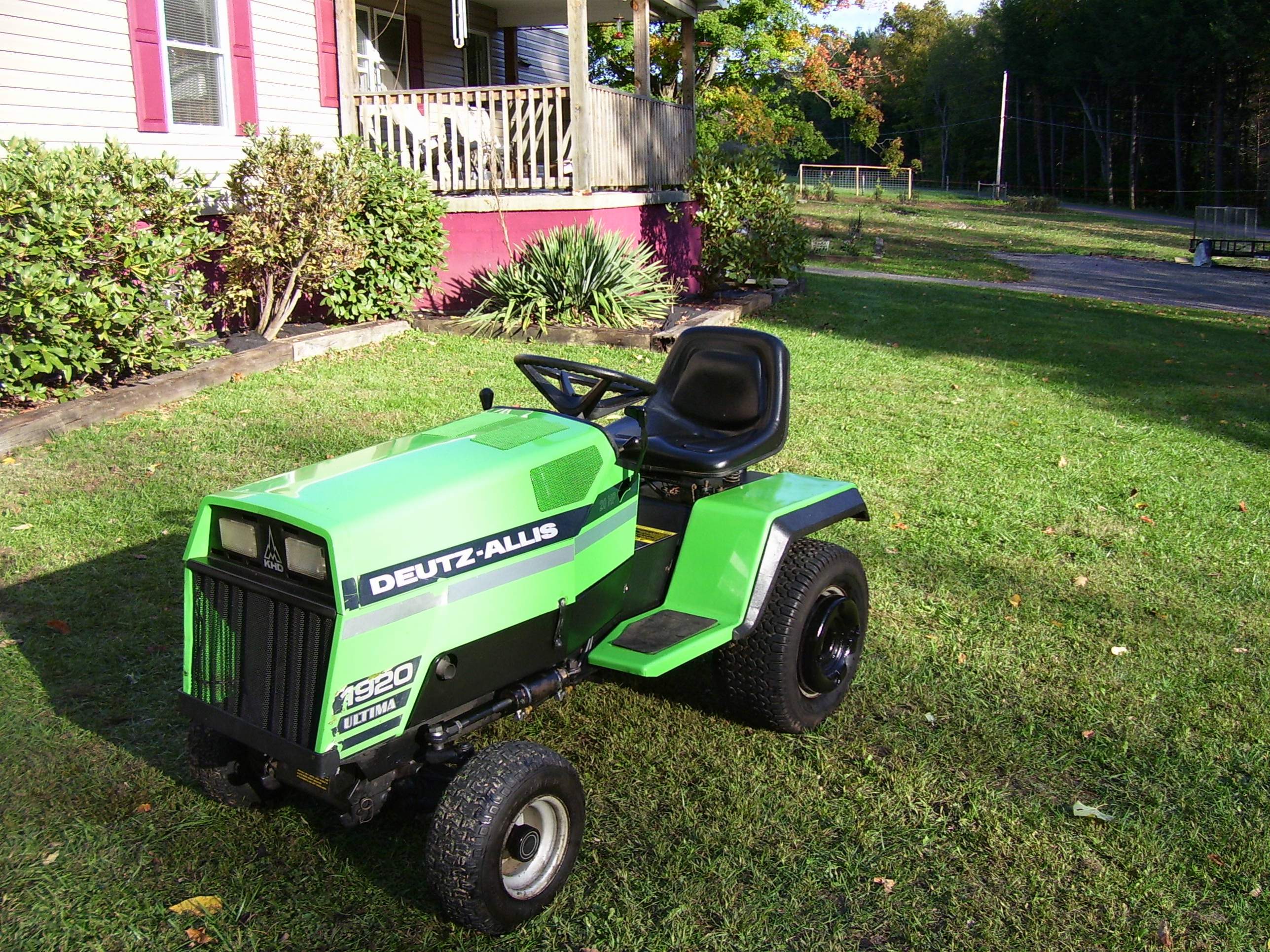

This is a 1989 deutz-allis ultima. Dale
