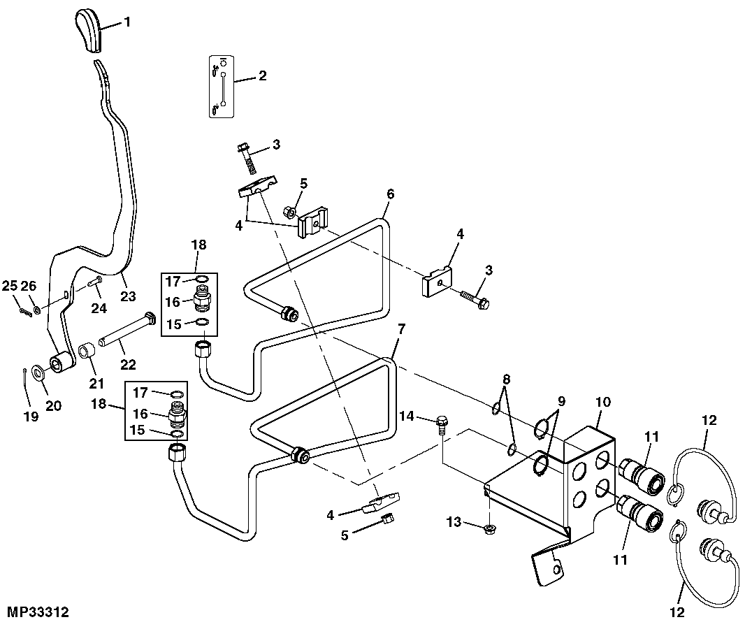

You did not specify OS or CAB model, so I will assume it is a OS (open station):
As I wrote before, you already have the valve-just no way to control it. You do not have to "open" the hydraulic system at all to install this kit. Look at the parts breakdown I attached below.
The JD technical manuals on CD are under $100, look HERE. They are VERY comprehensive and detailed. Use the money you would have spent on labor to buy one.

Thanks guys. You have been a big help.
I have no desire to get into anyone else's rice bowl, I just don't want them getting into mine. After looking at the parts list I see what you mean, not a big enough job to justify the money they are asking.
The only thing that concerns me is the notation at the bottom of the LVB25513 Kit page "(A) Factory installed triple SCV only Reference DTAC solution 78478." I will verify there are plugged ports on the triple SCV before I order the Kit.
Since the service department mechanic said they would have to "stack" the SCV valve onto the existing valves, I'm assuming he was simply mistaken as to the configuration on the 4520 CUT.

Yes, I'd say he was mistaken too. Maybe a bit of a snow job to give him more allowable time.
But just in case, good to check out for sure that the SCV valve isn't already in the "stack". Parts dept should have that info as well, and the existing valve sketch for you to look at.
