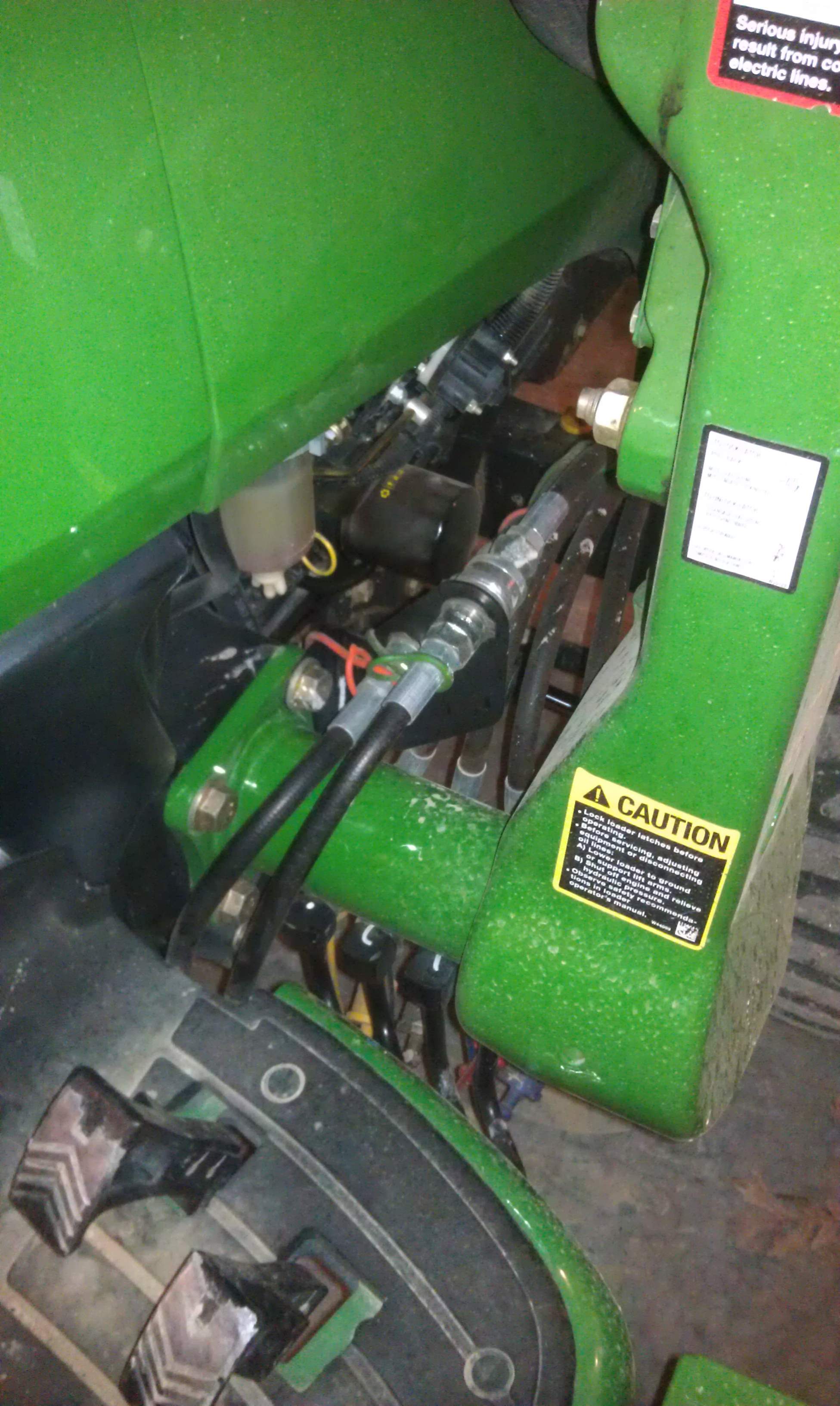

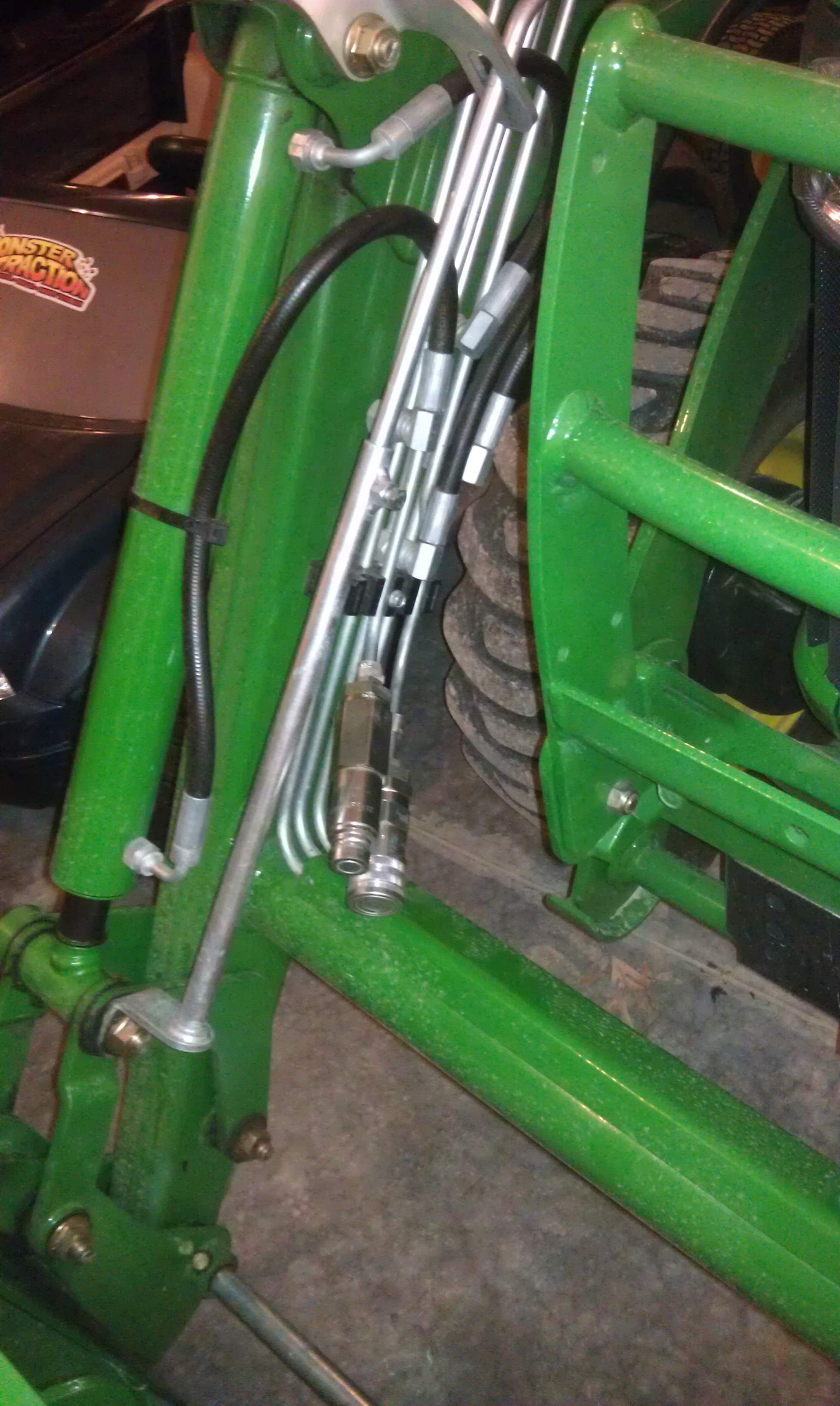

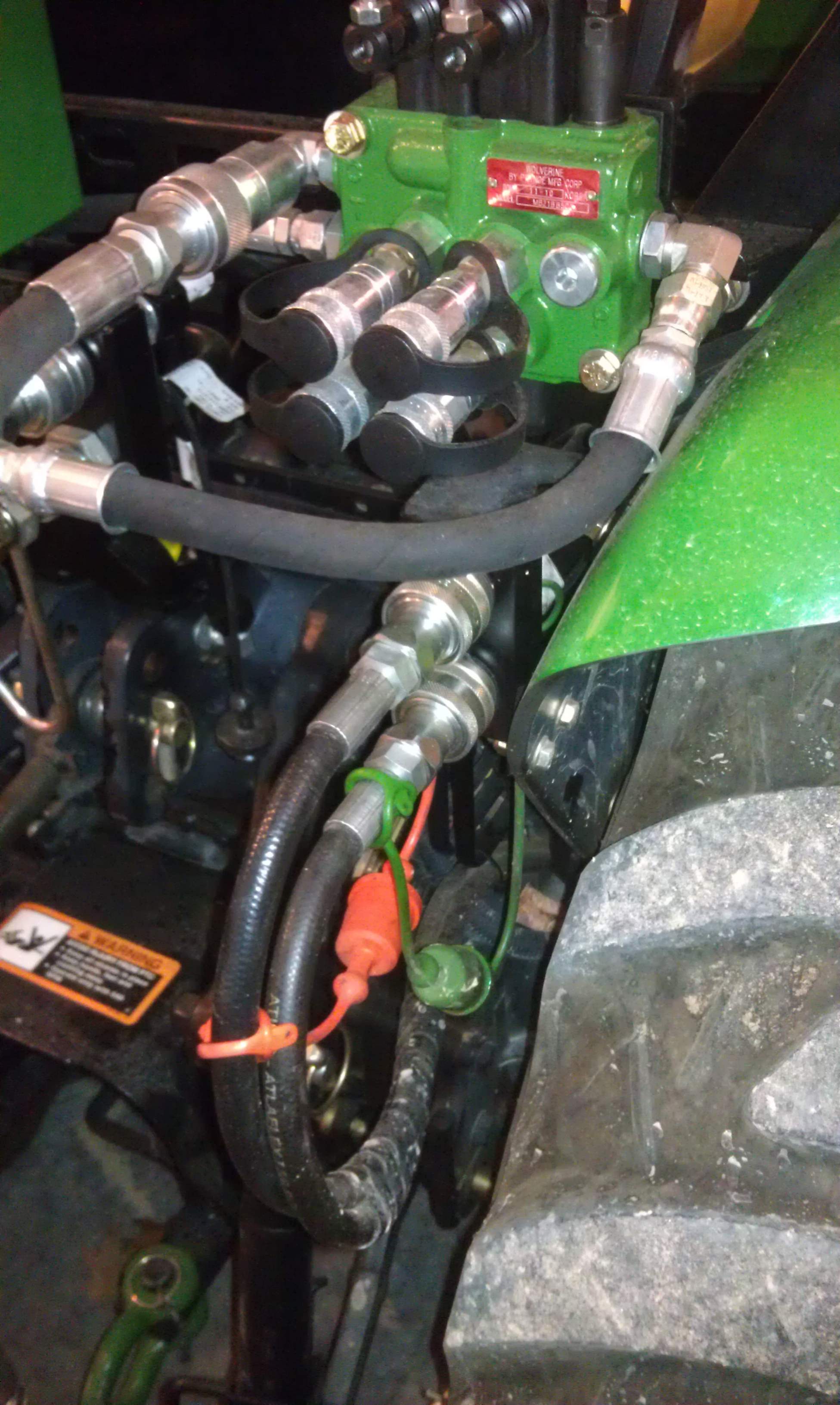

Hey foggy1111 do you have any pics of that hard line kit on the 300cx? I am going to use a rear remote also and debating on hard line kit or just hoses.
   / Single Lid CUT Wicked Grapple..If your compact tractor could talk.... #118
I don't have any pic of the JD kit. Maybe it's on the JD site? But?basically it has flexible hose connections in the back that split via Pioneer quick couplers in the same location as the loader connections (thus allowing you to disconnect the loader) ?.then run forward via hard lines along the right side of the loader mast and terminate with 1/4" Pioneer Connectors. (perfect line size to run a grapple)
I'm sure that Hydraulic hose would provide a good means to operate too?.it would just take a few zip ties. I believe it would be cheaper that way(?). I bought my tractor used?.with the hard lines kit factory installed.
I see you have three sets of remotes on the back of your tractor?.nice! I wish for another set so I could run a hydraulic top link. May have to add a splitter this spring.
   / Single Lid CUT Wicked Grapple..If your compact tractor could talk.... #119
Here you go. Hope this helps. I wish they where secured a little better like some others I have seen that have the fittings at the end going through a metal bracket that doesn't allow it to bend. Overall i like it better than the kits that just zip tie to the loader hoses.
   / Single Lid CUT Wicked Grapple..If your compact tractor could talk.... #120
Thank you both for the info and pics. I think I will do the hoses with the nice clamps on the loader arms and then I can mount the couplers where I want them on a plate.
