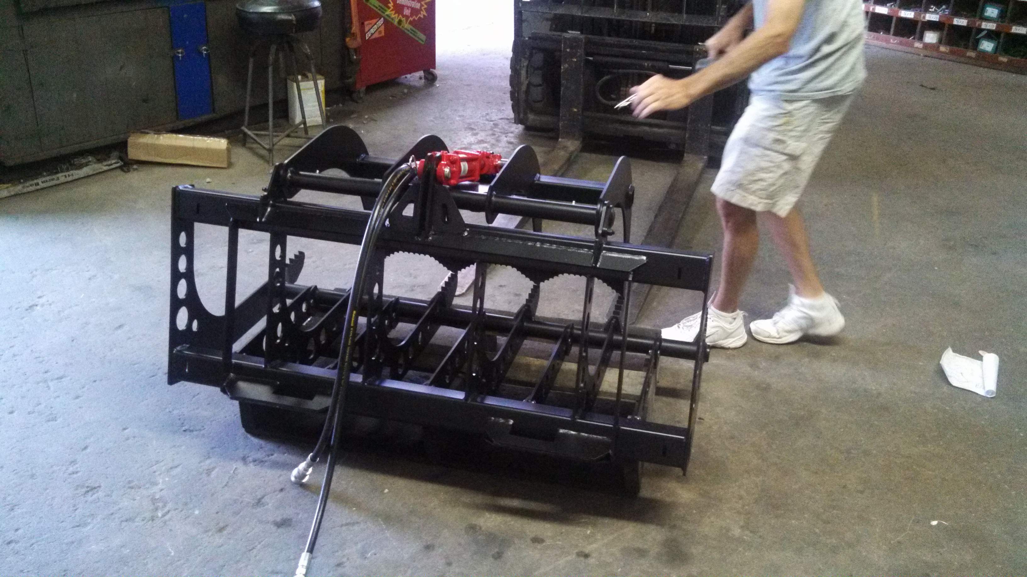

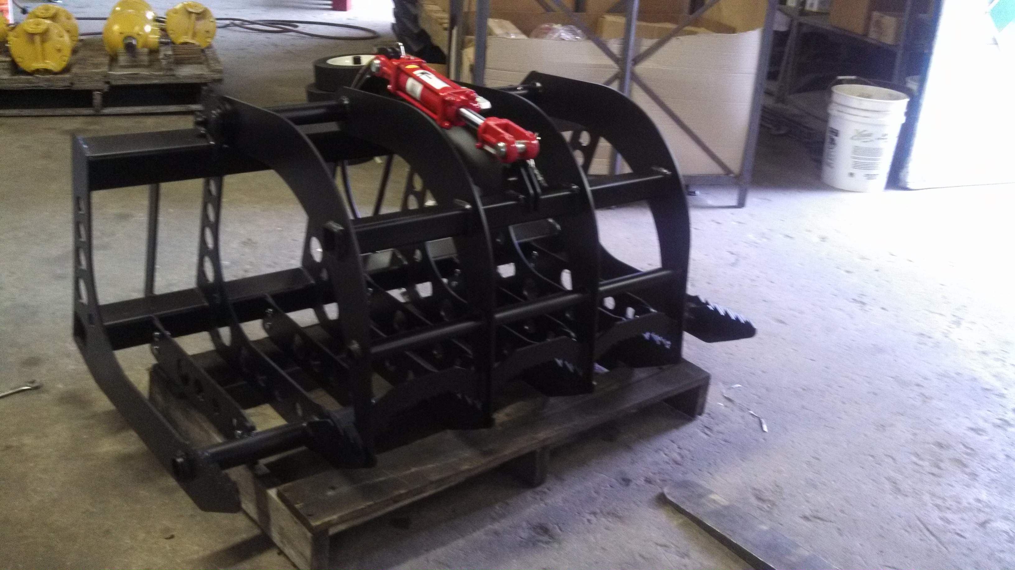

Here are some pics of the single lid wicked grapple ordered by TBN member bandaidmd. Peanut was in the process of installing the cylinder and hoses.
Thanks for the business, Larry! It will be a great addition to your B Series Kubota.

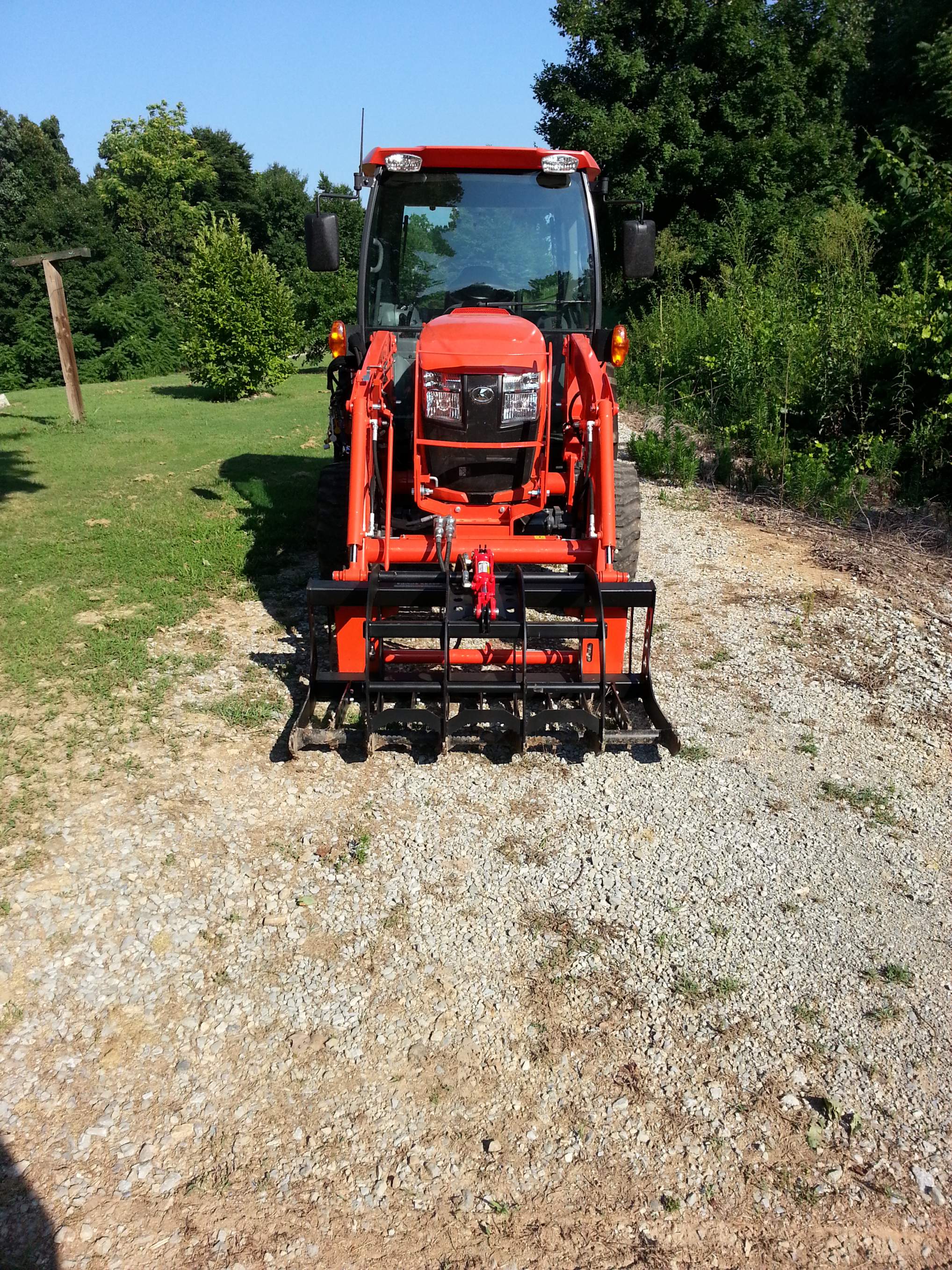

Here's a pic of mine right after I got it on my L4060. I'll post my experience with it so far once I have a little more time with it.
