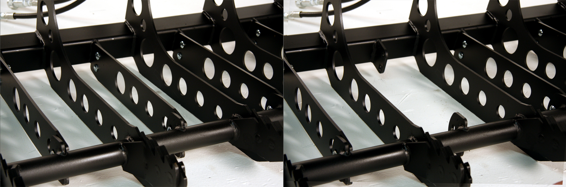

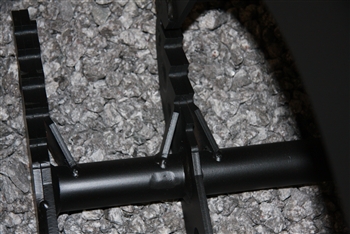

Agreed. It will depend on the root size also. A grapple or ripper will make easy work of clearing roots from small trees, but with large ones you'll need to approach it as Island has described.
The design of our tines allows for better ground penetration than you'll get with most grapples because the gussets don't get in the way.
The new rake style grapple that we'll be introducing in the next week or so is designed more for pushing like a bulldozer and raking roots. The tines are closer to your loader arms so the stress to your loader arms is lessened when you're plowing forward. It will look like this:
Travis
View attachment 329051View attachment 329048
Travis
