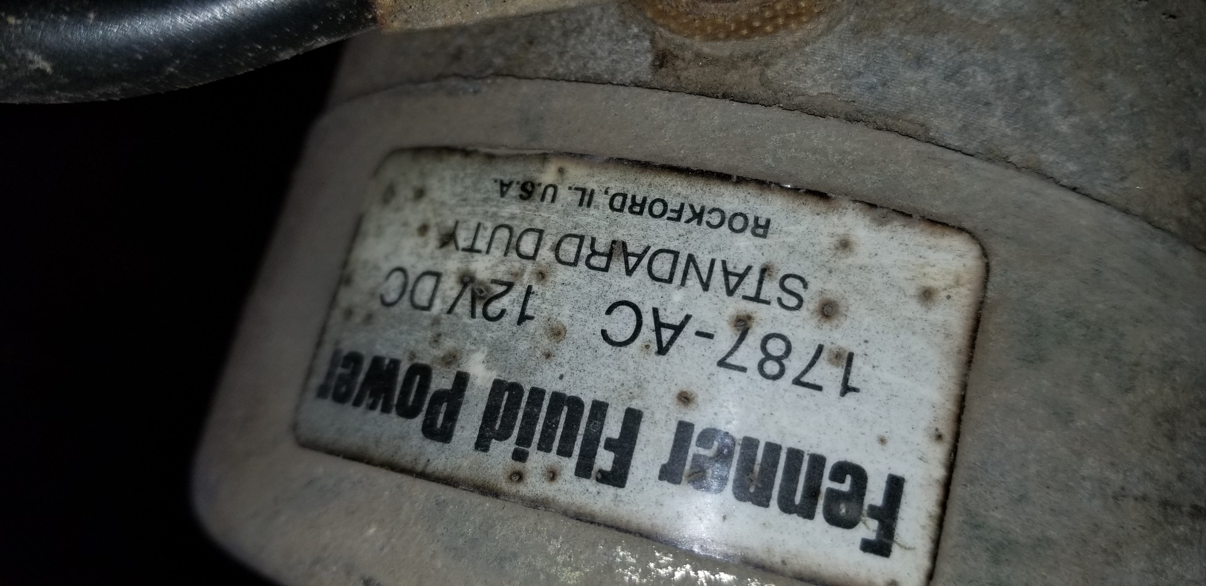

I am just starting to bring an old dump trailer back to life. It has a double acting cylinder with a single acting pump. As you can see in the picture, the top port on the cylinder has rubber hose that returns to the tank. Since I am installing a new dump pump kit, should I switch to a double acting pump or continue the current single acting setup?
6x12 dump trailer
Cross 3 inch bore , 24 inch stroke double acting cylinder
(2) 3500 pound axles
Factory built, unknown manufacturer

You only need the hydraulic power to raise the dumper, gravity brings it back down.
The builder simply used the cylinder he had on hand and rendered it to single action mode.

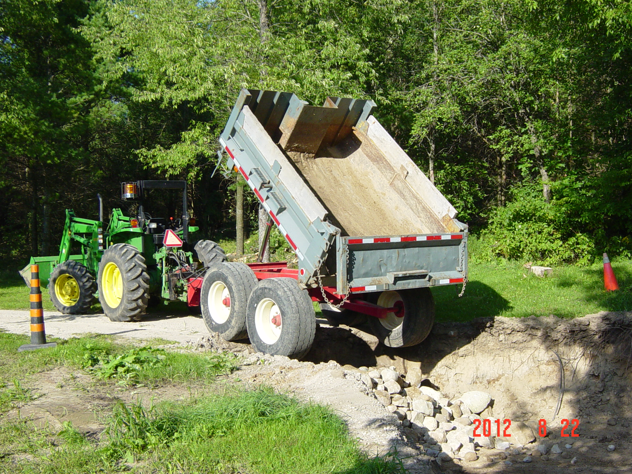

I too have a double acting dump trailer. When I use it on the tractor with tractor hydraulics it works great! When I use it on the truck with the pump.....I’ve been stranded before too. I’ve even added a 4ga wire and associated solenoids, breakers and fuses to have about 40 amps of power trying to keep the battery charged. My fully charged battery (deep cycle group 24) lasts one dump. I’m thinking the pump motor is getting tired and must be drawing a heck of a current tire drain the batteries so fast, which over a few months seems to destroy them.
OP, go single acting!!!!

My Ez-Dumper trailer is power both ways.
What controls the down speed on a one-way?

They go down fast which is one of the main advantages IMO. You’re limited by how fast the fluid can exit the cylinder so it’s not like free falling or anything. On my manual valve truck you can somewhat control it. On an electric valve dump trailer you probably only had one speed.
