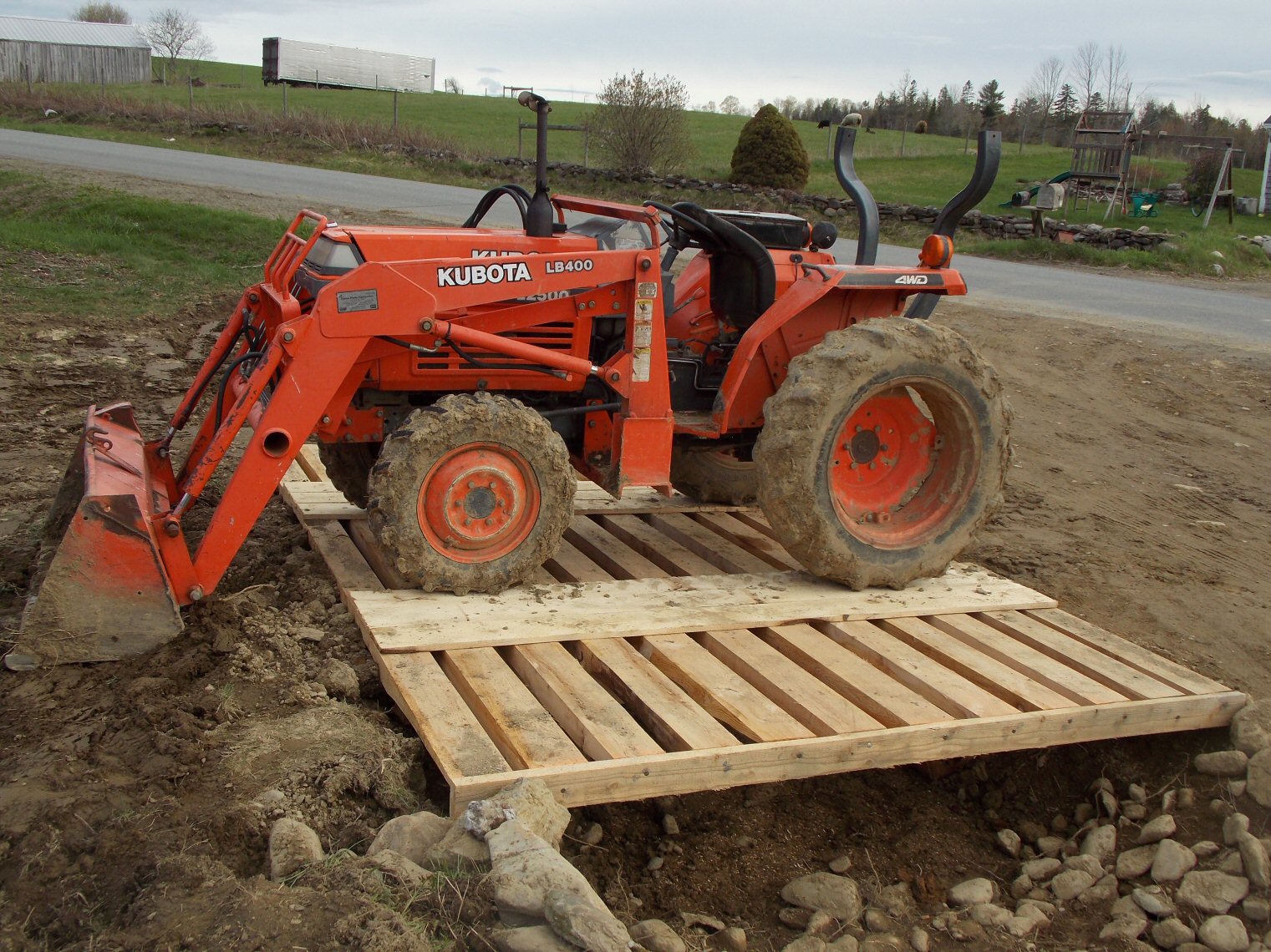

Ok, I have to ask an obious question here. Looking at your pic the driveway comes in from the road just to the right of the tractor and the ditch appears to end at the road....so why not just drive into the land from the road on the other side of the ditch to the left of the tractor in your pic?

I have been redoing an old house that I have, and redid the driveway with gravel and such. It was no big deal, but I wanted a way to get across the new ditch. I thought about a culvert, but they are ugly, and cost money, so I decided to go with a bridge instead.
I admit that it took me 8 hours to build, but in the end it holds up my tractor/truck just fine, and only cost $16.50 for the long spikes I had to buy. Gathering up the logs did not take too long, but sawing the logs into lumber kind of did, taking the most time. But by noon I was starting to build the bridge.
It is 8 feet long, and 12 feet wide, the bridge resting on cedar supports, with the main beams being 5"x10". These I spaced at 5'-6" wide because my tractor has a 5 foot wide wheel base, and my truck has a 6 foot wheel base, so I split the difference. Over that I put down 3"x6" Hemlock planting, with a 2x4 hemlock spanning the outside edges to keep them from flexing. Over that I put 1 inch spruce boards so I know where to drive and have the main beams under me.
Overall, it was a rewarding project that turned out nice (I think anyway). I have used it now almost daily for a few months and have had no issues with it.
So if anyone has a stream or ditch they need to cross, his might be a cheap and easy way to do it.
Cedar and hemlock are OK, but that spruce will rot while you are just looking at it.
The driveway is actually circular, coming down from the upper left of the picture then swinging down and around.
The driveway had a problem in that it was lower then the ground, so it filled with water and got muddy in the spring. I fixed this by digging ditches on both sides of the driveway, and putting the material in the driveway. I then hauled up several hundred cubic yards of gravel from my gravel pit, and now had a driveway that was 3 feet higher, and drains well. That cured the mud problem, but left me a "moat" towards the house.
This gave me two problems. I could not drive up to the house directly, and with our cars in the driveway, visitors could not drive out the circular driveway.
The bridge cured this. This allows us to drive right up to the house, but also allows us to get our vehicles out of the circular driveway. This allows people to visit, and then just circle out and back out into the road when they leave.
The driveway with the bridge is T-shaped...it has a spot to turn around, so we never have to back over the bridge as we can just drive over it, then back up into the gravel turn around pad, and then drive back over the bridge.
For the walkway leading to our house, we have another foot bridge crossing the ditch/moat.
