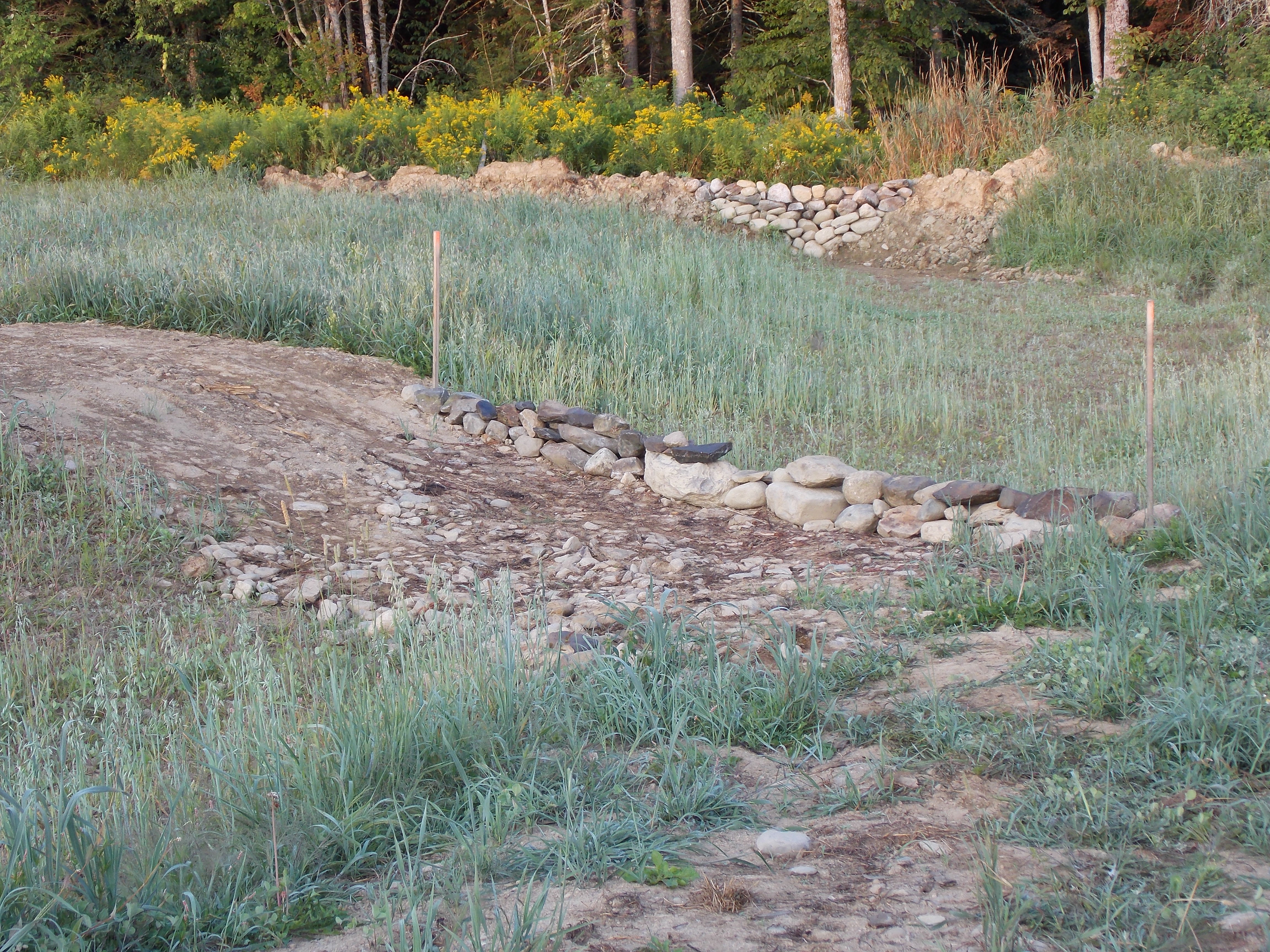

I have a "catch basin" on my land, though I call it a "dry pond", or a "swale". Whatever you want to call it, it is the last point before it enters the woods. I do not have to clean it out very often, maybe 10-15 years, but it is a good place to catch my topsoil before it gets sent into the woods. There are several rock check dams before it gets there, and I have a rock ford to cross the swale with my tractor on solid footing.
Bridges, culverts (even though they are ugly), swales and rock fords, they all have their places.
Here is my "catch basin", "dry pond" or "swale" right (whatever you want to call it) right after it was cleaned out, the rock ford resurfaced, and the rock check dams reformed.
