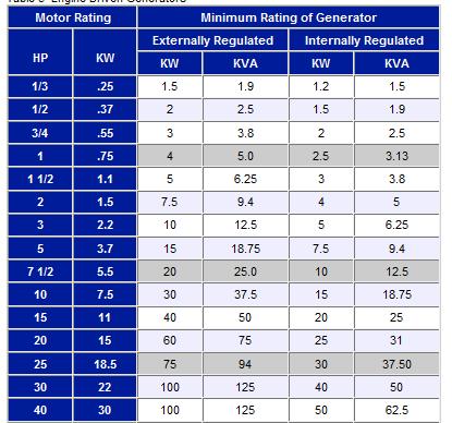

Here is the chart from Franklin. Google Franklin AIM manual page 5.
Page 5 | AIM Manual | Franklin Electric
Hi Goose. That was the manual that I found online as well. It says 7,500W internally regulated and 15,000W externally regulated. Guess I need to do some research on that, since I don't know what the difference is. I've also got a call into Franklin.
