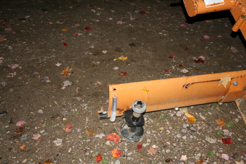

I'm sorry to say but I bet it wont stay put or intact. I had a similar setup on my rear blade with a thin metal pipe but it got chewed up on my gravel road. I switched it to a thicker pipe and it lasted longer but I still needed a way to hold the pipe in place so I added a spring. This worked well but I eventually bought a snowblower.]
We shall see. There were a number of guys kind enough to suggest this very thing, and some spoke of very good results. Soon enough we shall find out. If it doesn't work, I 'm out nothing but a piece of scrap and a 1/2 hour of my time. If it works, then I shall report the success. Within a month, I should think.

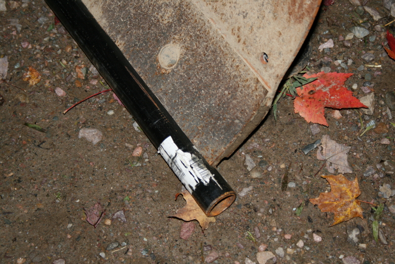

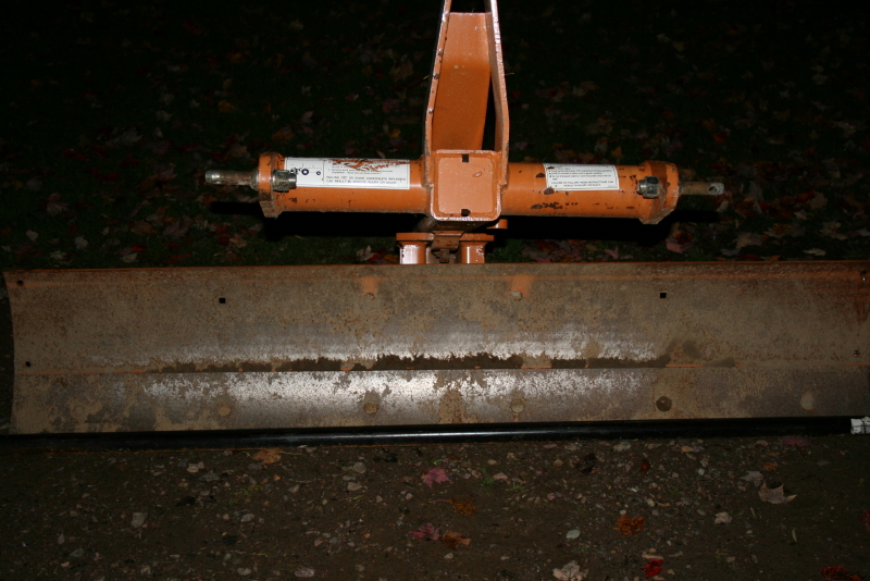

Wahooo! Got it done.
I cannot express my thanks enough to all those who suggested the pipe on the front of the blade. I had a big ol' scrap of 1 1/2 sched 40 so that is what I used. Ran it through the table saw, it cut just fine. One slit was not enough, couldn't get it on nor keep it on. Ran it through again, side stepping 1/2 ".
Perfect. Fits like a glove. Here's to hoping it stays put. What a wonderful idea. Thanks again to everybody. Can't say I am anxious to try it, but I feel better prepared for the inevitable.

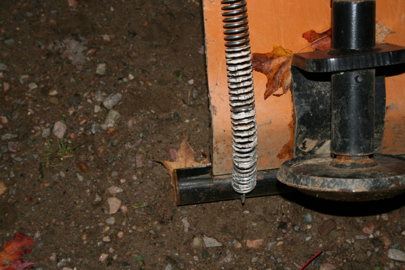

I did the same blade guard addition to my rear blade but quickly found out that the pipe material was too light for the job. It lasted a few plows and it started to peel apart and came off often. The other issue was that the blade would float over the snow because I did not have any down pressure. I added weight to keep the blade down, which worked, but it sped up the demise of the thinner pipe.
A few design changes that made the difference for me were:
Thicker piece of metal pipe Schedule 40 if I remember right.
Slit the pipe to the exact length of the blade but leave a few inches of pipe on either side untouched so the pipe fits tight on the blade. This keeps the pipe from sliding side to side.
A spring on both sides to keep the pipe from coming off the blade cutting edge.
I added weight to the rear blade to keep it from floating over the snow. You may not have to do this because you have a front blade.
I did have good results after the modifications but I ended up going with the 3pth snow blower because of the amount of snow we were getting and the length of my driveway. I now wait for the storm to end and do it once.
I will say this though, I will use my rear blade setup for the early small snow storms and/or until my road freezes.
Hope this helps and let us know what your results are.
