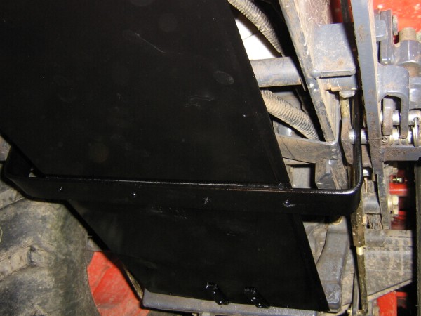

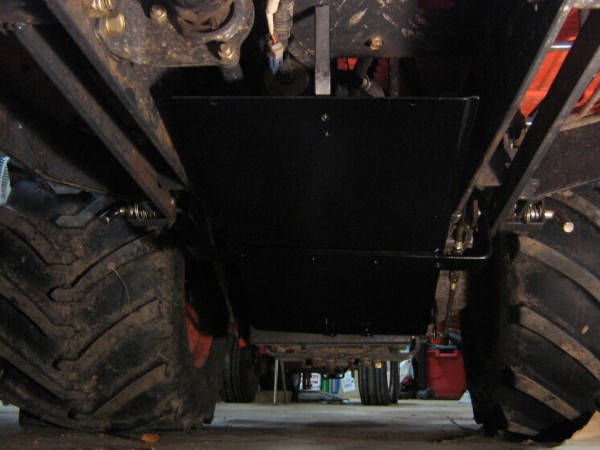

After I broke the blades off one fan and replaced it, I decided I didn't want to do that again, easy fix and any time the MMM is off, about 20 seconds and this is in its place.

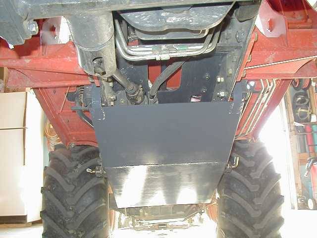

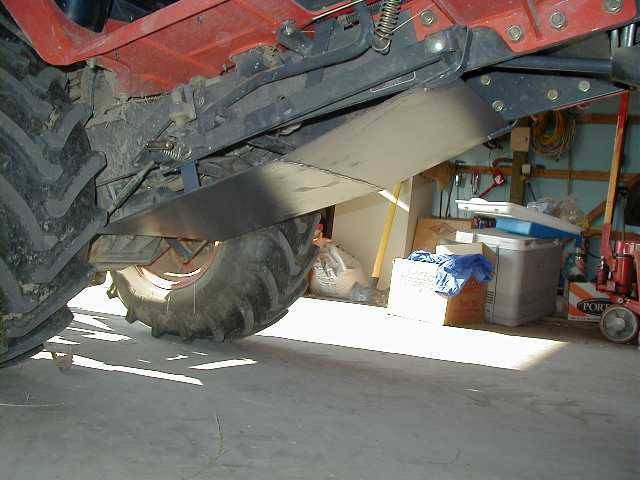

Having yet to experience the joy of replaceing a fan (wrenching my BX still qualifies as a joy btw) I thought some preventative fabrication would do well in keeping it a joy, hense my el-cheapo yet functional BX vital protector, otherwise known as a skid plate :D

Them are some nice looking skid plates. I like the idea of using the mower lift arms to mount it. That way you can remove when put the belly mower on and it wont be in the way when attaching the PTO shaft. Building one of these is going to be one of my near future projects. Good job guys.
