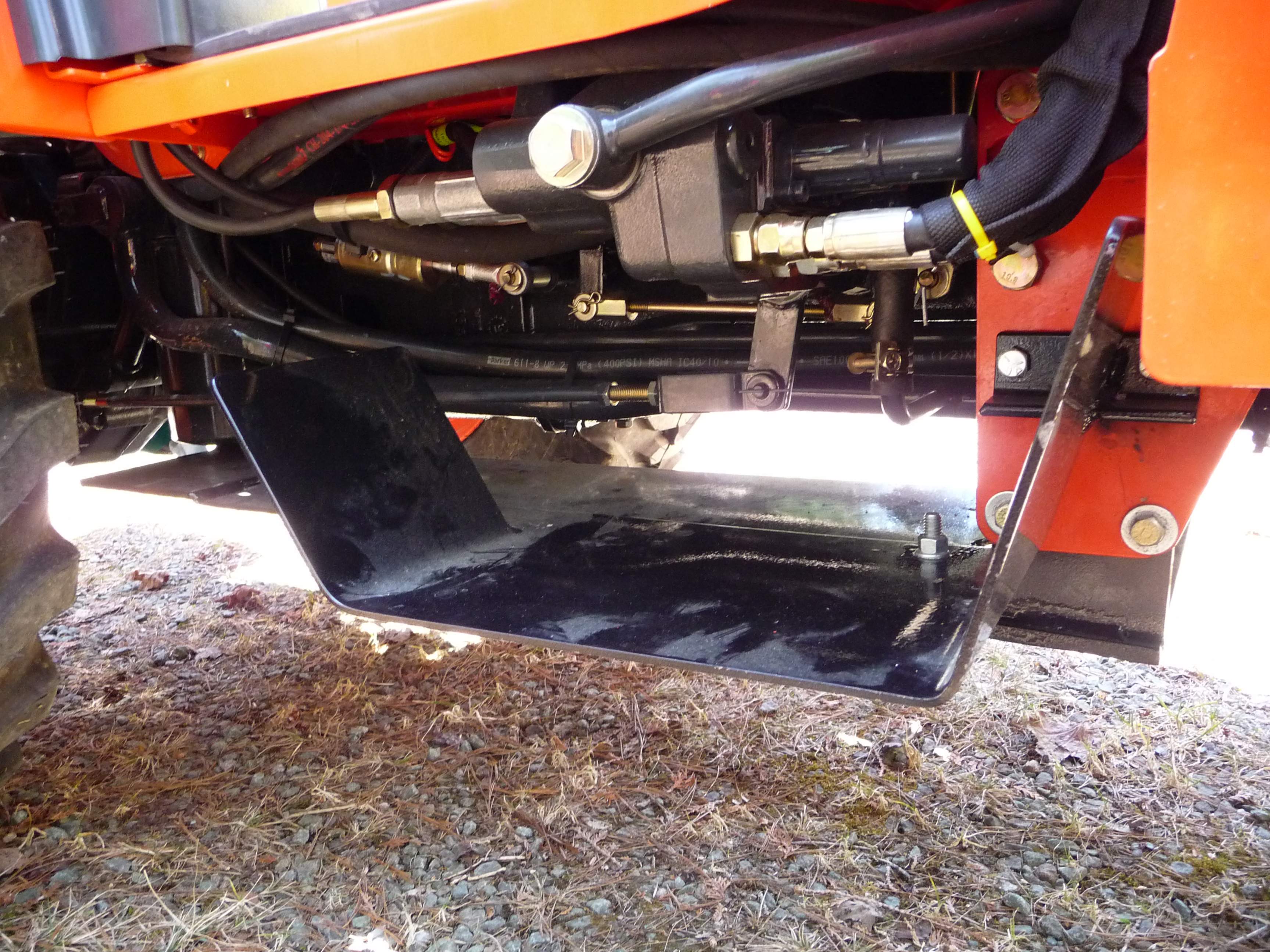

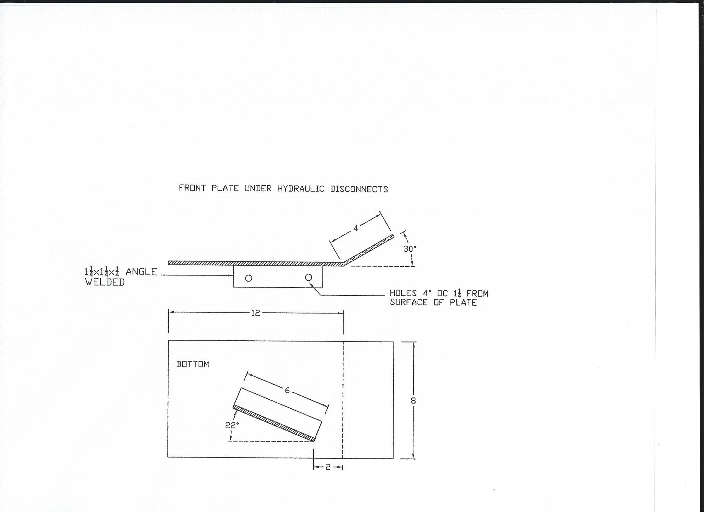

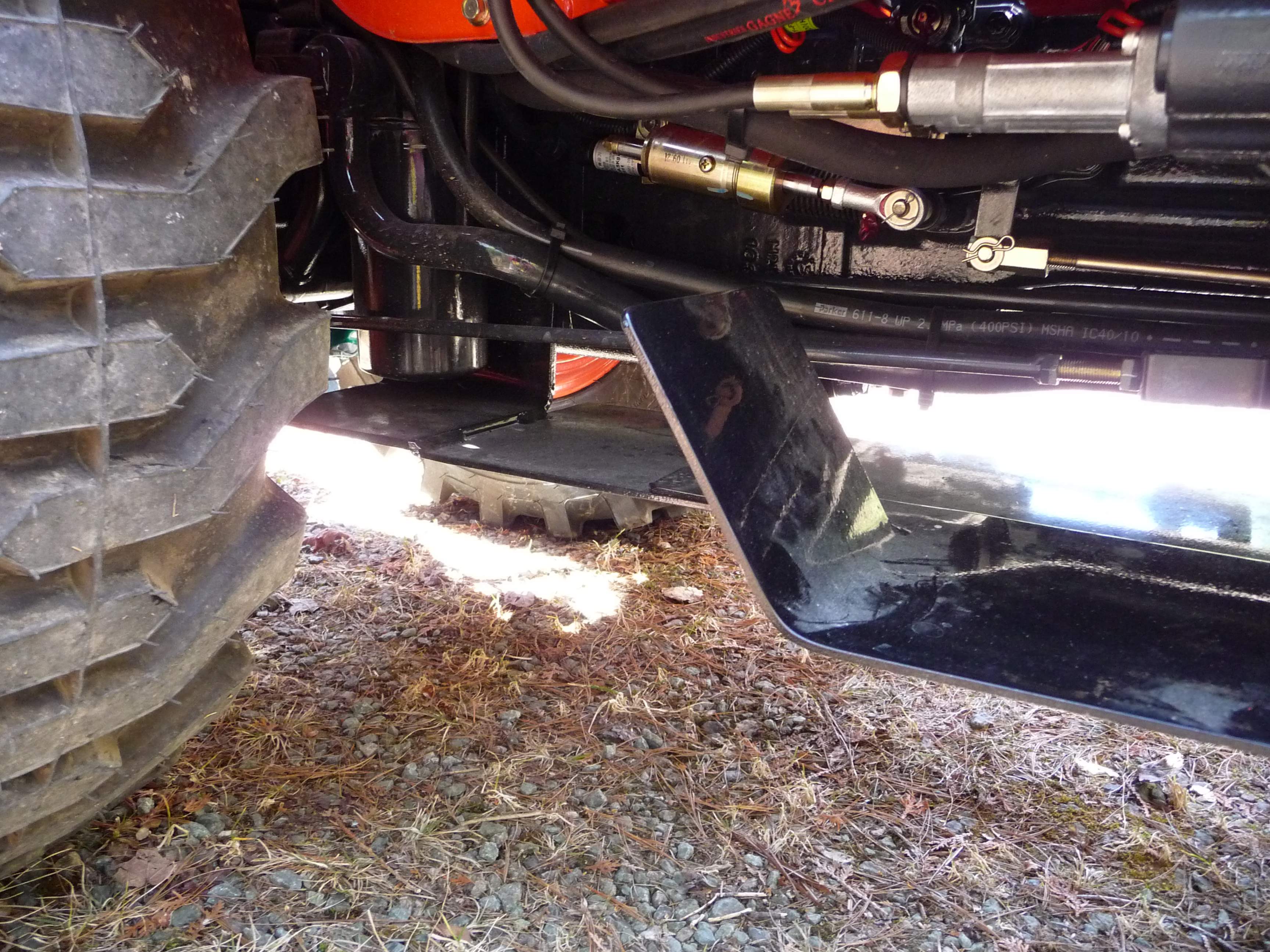

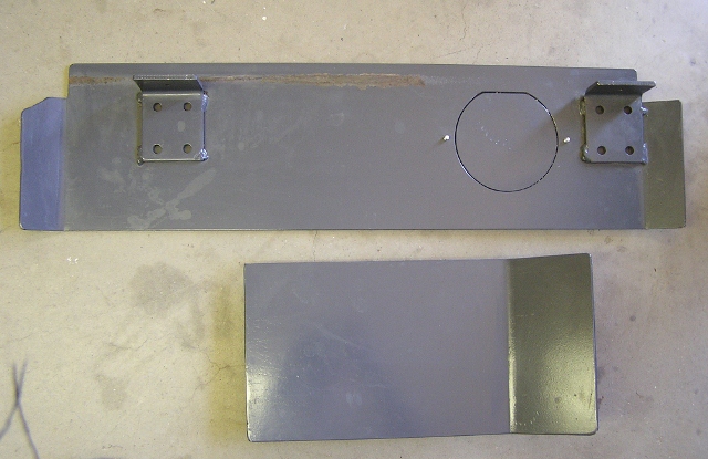

Yeah, I get what will need to be done. I don't have welding equip any more.
I haven't followed this closely but if you have the plate marked exactly to fit your machine, I can weld it for you for the cost of return postage. Of course you could also go grab a cheap welder from HF or find a buddy to help. If you are making the same one Murph did it is about five minutes of welding. Key is to mock it up and make sure the angle is correct. Murph's machine was different than the one we took the pattern from.

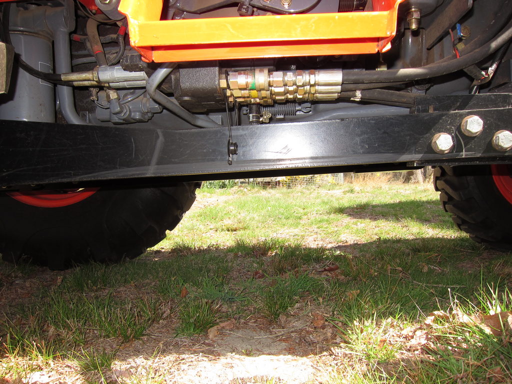

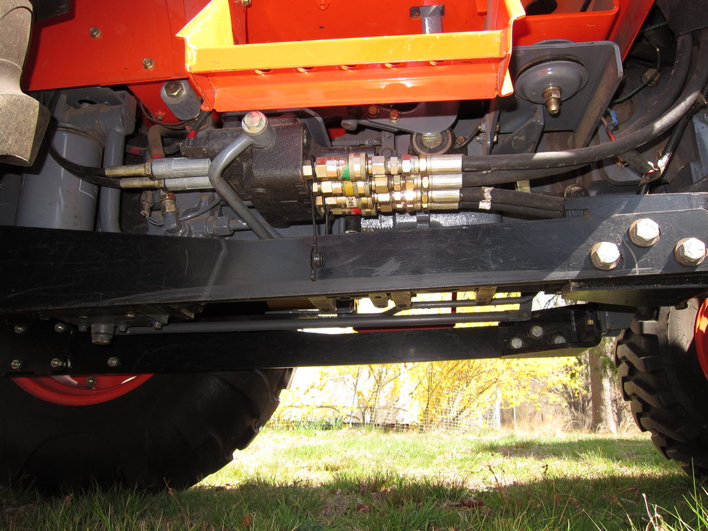

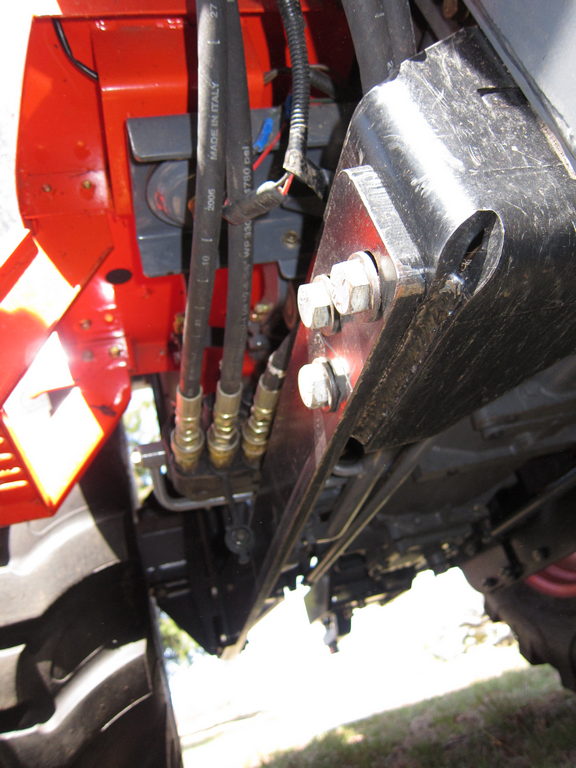

I admire all this fabrication, but I can't do it!
But I was pleased how the Woods BH80 backhoe mount extends up to the front of the tractor and provides a modest amount of protection from certain directions to lots of things including the filter area.
IT, thanks for the offer! I will get it done locally when I have time to fit it and figure out where the bracket needs to go.

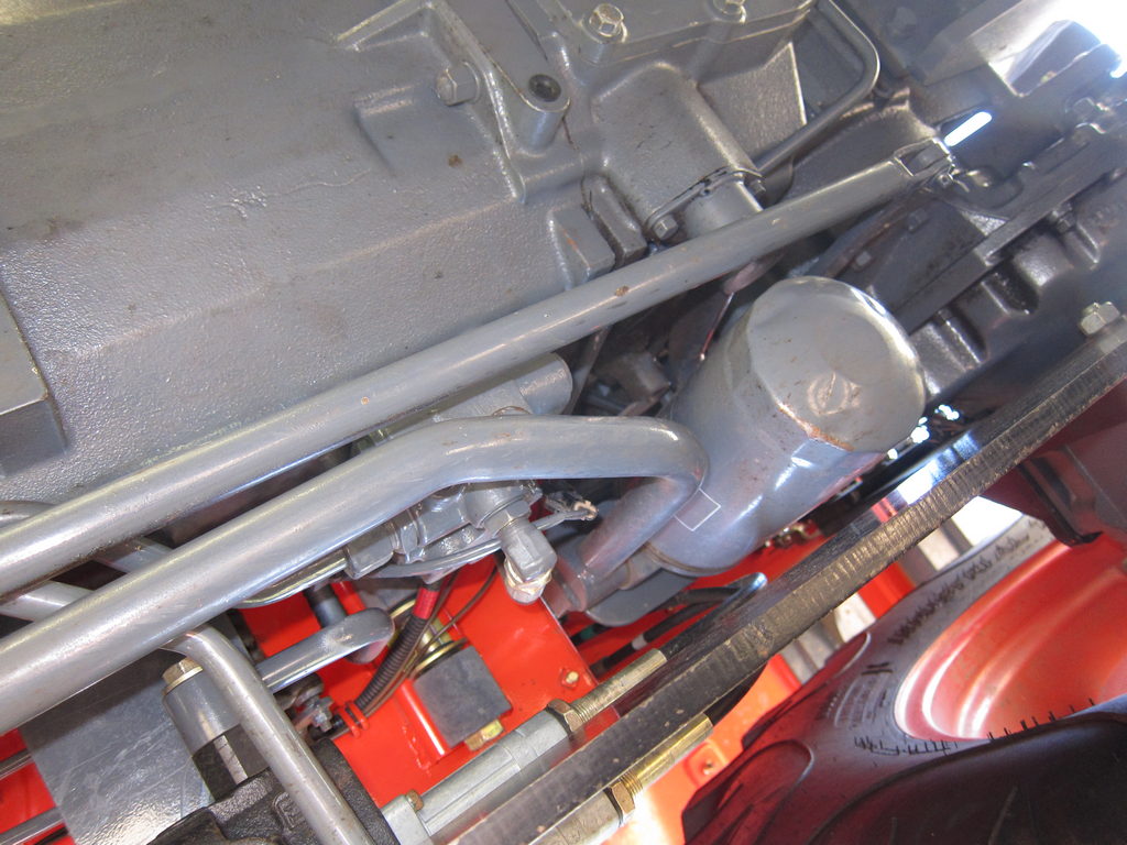

Last fall the hydraulic filter was punctured while cutting some trails with the bush hog in some grown over brush in a cut over, and I suspect it may have been caused by a broken tree branch, Around 3 weeks ago the hydraulic filter was damaged again while bush hogging some roads I suspect by either a rock or piece of gravel being hit by the bush hog blade and being launched into the filter puncturing it. There are also stumps in the cut over areas being bush hogged, and I think their is a great chance of future damage with no skid plate.

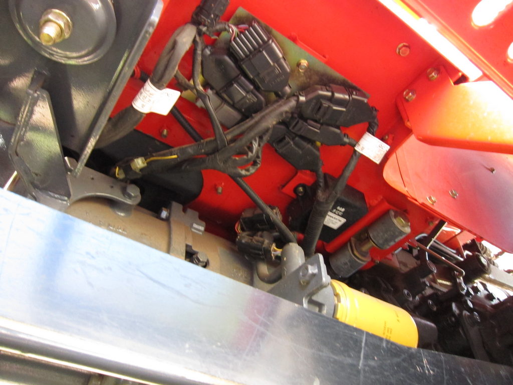

Not sure what happened to my earlier reply but here is the jist: There are no standard protective plates. It's all one off custom. The good news is that an effective protective plate can be fabricated from 10 gauge or 1/4" plate with just a few tools. Crawl under the tractor to find any predrilled holes or empty tapped threaded holes on the tranny or engine block. Look to see what other hard points you might utilize to secure a plate that covers vulnerable filters, control rods or electric lines. Get some cardboard and fashion a template. Get some plate and use a press and cutting tool or just have a local metal shop do the bending and cutting for you. Attach to tractor. You can avoid welding with tabs and bolts. If you don't have access to a press brake avoid need to bend 1/4" by making 2-3 "spooning" plates out of 16 gauge and bolt them together or get creative with plate, angle iron and bolts. Lots of fairly simple if inelegant ways to provide added protection.
