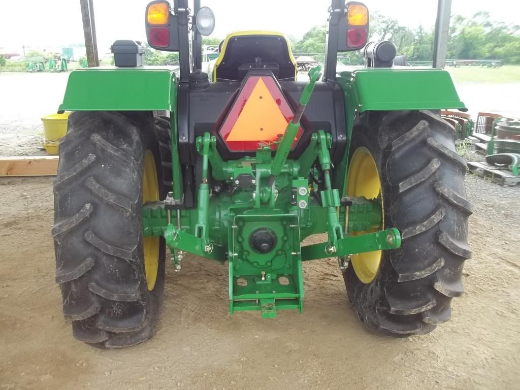

if i had as nice a set up as that i would but mine uses a metal bracket that clamps on the fitting itself and the male fitting would have slop/not fit.
and i've never seen male fittings on the back of a tractor
The fittings on the back of my tractor are female:
mine too.

Rear remotes on the tractor are usually both male. <snip>
NO, they're not. FEmale, both rear and front. That is what is usual.:confused3:
Hey PP, Get your dealer to install the high flow kit for the use of your detented rear remote so the return line goes into where the red vent is installed now in the fill port for the hydro fluid. It consists of a FEmale fitting QD and a new vent installed on the left side of where the remote stack is now. Its easy to install and if you have or get a backhoe it allows for better fluid flow and cooler fluid. Then also have him make you a loop hyd hose with two male fittings to use to prevent deadheading the hydro pump in case the detented lever gets put into A or B without you knowing with nothing attached, like a hoe or whatever.
