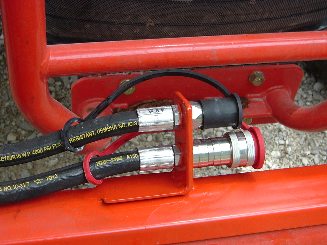

Eddie: One other thing I'd do differently next time is mount the quick connects on the TOP of the FEL cross bar instead of the bottom. When the bucket is tilted all the way back, it can contact the hoses at the quick connect. If the quick connects were on top, that wouldn't happen.
I'm gonna have the dealer make that change when I take the tractor in for the 50 hour service.

wildkat makes some decent stuff. no sure i agree on the solid plate though. it would be nice to see but brush or in your case roots coming through the opening could be a hazard. as for mounting the quick connect couplers any reason you didn't do it on one of the loader arms itself?
My Kioti dealer put a piece of light duty angle iron across the cover for the FEL lines, between the loader arms. It uses the factory bolts to hold the piece and then the QDs are attached to the angle, thus raised up a little off the crossbar. It works for my log grapple, in my avatar, and my snowplow.
I'd add a colored cable tie to one female and one male QD to make for easy hookup with no guessing to your rig.
Nice tractor and grapple!:thumbsup:
