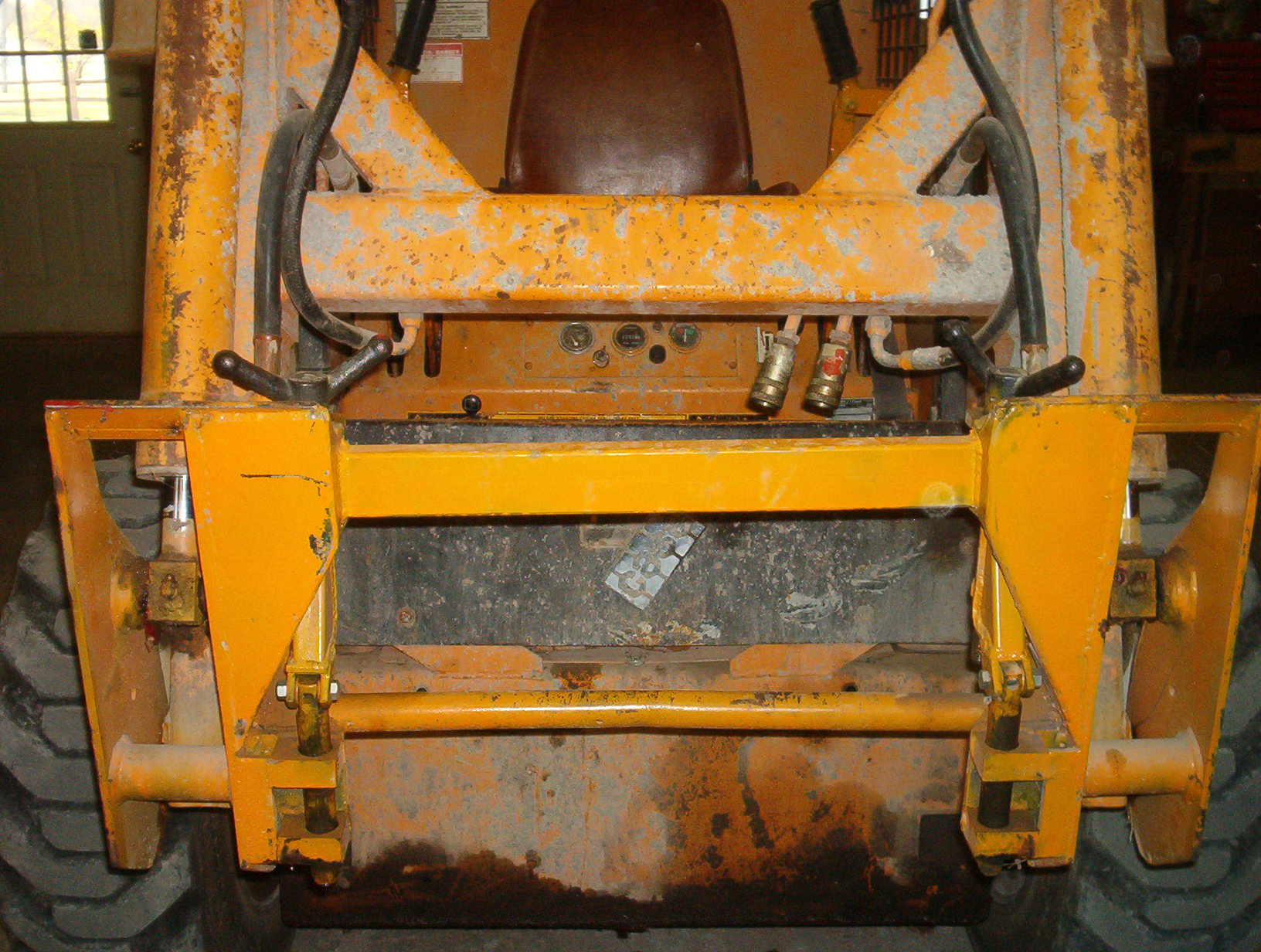

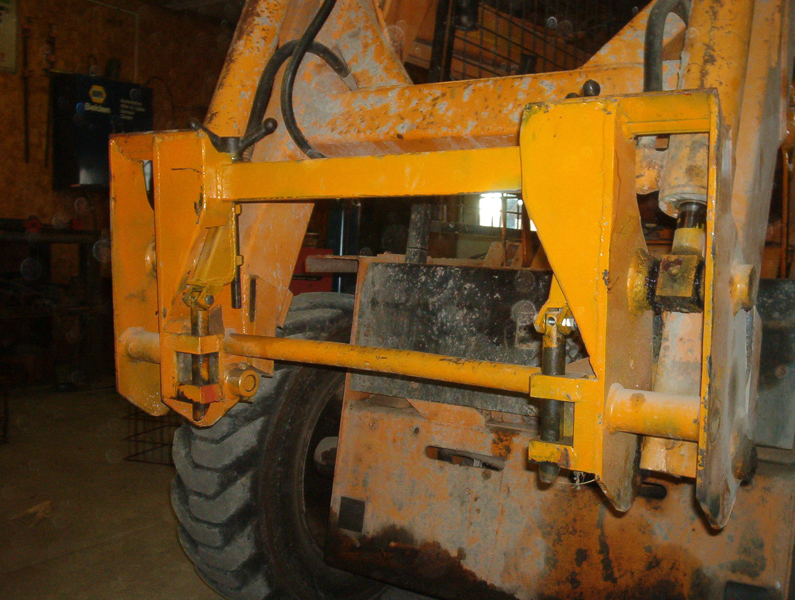

I have an actual front attach off of a skid steer that I purchased to adapt my tractor to this syatem. My wife however talked me into buying a universal mount type. It is not as heavy as the universal mount I bought but needs the pins and arms to be a workable unit. I paid 50.00 for it and would be happy to get it back.
This is the tractor side of the quick attach and would require some fabrication to mount up.
I ended up buying the pre built unit and while I definately see some manufacturer issues, I am happy with the unit. It is kinda heavy but on my 57hp international it is not as big of an issue as if I had a compact.

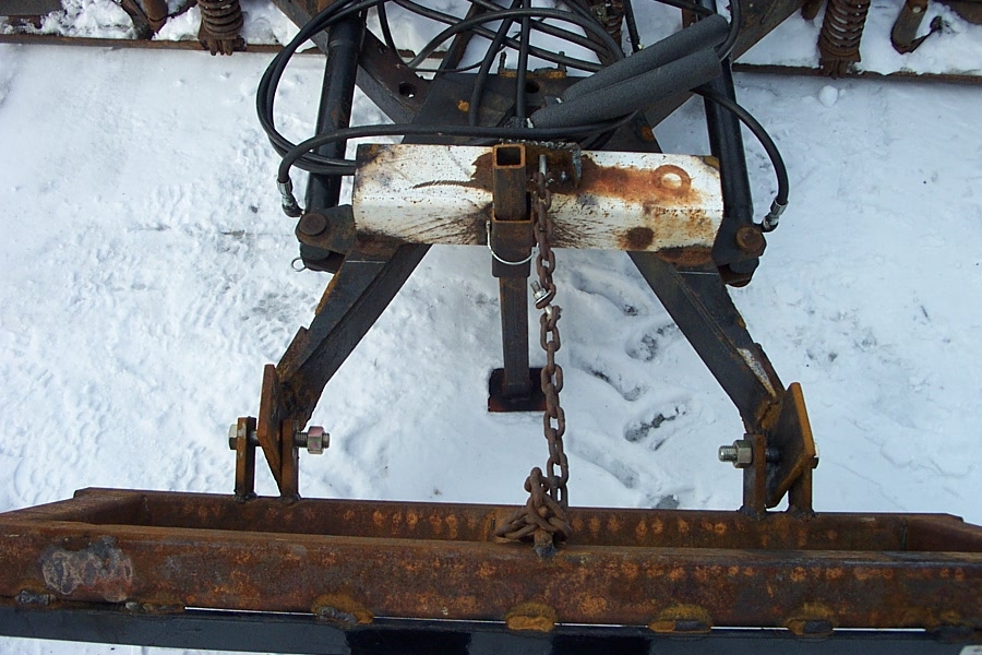

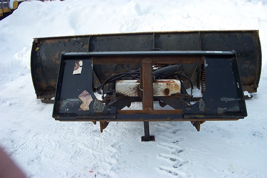

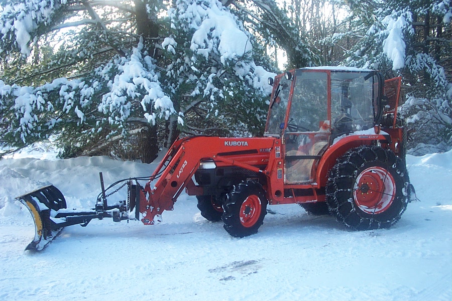

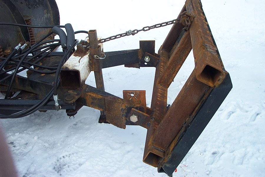

Try Horst welding. That is what I used here.
