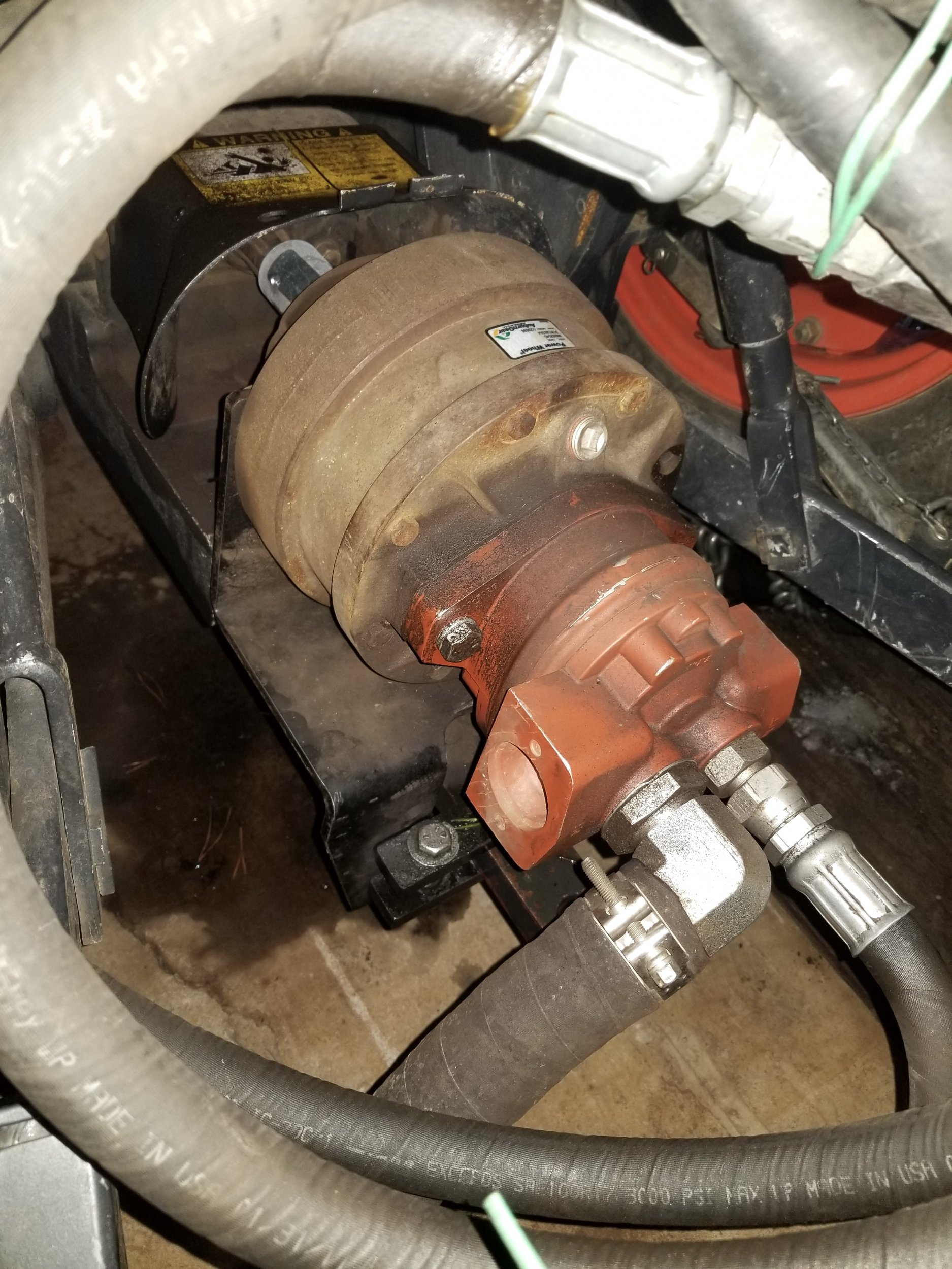

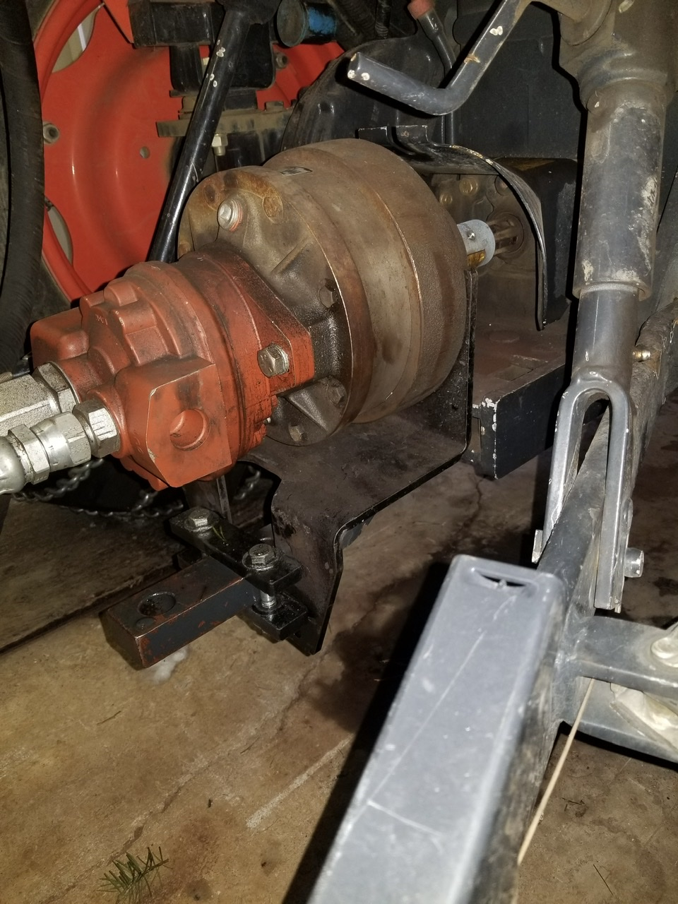

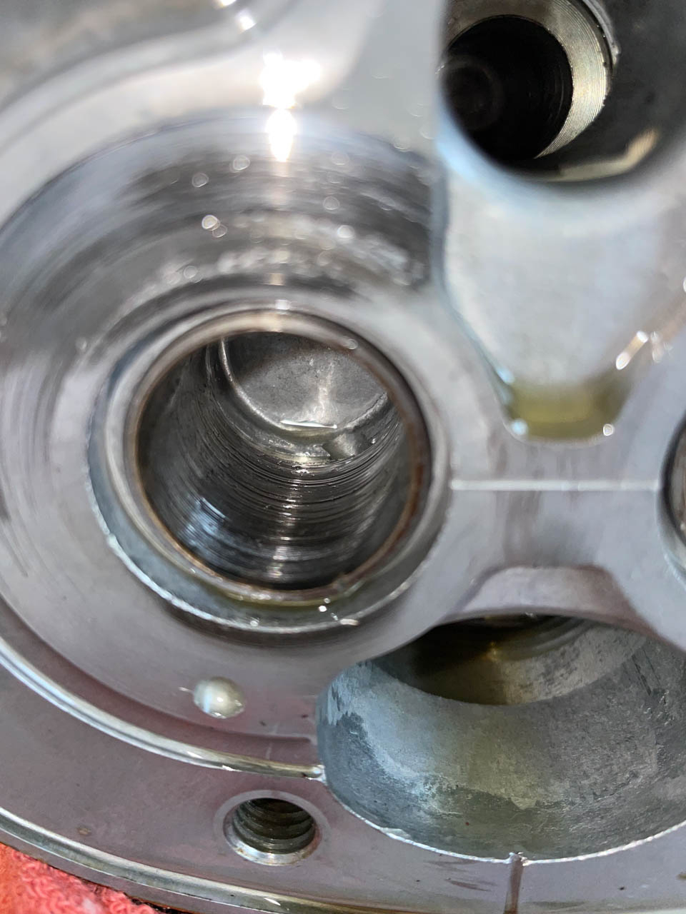

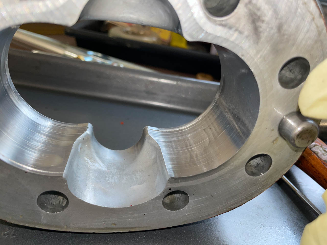

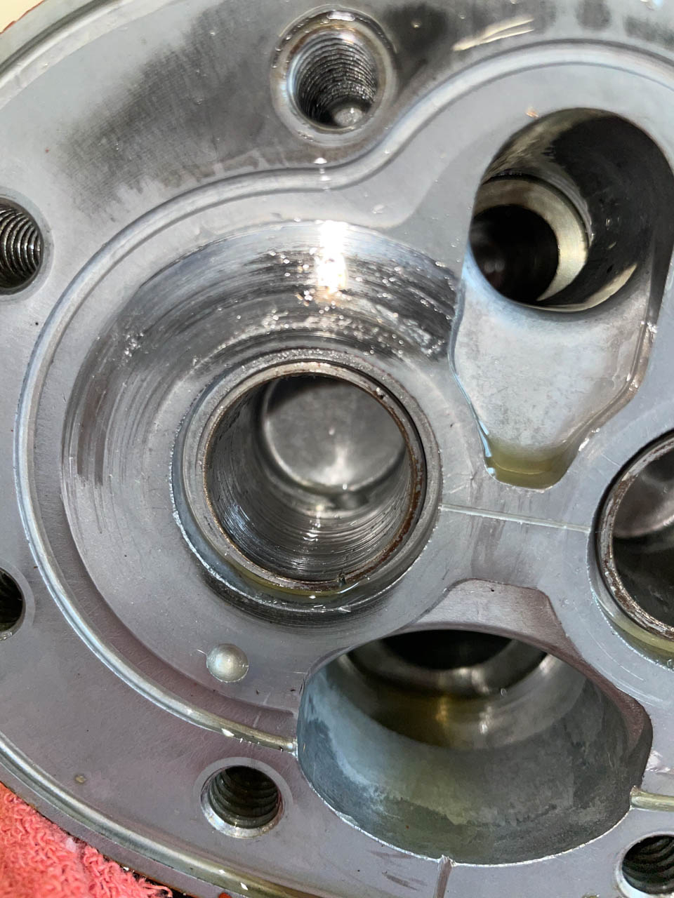

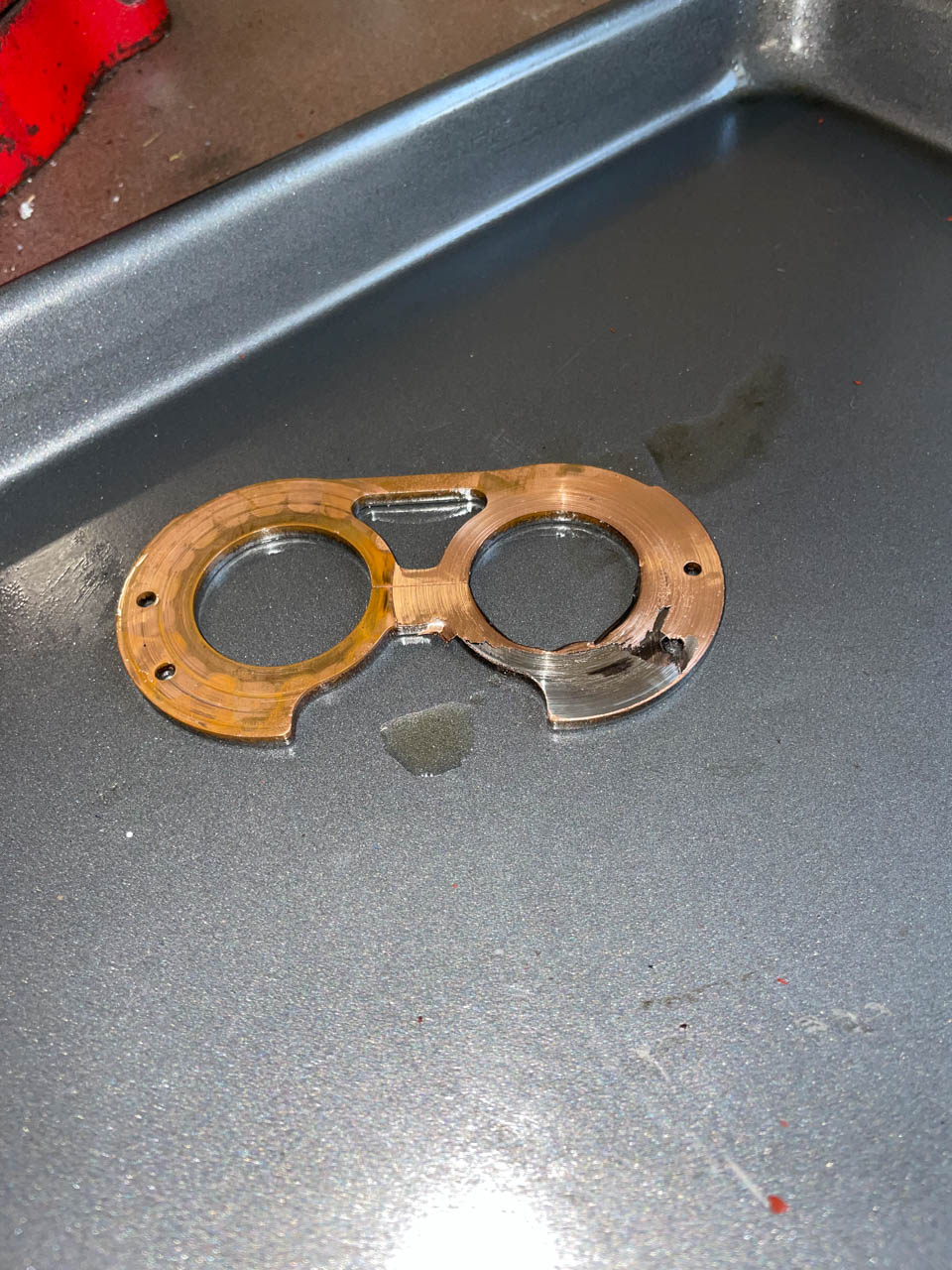

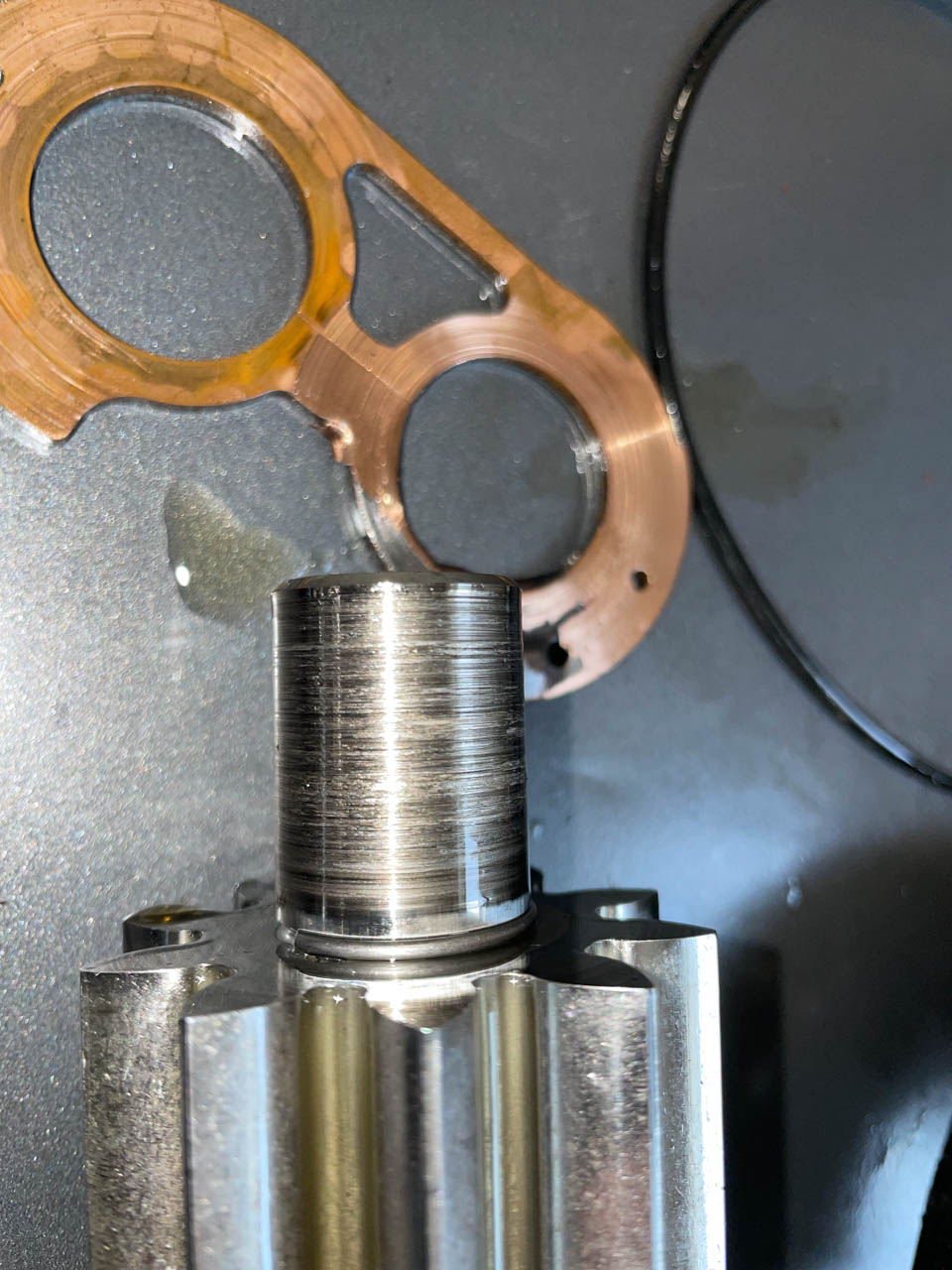

It's the pump. I hooked up my flow meter, gauge, and restrictor immediately at the outlet of the pump. With engine at idle, no load but the blower rotating, I get 10 gpm and barely detectable pressure. That's normal. But when I apply load to the pump by restricting flow, it couldn't develop more than 500 psi, even when completely dead headed.
So I pulled the pump apart and indeed it's trashed. Take a look at the attached pictures. I think teh housing it too damaged to even attempt a rebuild, so I'll be getting a new pump. Now I just need to figure out what it is. I did finally find some numbers on it and an embossed "Eaton", so with that I suspect I can figure it out.
If anyone had any pump rebuild experience, I'd be real interested in a read on what might have caused this damage. Because this power pack has no active cooling, and relies solely on ambient temp and operator attention to prevent overheating, I think overheating is a distinct possibility. So I'm particularly interested in whether this could have been caused by overheating. I guess the other possibilities are cavitation or contamination.

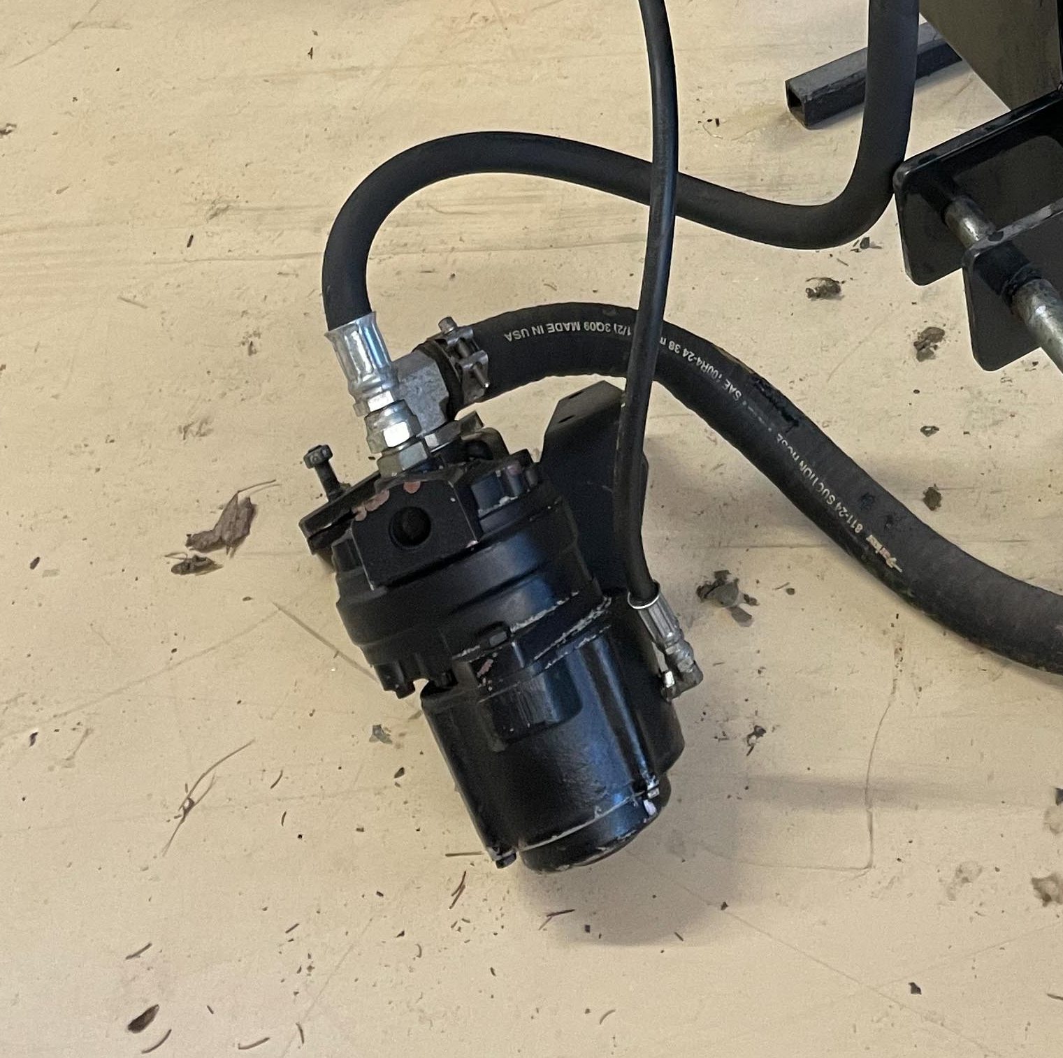

All i know is when i purchased my unit new in 2010, the original pto pump failed after 2 years use. It leaked like a sieve. I contacted quick attach and they told me they had issues with the pumps from my series and if i shipped the old one back on their dime, they would send me the updated version. That was 8 years ago and this one works flawlessly. Ill go see if i can find a brand or part number on it later today. But mine is only 15 gpm pump. And its extremely heavy

Here are a few pics pf the thing.

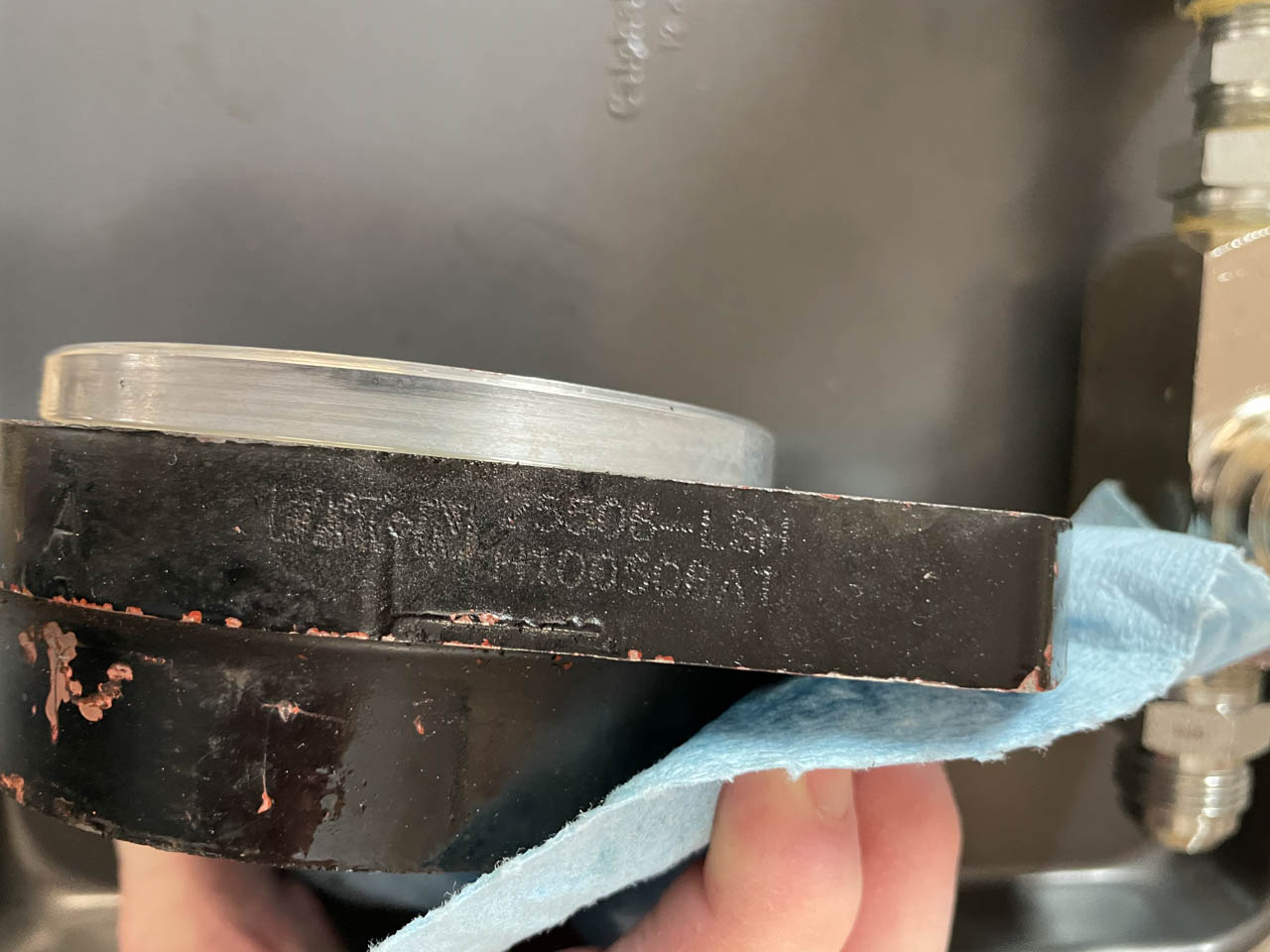

That's very interesting and might be related to the problem I have. It would be super helpful if you can get any number off your pump. Mine is an aluminum body, and perhaps they switched to a cast iron body. That would also explain the difference in weight. My pump isn't rebuildable, so if I'm replacing it, I'd like to replace with something good.
   / Skid steer snow blower on tractor loader?
#140

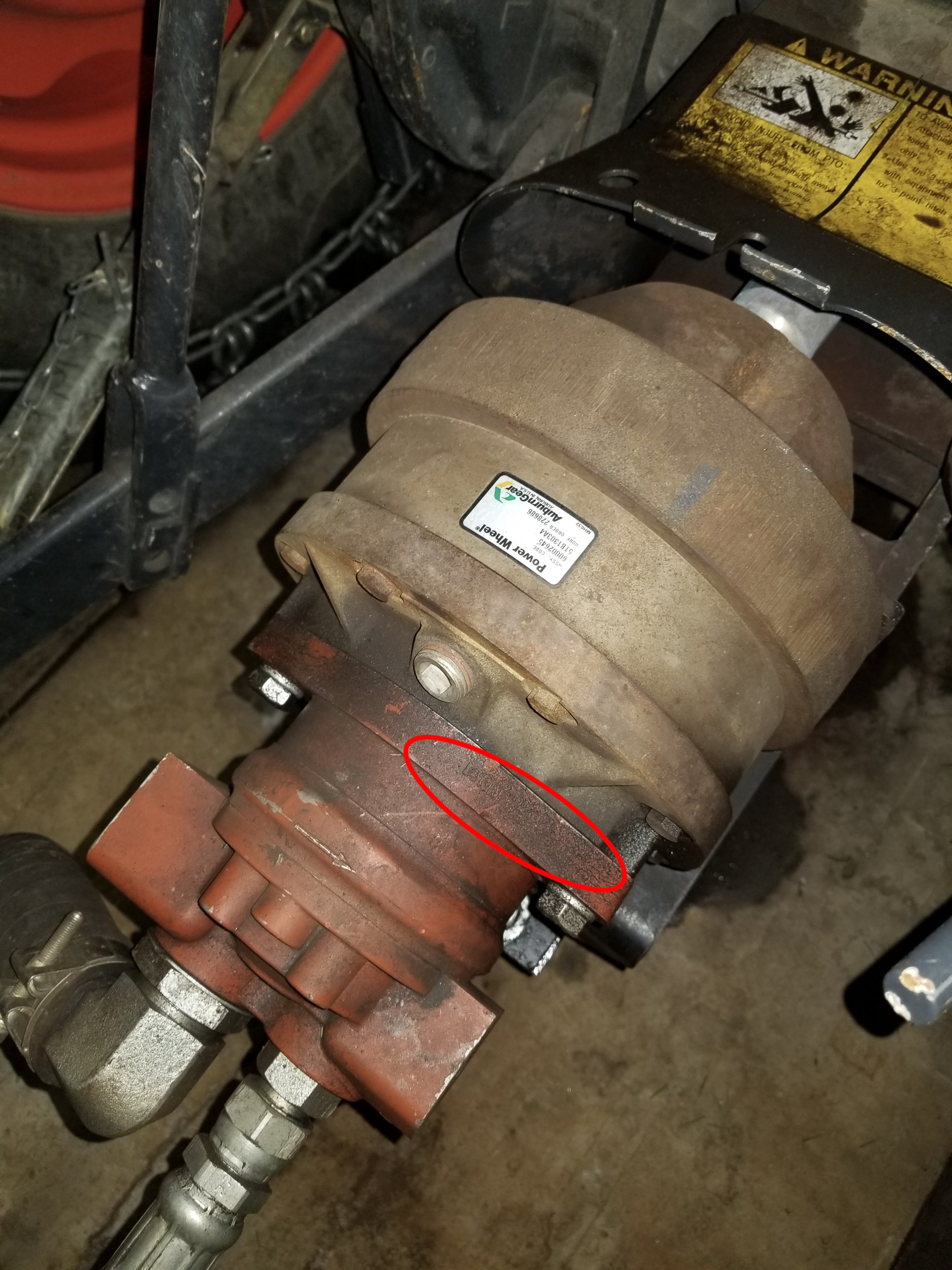

That's a different step-up gear from what I have. Did they replace just the pump, or the whole pump+step-up gear assembly?

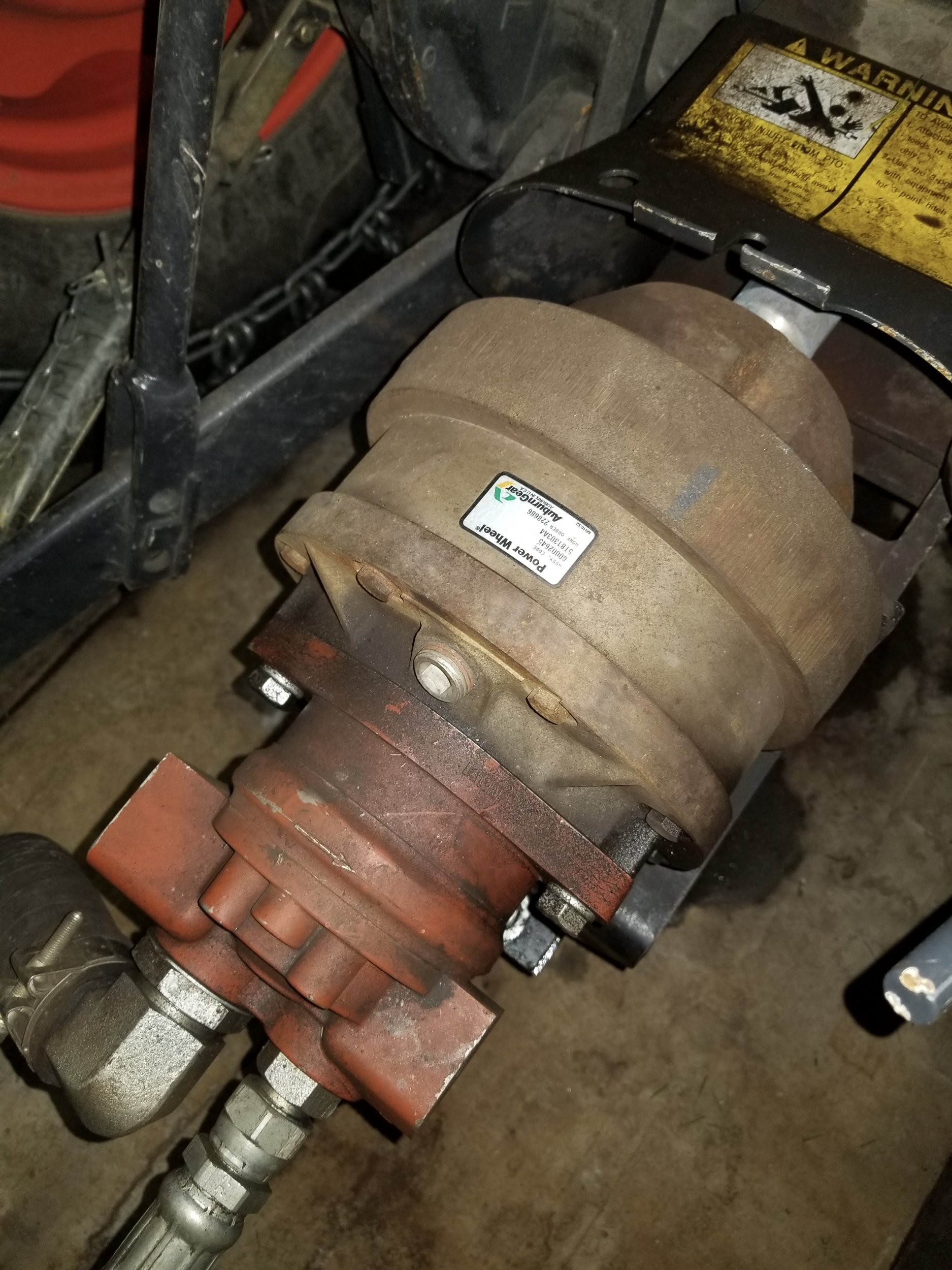

Below is a picture of my pump plus gear. Also a picture of the model number etched into the pump mounting flange, and a picture of where it would be located on your pump, except it's probably on the underside of the flange in the corresponding location. That's where mine was.
