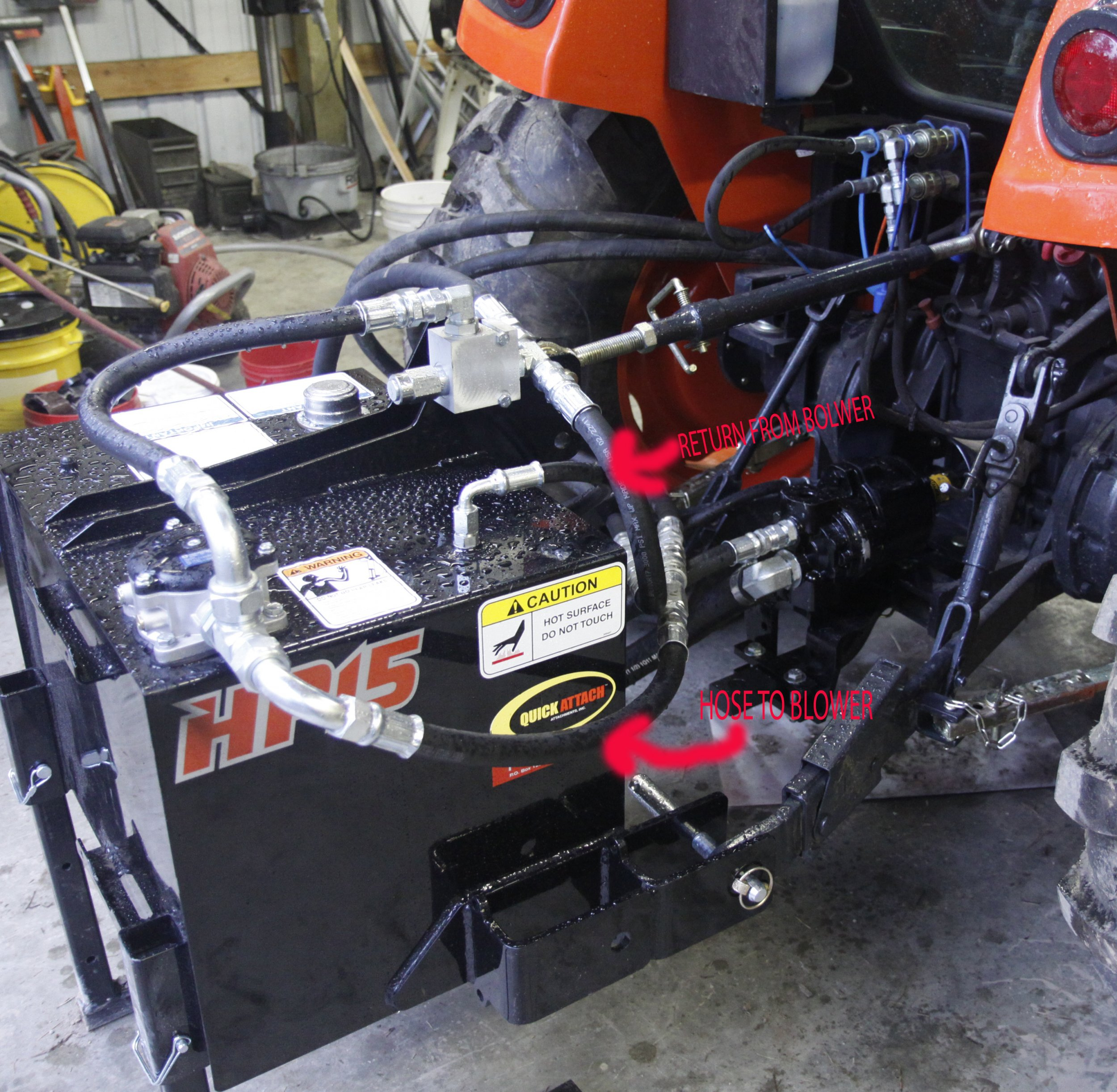

my original pump looked just like yours..heres an old pic. it had 3 hoses running into it. the new one only has 2 hoses.
they replaced entire pump system (including gear assembly). new one was at least 2x heavier than original,. no aluminum in new system.
ill go see if i can see any number. i might have to wait until i remove pump in spring if its on the underside.

   / Skid steer snow blower on tractor loader? #142
program wont let me edit for some reason. this was original pump
leaked like a sieve after a few years

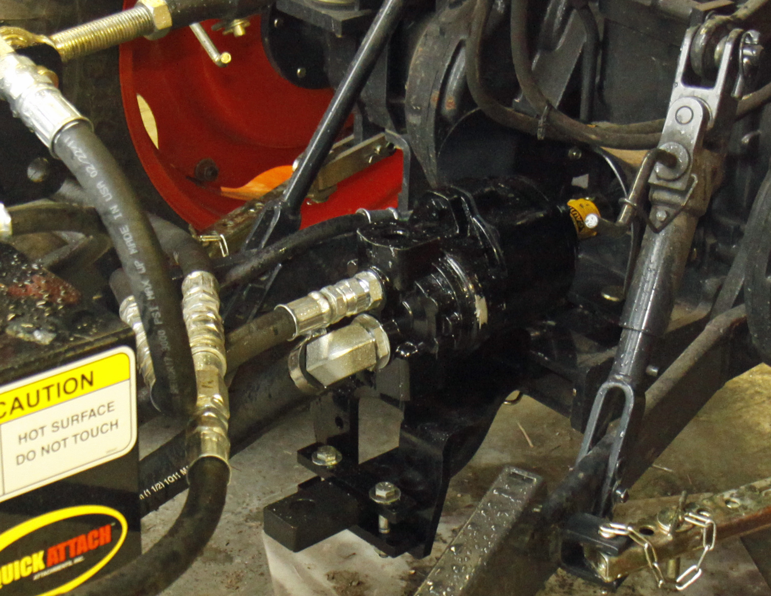

sorry, the only part number i can find is the tag shown in picture. i didnt see anything on underside.

but here is the parts list for quick attach (same as erskin as far as i can tell) powerpack . it shows parts breakdown.
That's the same as the Erskine power pack, right down to the Erskine part numbers.
One thing that's funky with mine is that the pump has a standard SAE B mount with 13 spline shaft. That much is off the shelf. However there is a gear that slides over the shaft, and that in turn engages the gears in the gear box. That spil-on gear is held in place on the spline with two circlips. The result is that the input shaft to the pump is unique with two circlip groves cut in it. So I can't just swap the pump with any SAE-B spline drive pump.
I think my first call tomorrow will be to Erskine to see what they can do/ tell me.

New pump ordered. $830. It was $1300 through Erskine.
#149
All fixed. The new pump solved the problem, and now the whole system has the power that I expected. I did a little touch-up snow blowing in advance of an expected storm tomorrow and it throws snow a long distance, and works just as expected. My test run wasn't working things very hard, and oil temp got up to 115F which is exactly the fan switch-on temp. The cooler is installed, but the fan is not yet wired up so this is without the fan running. The pump body temp was 130F. So all that seems good.
