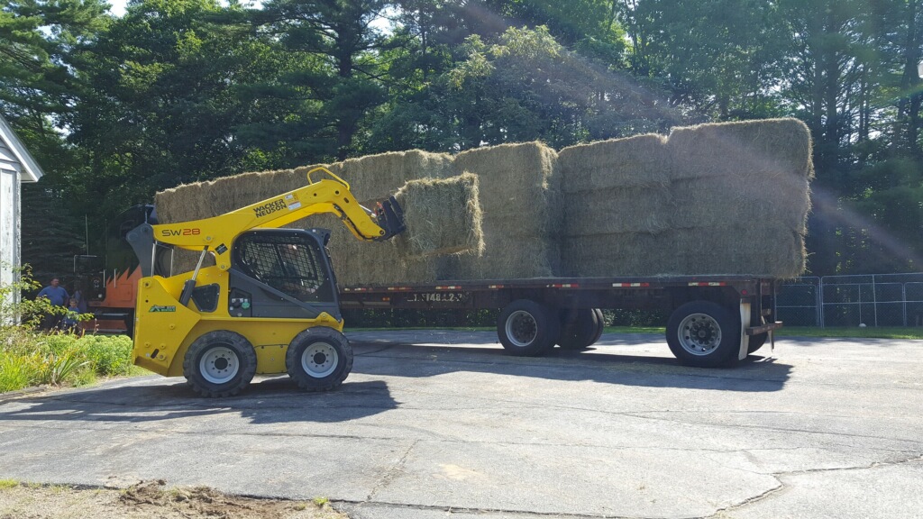

I can get one when ever i need it free my wife's work sells them ... hay.jpg
/ Skid steer vs loader tractor vs telehandler #18
/ Skid steer vs loader tractor vs telehandler #19
That wasn稚 the contest. The loader on a CTL will eat a farm tractor loader alive.
contest? A tractor loader can move 2 bales, one front, one (or more, size dependent) on rear. Of course, you could use just a trailer.
