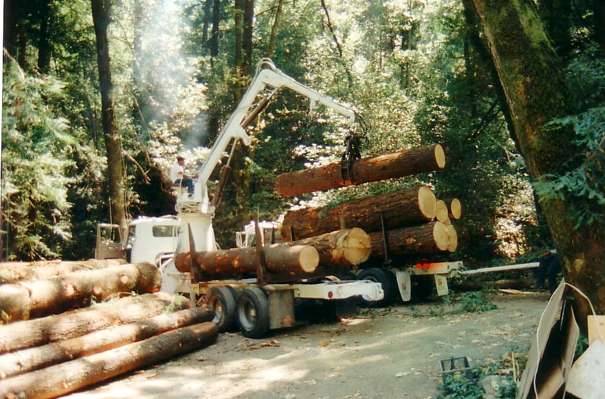

You guys have no idea how tough it was to find a logger who would take
my 18 DF trees back in the 90s. It takes some very specialized equipment
to skid and load these logs....each one weighs as much or more than
a F250 PU truck. You should have seen the skidder....THAT was impressive.
It was an articulated 4WD machine that had a giant cable winch on it. I
had to go begging just to get an company to take the logs...for FREE.
After I paid for the Forester and Timber Harvest Permit.
Here is a scan of the loader and the trucks they used. I think there was
6-8 full trucks hauled out.
I also talked to a couple of those guys with the portable mills back then.
The cost of milling DF into usable studs was very close to just buying them
from a lumber yard. Site-milled lumber is not graded, either, so you could
run afoul of your building inspector in some cases. For example, if your
floor joist design called for SEL-STR 2x12s, your inspector should not pass
a job where ungraded joists are used. AND, a site-mill requires some
way of moving the logs.

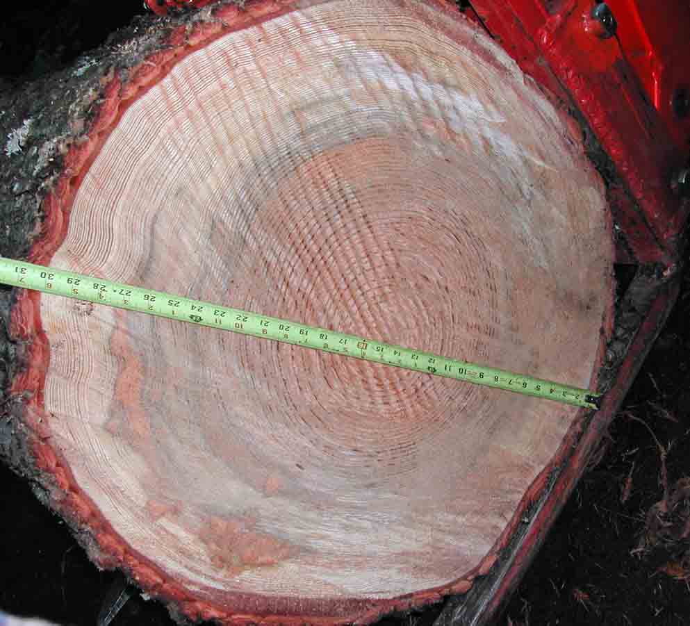

I cut a 40-inch section off the big log....it is still quite heavy as the
wood is still very green.
The cut is at 40-feet from the ground, and measures 31 inches. I
count 107 rings, but I may have missed a few. Call it 110 years old.

Nice stick of wood there!. You can see the last years were fairly dry and lean as the growth rings are so much thinner. It would have made some beautiful lumber.

that would make some nice table tops if you could dry it without it splitting/cracking... :D
