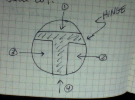

Here's a schematic of the Coos Bay cut, which can be used to take down a leaning/loaded tree without threat of barber chairing. This is out of my notebook of felling tricks:
attachment.php
Cut #1 is a slightly shallow notch or face cut (maybe 20% diameter). Cuts #2 and #3 come in from the side and can be stabilized by wedges as needed. Cut #4 is your final back cut.
The Coos Bay removes outer holding wood that acts or leverages against the central grain to create shear, and also removes much of the central grain, only leaving a hinge and small perpendicular back strap that forms a "T". You can cut away at that back strap and the tree will gradually begin to go over. There may be a mini barber-chair within the small strap, but it's been isolated to a small grain region far from the outer holding wood, so it's not of significance.
My personal experience is that the Coos Bay T is versatile given a range of tree and bar sizes you may run into, and it also slows down the final felling action for a bit more control. I even use this when cutting a downed tree with a large rootball attached, which can barber chair horizontally and/or violently swing the rootball back into the ground. With a Coos Bay, you can slowly control that cut (I'd still brace the rootball in most cases).
There is also a variation of this cut which replaces the T with an upside down triangle.
