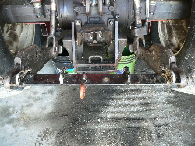

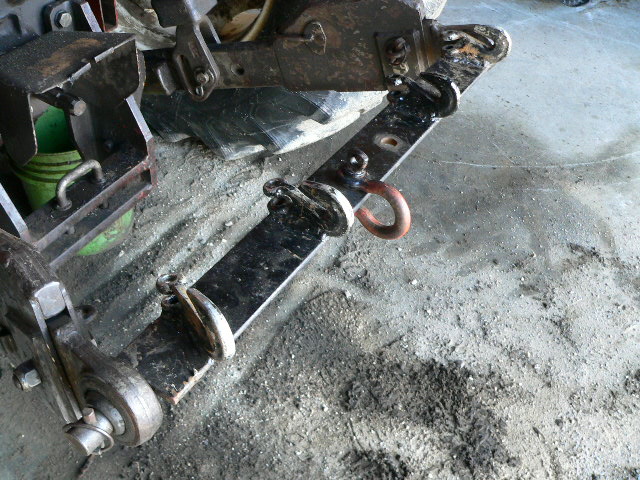

here is the rig I baked up. I use it when I have a few quick pulls to do and don't need to rig up the farmi skidding winch.

Looks pretty functional to me!
For a log skidding newb such as myself, are any 3-pt arm plates like this available retail? No welding skills or equipment here, sadly.
   / Skidding logs #73
See posts 18 and 34. You can get a cross draw bar and tractor hooks at TSC. Post 18 shows these parts and in post 34 Arrow shows the same parts mounted on his tractor. Dead Horses unit is a a little nicer in that he has welded on grab hooks to the cross draw bar instead of using pin on tractor hooks. So he gains a little height. He has also made his so it does no rotate which might make it easier when rigging up.

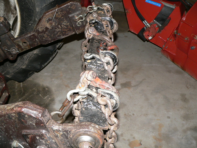

for reference here is the way the rig is lashed down so it does not rotate. This is very important in ensuring a consistent hook up and pull. keeps the chain from backing out of the hook, and keeps the bar from swing back and forth during the pull.
choker chains hook right up tight. I back the rig up to the logs, drop the bar right down on the logs, hook up tight and raise the lift enough to get the butts off the ground. Then off we go.
