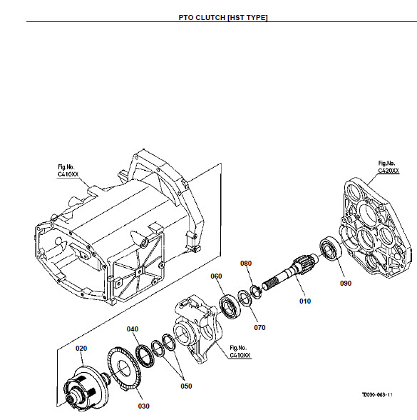

I looked up the parts diagram and there is a clutch on the PTO in the HST. There is no pedal for it, just a lever. The only clutch pedal is the master. The manual says to move the PTO lever slowly to engage it with engine at low RPM, which is how I did it. Then boost rpm as needed.

Perhaps the clutch needs adjusting? Or it was just too overloaded and was slipping? There is no info in the manual on adjusting the PTO clutch, and from the parts diagram, it appears to be deep inside the guts of the drive housings. And it sure doesn't look adjustable...
With regards to there being something wrong with the tractor, it worked fine until we tried to pull the big oak (when it stalled the PTO shaft), so we cut the tree down into a couple sections, and it pulled them out fine then. The only thing I could guess might be wrong would be the clutch is weak, but then again maybe it is doing what it is supposed to and slipping rather than stalling the engine?? (Yes, I'm new to tractors...)

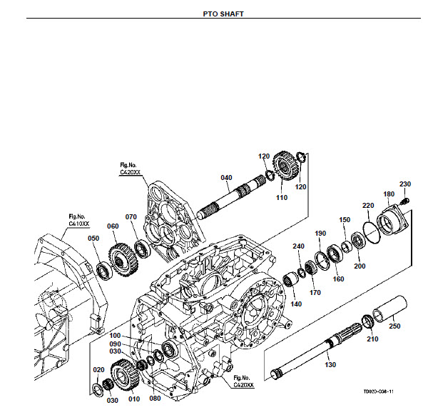

The only clutch I see is the PTO clutch #020 in the first pic. You can see the PTO output shaft #130 in the second pic:
attachment.php
attachment.php
I wonder if the OP abused the PTO somehow? I am the 3rd owner of it. Ironically the 2nd owner is the regional rep for Kubota who was a real nice guy and a straight shooter. But he only had it for a year or 2. I don't know how much PTO time he did. He used it to do major re-landscaping of his house, and after that it was too big for him to keep around. All of which made sense to me. He said the first owner was a farmer in the area.
-Dave
