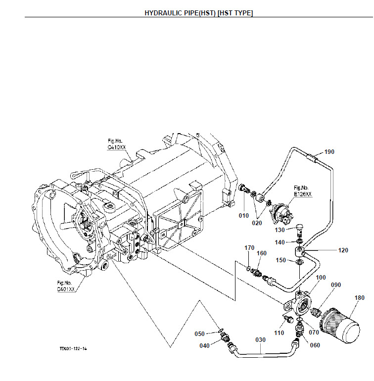

From your posted parts diagram your tractor has an independent pto, meaning it has its own clutch, in this case hydraulic. Part 20 is a hydraulic clutch pack. It runs submerged in oil and has serrated bronze clutch disks inside it - a stack of them. If it slips, it saves the rest of the power train from momentary overload. If it slips too much theoretically it wears a little - but at a much slower rate than a regular dry disk clutch. Wet clutches last indefinitely unless somebody makes a point of abusing it until it gets so hot the oil burns - nothing you will ever do. Take care, Dick B

Don't have one yet, just the parts list. I was planning to get one, but didn't think I'd need it this soon. But looking at the parts list, I'm not sure there is a relief valve.
Thanks again,
Dave
I cannot say conclusively it will have a relief valve, but it will most likely have one for the PTO circuit. That is what I would look at first, since you suspect a problem.

The PTO hydraulic supply is part of the HST circuit, as you can see in the diagram. That round valve in the middle is the PTO clutch valve (it says see Fig E126xx on it). That valve is actually on the far side of the tranny housing, which isn't clear by the illustration. I see no relief valve or anything, just a straight feed from the HST tranny filter on the left side of the tractor with hard connections everywhere. Maybe there is one somewhere else in the HST, but it sure isn't easy to find in the diagrams.
And yes, I have checked fluid levels and they are all full, and fluids are very clear. The previous owner had the dealer change fluids just 30 hrs ago or so (last fall).
I think I will check the main clutch. I think that if the main clutch was slipping it could do the same thing, but I have seen no driveability issues that might indicate it is slipping. Of course I have nothing to compare it to... But the main clutch is adjustable, whereas the PTO clutch does not appear to be. Worth checking at least...
-Dave
