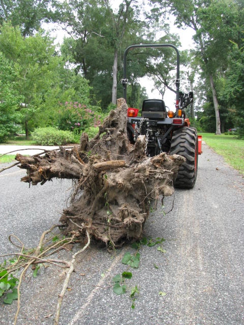

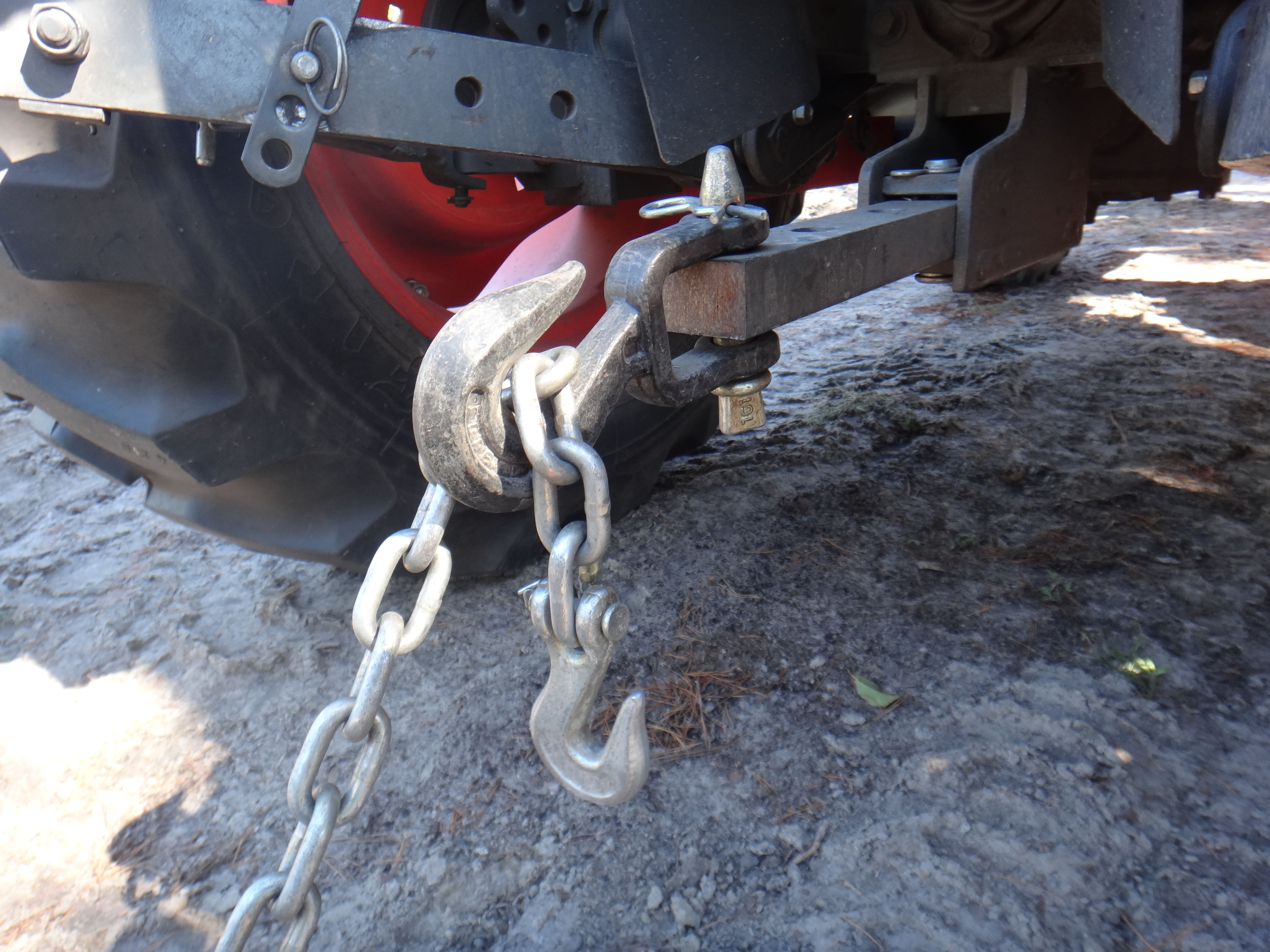

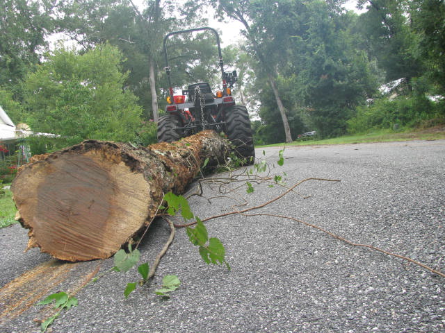

For less than $50 you can buy 20' X 5/16" of Grade 70 transport chain at Home Depot or Lowe's. This is in the HARDWARE/TOWING section, in a bag. Chain will have grab hooks on both ends. Replace one grab hook with a Grade 70 slip hook ((think CINCH)) and you are ready to drag out logs from the center drawbar on your heavy L6060.
Tractors are designed to PULL. With low, low gears, big rear wheels for mechanical advantage and 4-WD you will be able to drag 85% of your tree trunks whole, after limbing them. The heaviest 15% may require limbing then one trunk cut to reduce weight.
Use only Grade 70 chain, which is much stronger than lower grades.
5/16" chain in Grade 70 is amply strong. 3/8" is much heavier/tiring to drag around.
You will want a clevis grab hook attached to the tractor center drawbar for securing the chain "easy on/easy off" on the tractor end.
LINK: CountyLine Drawbar Hook - For Life Out Here
If this $70 investment does not prove efficient, consider buying a logging winch as Plan 'B'.
(( However, you need to consider the fragility of your cab. "With 260 ft of cable on the winch, the tractor seldom had to go off the trail." ))
I am with GRANDAD4: Keep the SCUT away from the logs. It was never meant to wrangle heavy stuff. The potential for hurting you or the equipment is too great.
Tractor in two pictures is a Kubota B3300SU/HST, 1,950 pounds, less than half the weight of an L6060.
