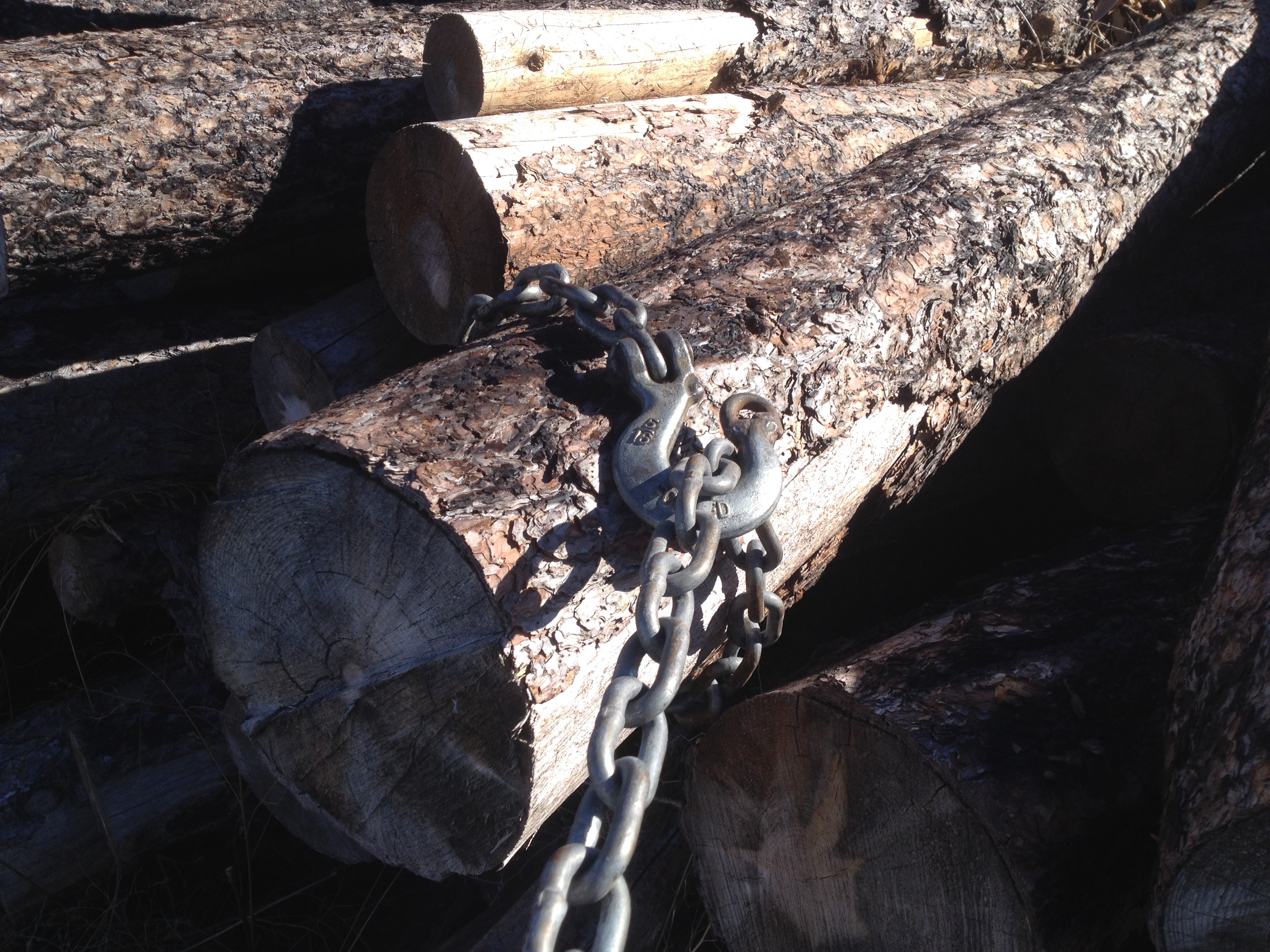

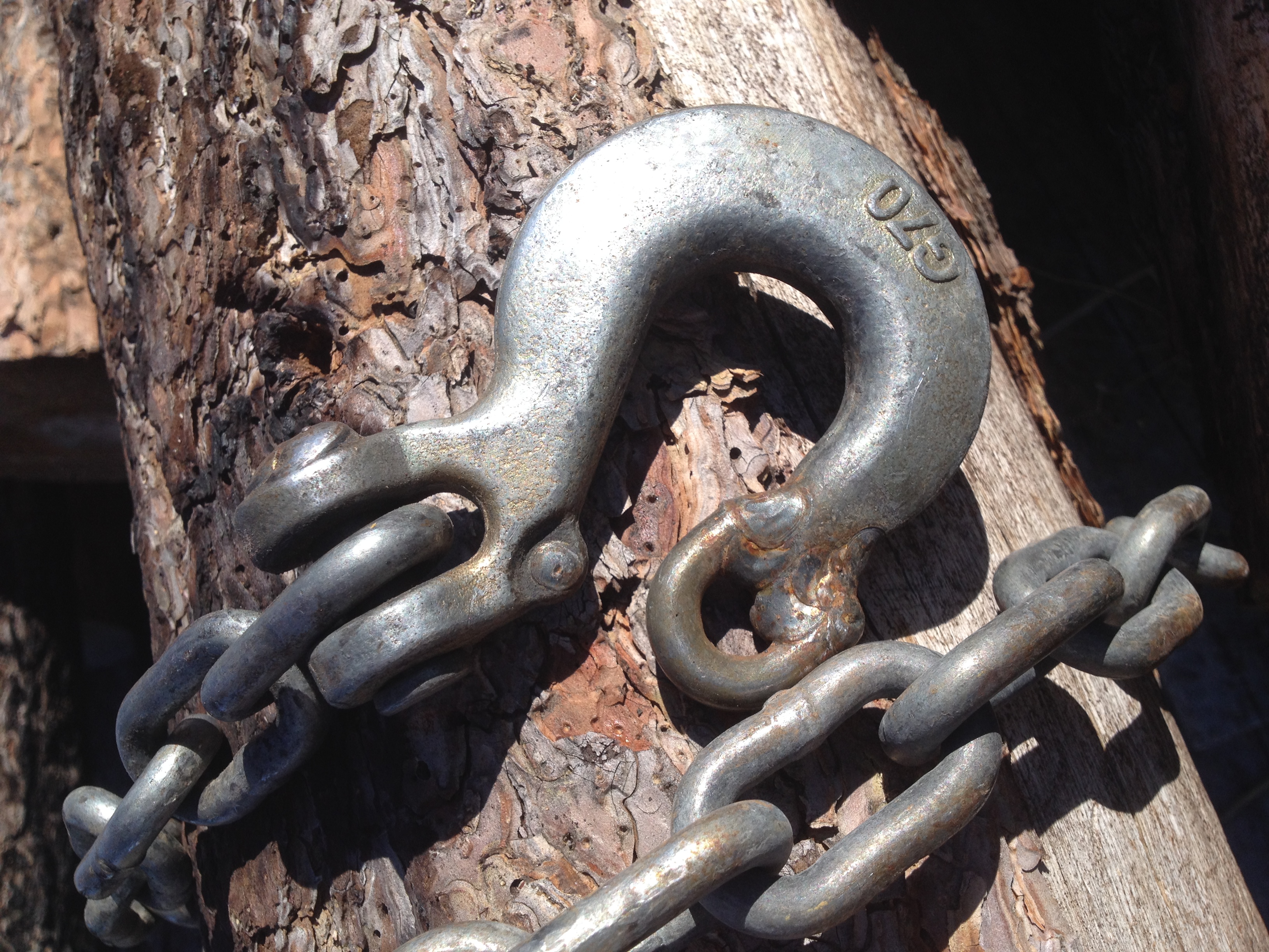

Just about every tractor store around here sells chain hooks similar to what RustyIron posted... and they do work very well.
