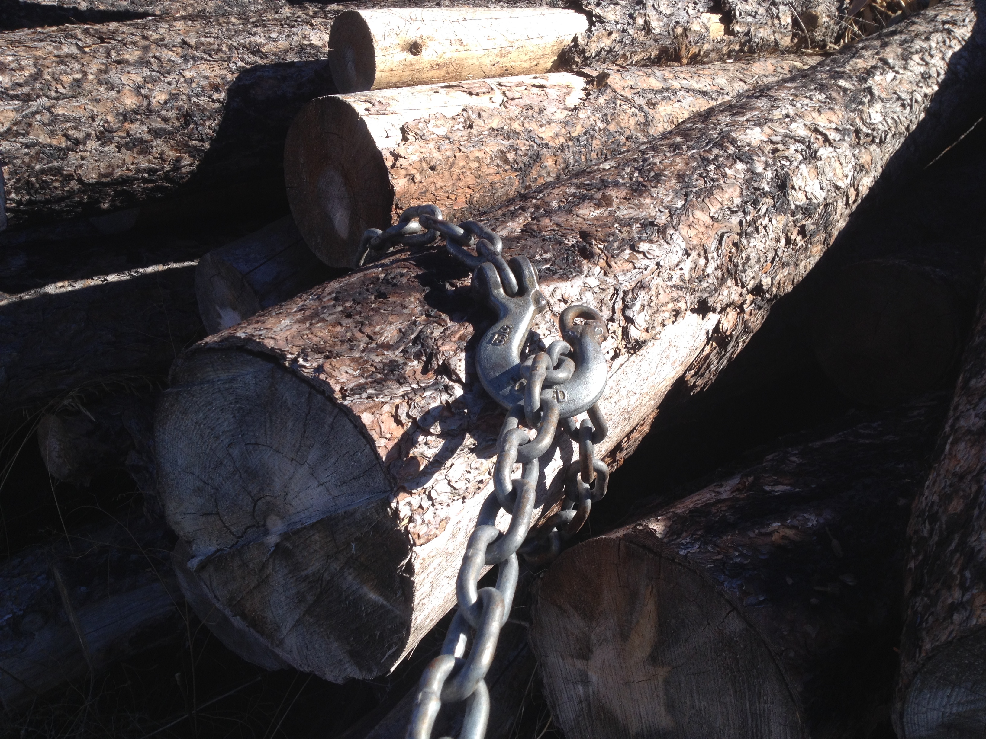

For less than $50 you can buy 20' X 5/16" of Grade 70 transport chain at Home Depot or Lowe's. This is in the HARDWARE/TOWING section, in a bag. Chain will have grab hooks on both ends. Replace one grab hook with a Grade 70 slip hook ((think CINCH)) and you are ready to drag out logs from the center drawbar on your heavy L6060.
Tractors are designed to PULL. With low, low gears, big rear wheels for mechanical advantage and 4-WD you will be able to drag 85% of your tree trunks whole, after limbing them. The heaviest 15% may require limbing then one trunk cut to reduce weight.
Use only Grade 70 chain, which is much stronger than lower grades.
5/16" chain in Grade 70 is amply strong. 3/8" is much heavier/tiring to drag around.
You will want a clevis grab hook attached to the tractor center drawbar for securing the chain "easy on/easy off" on the tractor end.

I have found that modifying a slip hook makes them work even better for this application I use half links to narrow the opening so the chain just barely fits in sideways.
IMG_1739.jpg.

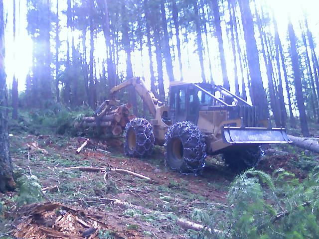

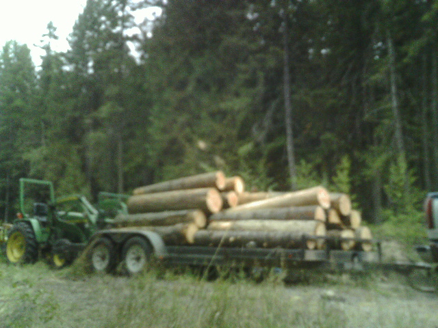

Skid to a 'landing' from out of the woods on what we call around here 'skid trails' then ether load short logs and haul home or make logs into firewood right then and there, depending on time or situations. Right now i have a small deck of logs in the back yard waiting to be bucked into firewood...
Helps I was a logging contract operator for years, did just this for a living:D
I would really like to get a skid winch for the 790 also, but I manage just with chains and chokers just fine with the 790 in my own stand timber:D
