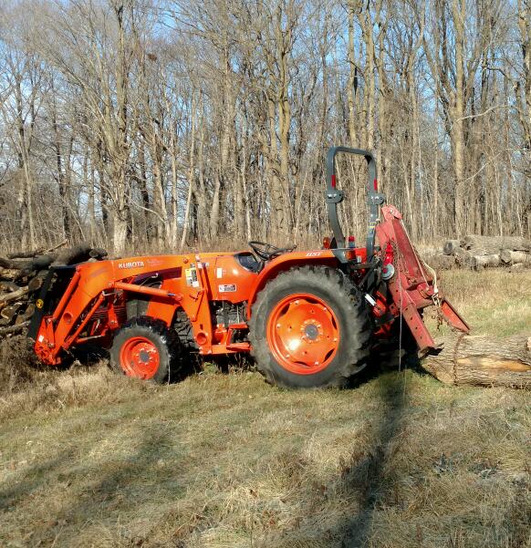

Oldpath, what's the winch mounted up behind your head for?

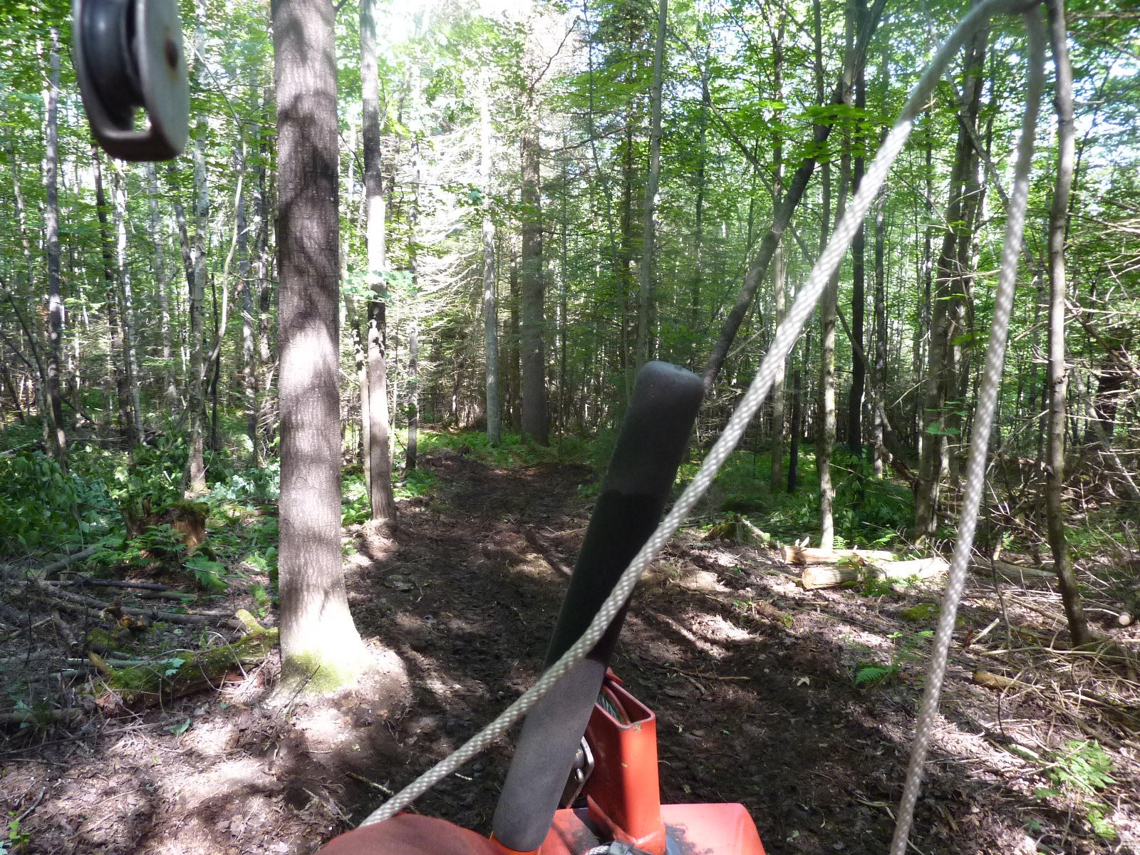

You have a good eye for details, I didn't think that winch could be noticed. My L3400 doesn't have enough 3 point lift power IMO. 12" log is about max. So to increase lift power without the hydraulic wine, I added a $300.00 9000# winch, it adds another function, but it lifts.
To let the pto winch down, 1st I let the 3 point arms down, then I have the DC winch remote above my head, press the down button till the 3 point pto winch is all the way down, then unwind a little more. When I hook up, have to make sure there is slack in the DC winch cable so when the pto winch start to pull, it lets it dig in the ground, stops the tractor from rolling back over my foot, over the saw, over the gas can, over the cliff.

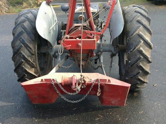

This was a much later design, made by what became Igland. The base for the first 3pt winch from Sandvik/Norse/Igland.
Love seeing these picture of old winches winches and tractors with the info, they must be around 50 years old thanks. Have you used some of these, now I'll look up Igland winches.
   / Skidding Winches #156
No, but they are very popular among hobby wood hunters with old tractors.
Exept from the rubber wheel model this equipment was made for commercial logging and was of high quality.
I own one of those with rubber wheel but it's not complete, all I have are 3pt winches.

I missed that little overhead winch. OldPath being able to pick a 12" log max with your 3ph and winch must mean your winch is really really heavy or something else isn't quite right ??? You have a clever work-around though.

I do think my 3 point is a little bit on the week side, but that's ok, that #9000 Northern Tool winch is on the strong side, plenty of power. The Fransgard winch is listed at 385 lbs. I added on the protective screen + 5 chains + sliders, so it must be around 400 lbs. Maybe the log max is around 16"-18", I'll have to do a measurement sometime.

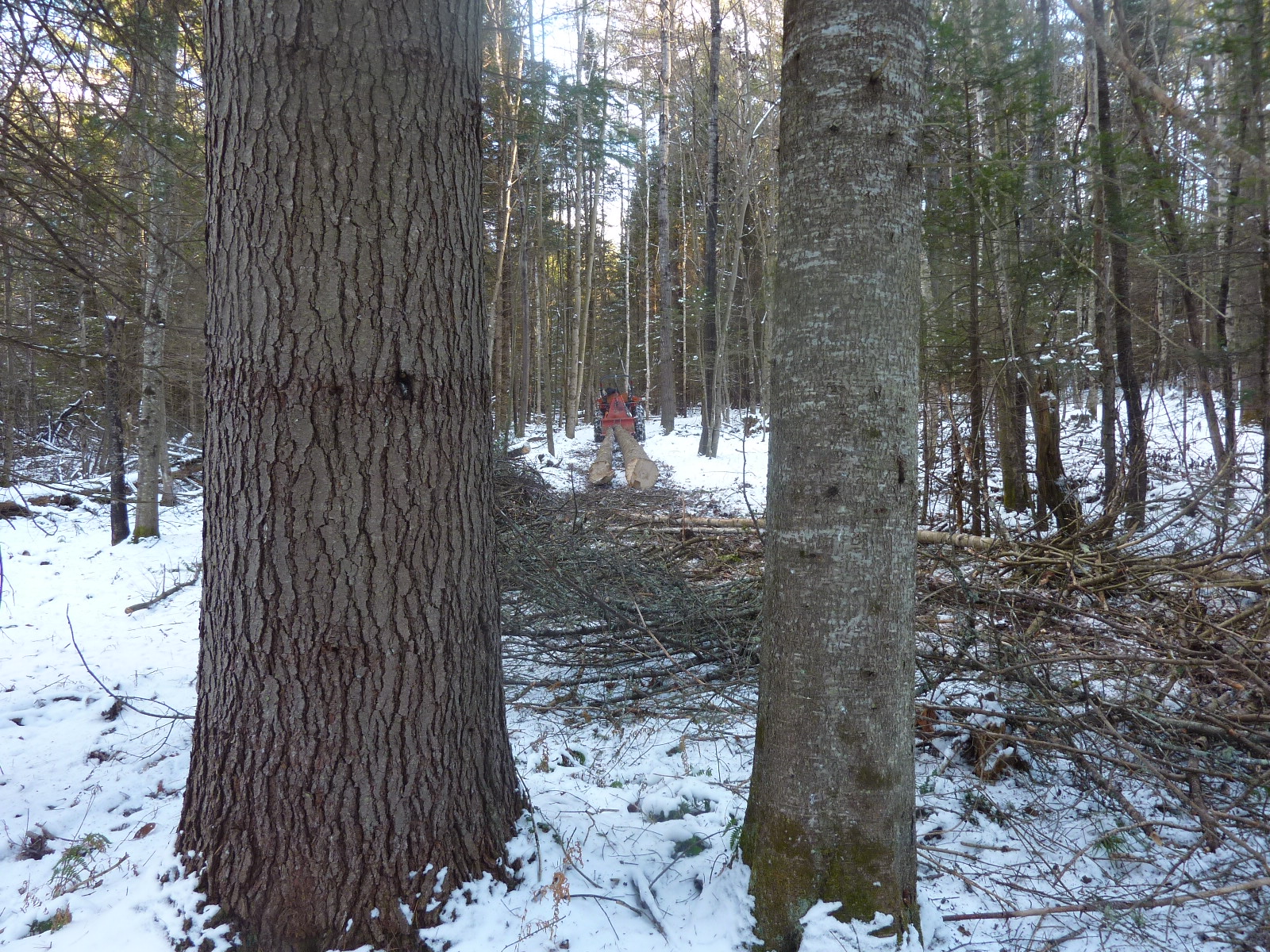

A thinning job I did last year with my winch. I put in a dead end tractor road last July while it was relatively dry. I thinned the area in the picture behind the tractor.
I cut in late December after the ground was frozen.
This is what it looks like now. I took this yesterday morning.
