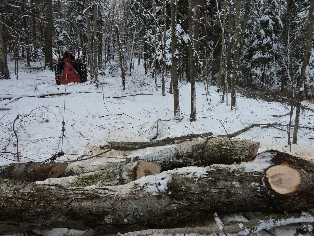

Here is an example picture of a potentially bad slider hook up. If that branch where the cable makes a sharp turn was heavy pulling the cable thru that angle with a lot of tension on it would curl it.
gg
