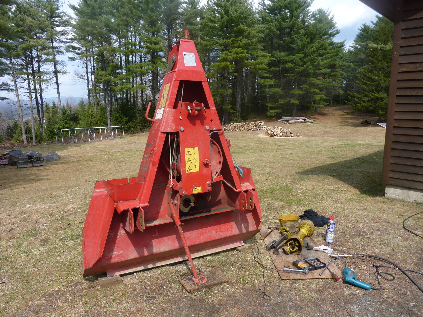

Found a winch for my new to me M5640. It is a well used 2003 Farmi JL501. The splines on the tractor end of the pto shaft were mangled like it spun off the tractor pto during a hard pull and the yoke on the winch end was jammed into the winch. I replaced the mangled yoke on the tractor end and pulled the jammed shaft off of the winch and now every think works as it should. Pulls like a banchi. The clutch has never been adjusted. The original marks across the adjusting nut and shaft are still aliened and the paint there is in tact. It could use a new roller chain - it is a little loose and the adjustment is maxed out. Other than that A-OK. You can't beat a Farmi.

Wow Gordon, nice find!! How sweet to have two different sized tractors both set up with nicely matched winches.
I'm not sure exactly why it reminds me of this, but it's a bit like those bumper stickers that say "my other car is a Porsche". Makes me want a Porsche so i can put a sticker on it that says "my other car is also a Porsche".
To be honest though, Id much rather have your two tractors than a sports car.
