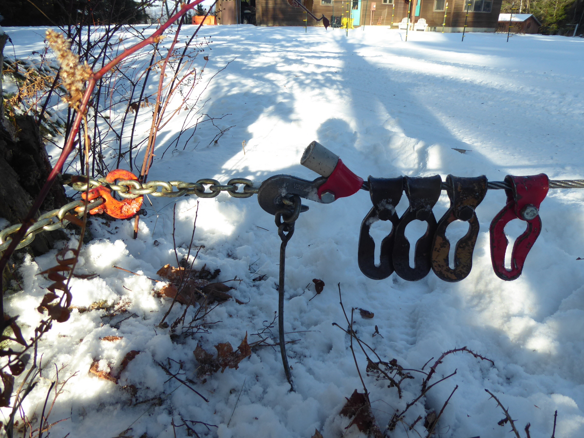

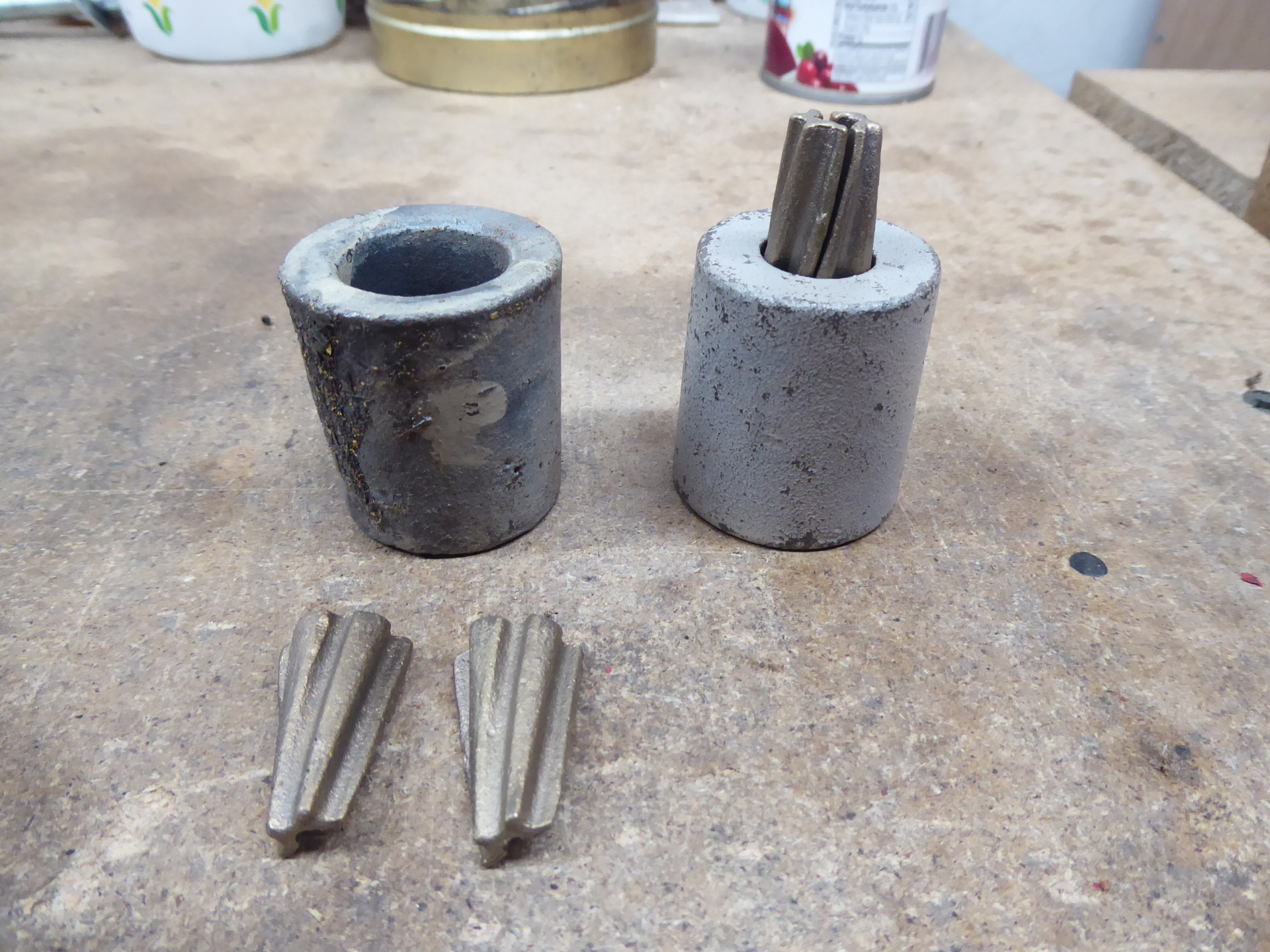

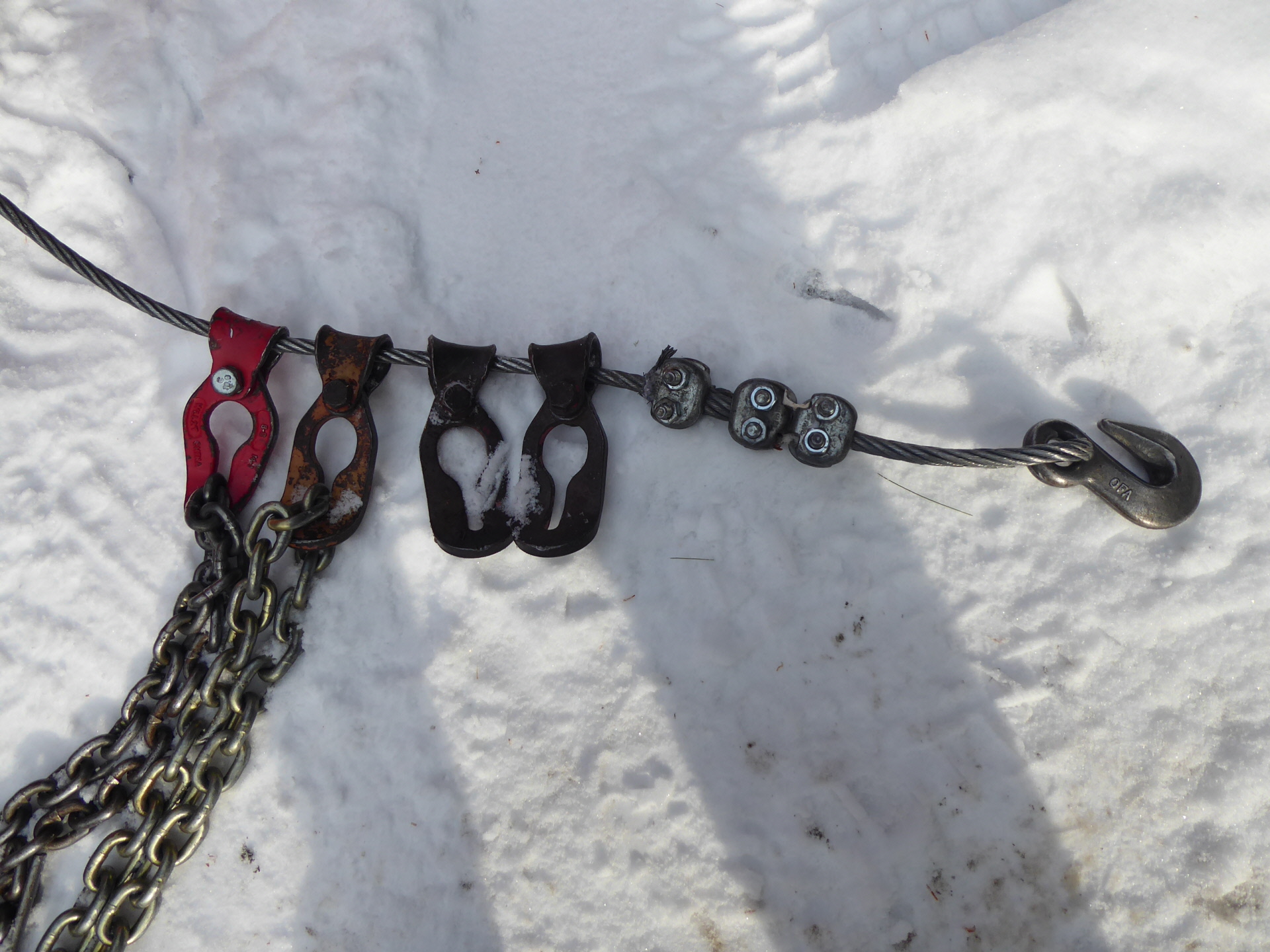

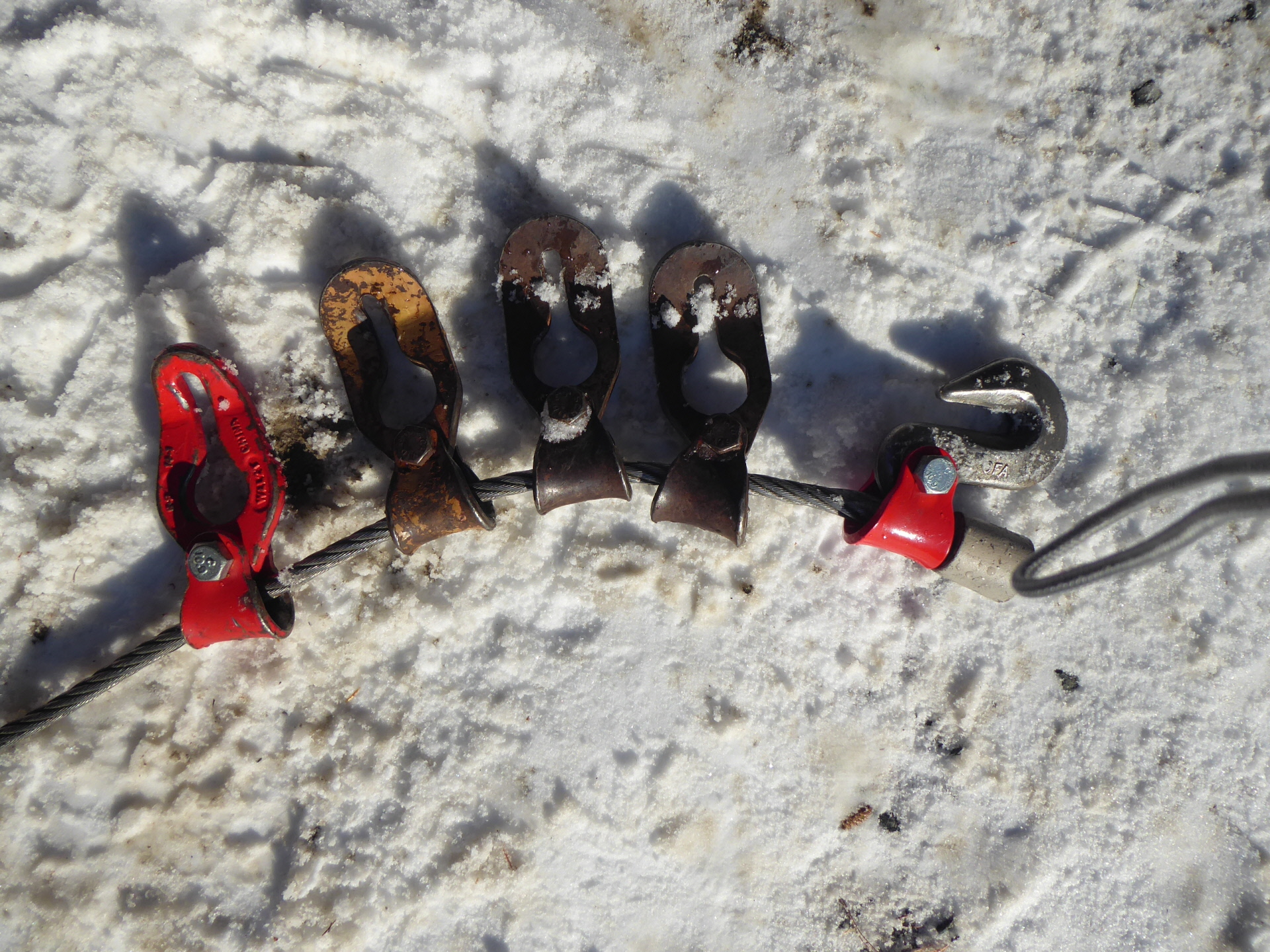

I have been unhappy with the 3 clamps and hook on the end of my winch cable. It is stiff and often in the way. I always put the first log on the top (red) slider and then the next log on the second slider, and on down the line. That way I can always repull the cable to hook the next log. Most times the hook is unused. That leaves a stiff section of cable with 3 clamps and a hook sticking out into the hitch. Sometimes it gets buried in the middle of the hitch, or hooks onto a choker during the skid out and it's a pita to undo when I get to the landing. Or if I use the hook that log is not held in tight and even with the rest and hangs low.
So I cleaned up the cable end up by replacing the 3 clamps with a ferrule type end button and putting the hook on a 5th slider. I think I will like it better - time will tell.
I hooked up to a stump and pulled hard enough to move the tractor a foot with brakes set and ice chains on all four tires. It held.
I am running 1/2" cable. The smallest quick ferrule I found was for 7/16" to 9/16" cable.

1/2" cable is bigger then mine, I have 8mm. I took my hook off, it was always catching weeds and sticks so I just have a loop at that the end secured with cable clamps.
   / Skidding Winches #306
That's considered a no no… You can see in your picts. why...
It kinks the cable every time you pull a single load, single loads should always be hooked to the very end, so it doesn't continually kink the cable.

Your comment is not w/o merit however I would call that a bend not a kink. A mild bend comparable to going over a pulley. The sliders have a radius to them to minimize cable kink. Anyway in my thinking, life is full of trade offs. The end of the cable has to be redone periodically no matter what you do if you run sliders. If I have three or four trees down up in the woods that will make up a hitch, such that I have to run the cable up thru the trees using different paths for each one, I hook the first one onto the top slider and pull it to the tractor. Then I grab the cable and pull it to the second tree. Then winch that one back. Etc. When they are all pulled in to the tractor I set the brake, lift the winch, and take off. To me the ease and convenience of working that way far outweighs worrying about weather my cable is perfectly straight. It took me about a half hour to put that end on and it is reusable. This is a logging cable not an overhead high-rise construction crane cable. Just The way I think and the trade off I am willing to make. You may not agree.
EDIT: Take a look at the new Wallensteins. They have knob ends and sliders just like most cable skidders which is where I got the idea.
