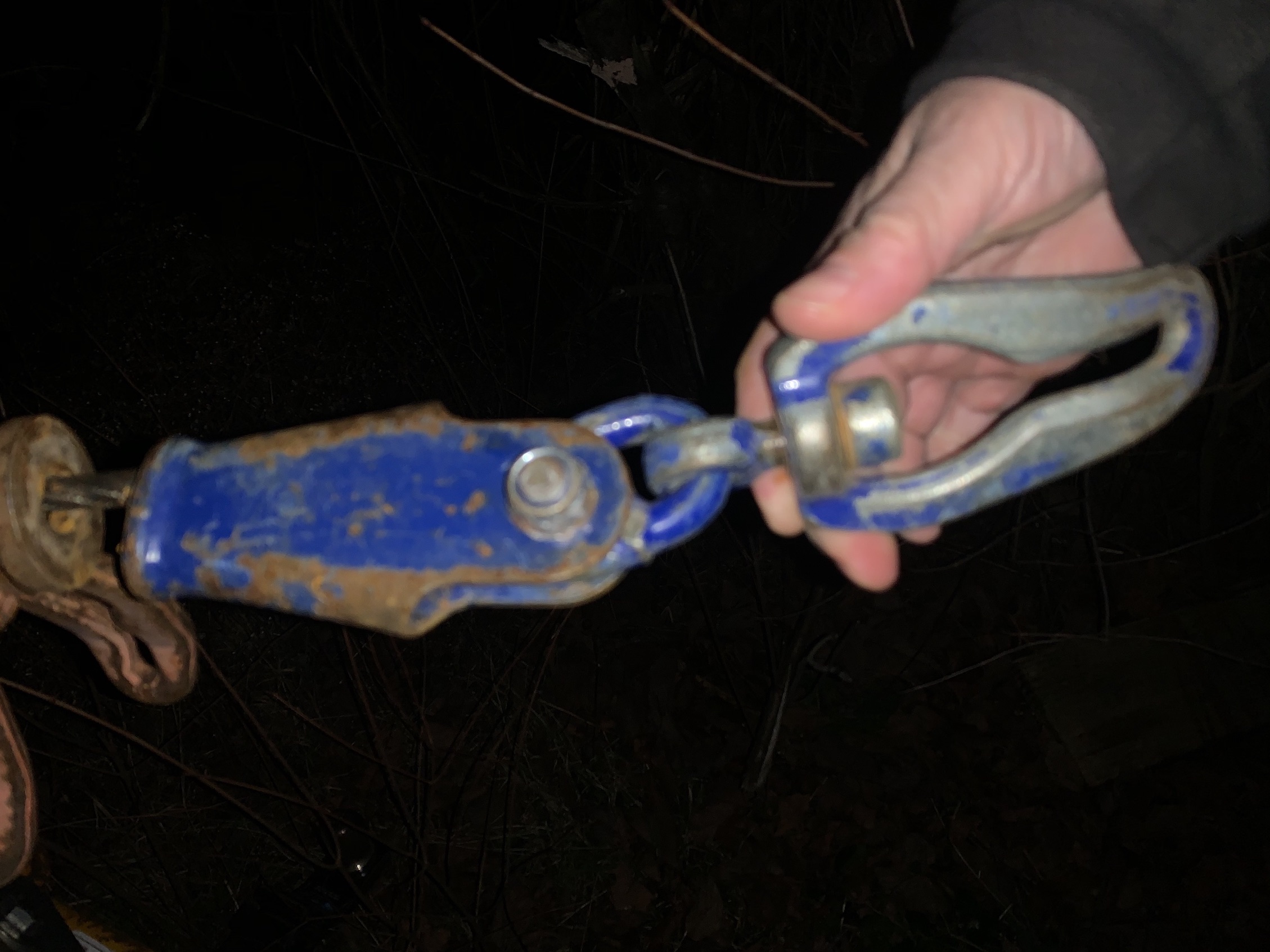

There is a wedge in the body. Cable runs up through the body, over the top of the wedge and back down the other side (the cable end remains just barely inside the body, so no ends to get poked by). I have a grab hook on a short chain I can put through the keyhole when I need a hook for something, but I don't use it much. I could attach the chain from the grab hook directly onto the clamp body, replacing the keyhole/swivel, but I'd lose the swivel action if I did that. I do like that swivel action: it helps keep the cable from twisting up if I'm winching a log on a side-hill and ir rolls down the hill a bit.

There is a wedge in the body. Cable runs up through the body, over the top of the wedge and back down the other side (the cable end remains just barely inside the body, so no ends to get poked by)..
There's a few different kinds of those wedge blocks, here's one of them,

But that one looks like it might have a bite to it if grab wrong, I already get blanked off enough...............

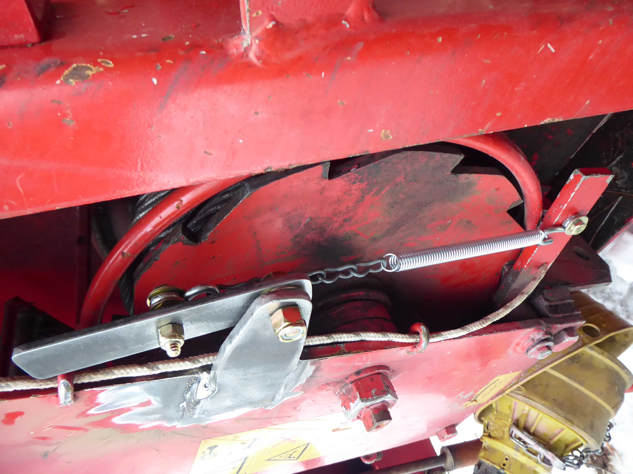

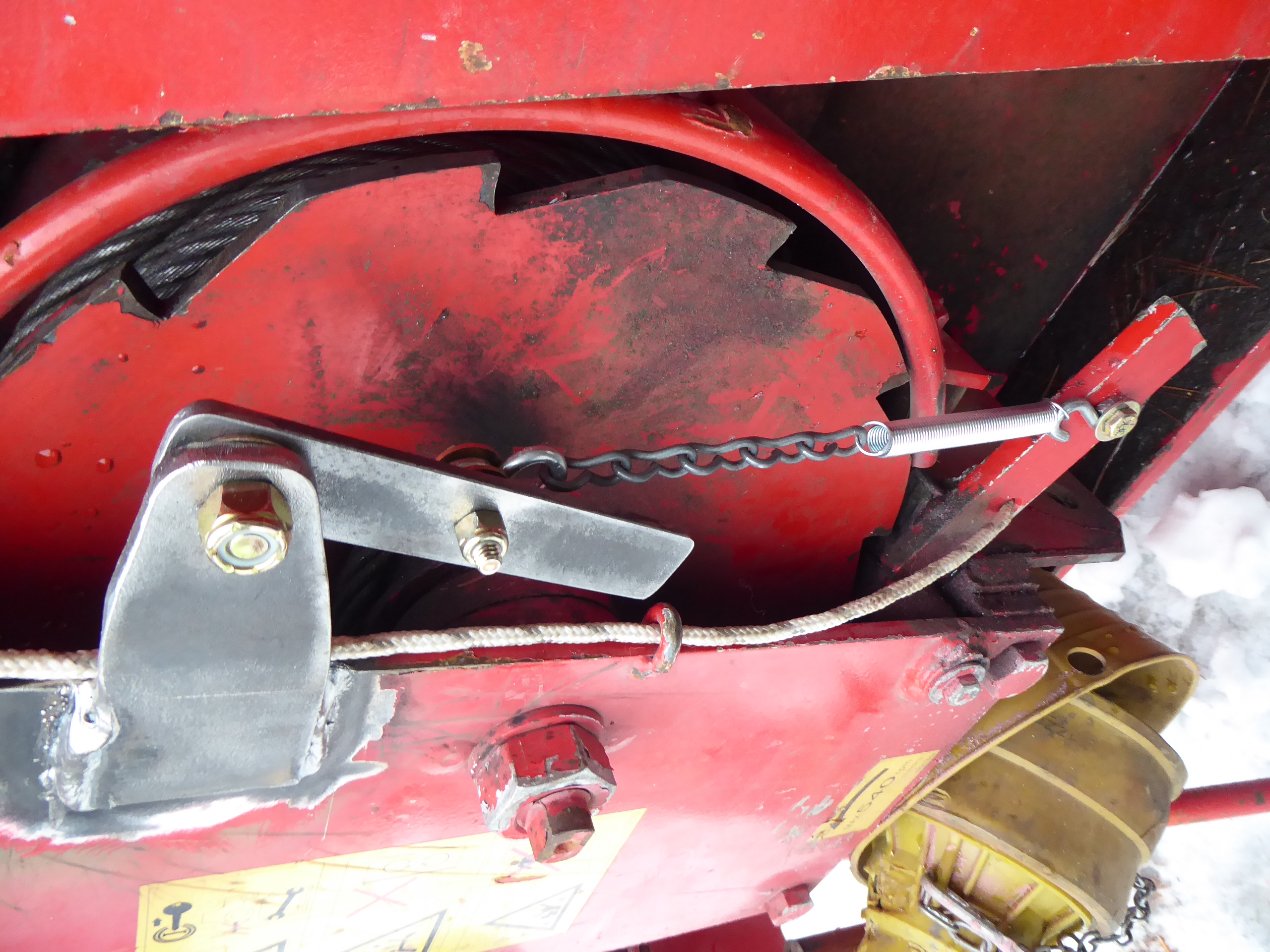

When I am trying to set the rope operated brake on my Farmi winch I often wish I had three hands. One for the brake rope, one for the clutch rope, and one to guide the cable, hitch, or something else. Or sometimes it just feels like a clumsy operation because of the position you have to be in. I made it easier today by adding a lever and spring. With the lever down the pawl brake operates manually with the rope like before. With the lever flipped up a spring holds the pawl engaged so there is no need to pull the rope. As soon as you stop winching in the brake is applied. Makes a good safety for holding the brake on when the cable has no weight on it too.
gg
That’s really cool. Patent it and sell it to the Big Guys, they can sell it as an option.
I can see it being really handy when winching / falling a standing tree that you trying to ensure falls in the intended direction.
It’s always hard to balance pulling just enough vs. too hard, with the timing of the cut, movement of the tree. You definitely don’t want someone to release the tension at the wrong time before they can pull the “other rope”.
One rope operation would definitely be handy when the selection (and experience) of winch operators is “limited” (aka: “the wife”)
(Bluetooth headsets would help too.)
