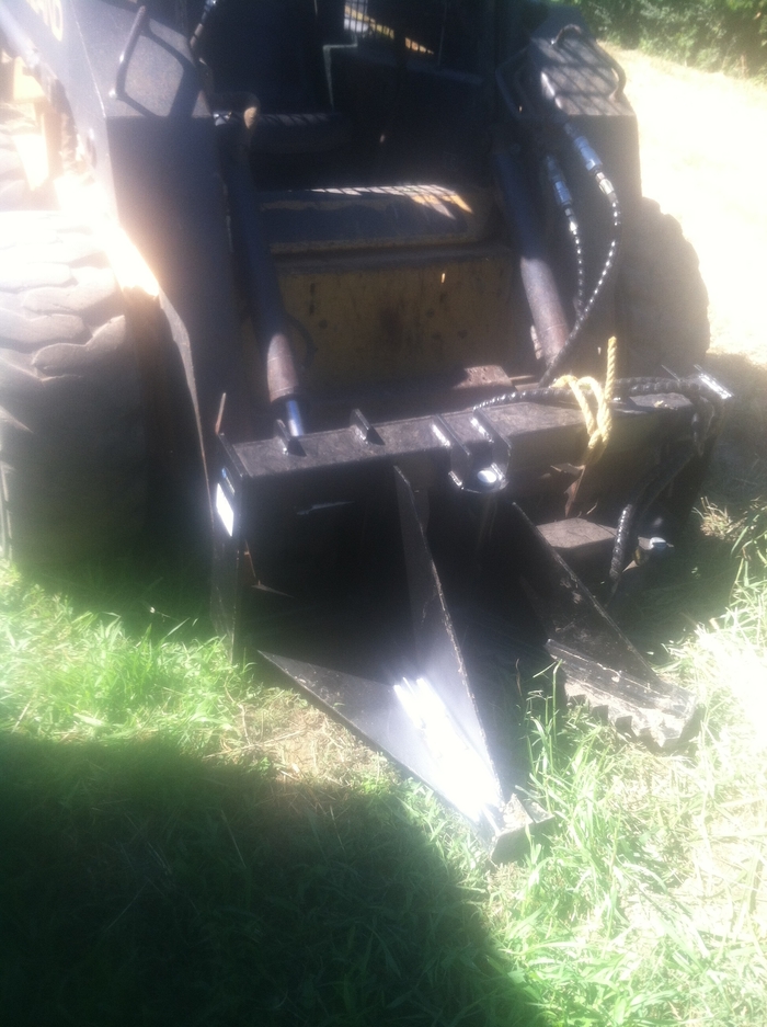

Mine will work on the loader -- or 3-point hitch. I never use it on the back because it is so effective in front. The rear lift capacity is greater however there is no curl function there which is extremely important. I am not limited so much by the loader lift capacity because it will lift the rear tires off the ground on larger trees.

If you had a hydraulic top link wouldn't you have curl? My 3ph lifts more than double what the loader lifts. If you are lifting the back tires off the ground you are being limited. If you are lifting the back tires off the ground then you are not even meeting the rated lift capacity.

Dude, I like that! Who makes it?
But I agree, you maybe need more balast.
/ SkidPro Tree Puller #24
http://youtu.be/E_BO9AEoq8U
I looked at that design, and the one that's built like yours but the clamping action instead of going left and right it is going " to and fro " ugh "front to rear" ugh ? "away from the tractor then back". Of course you'd loose a little lifting power but could reach out farther or maybe in between something you didn't want to disturb. I use mine for keeping up the property not making a living with it so I went a little cheaper but I'm happy with it.
You may need to throw a little weight on the 3 pt hitch. Would make a smoother ride when the tree turns loose. I use a skid steer with it and man sometimes its worst than riding a bull.
