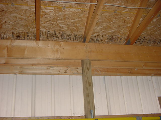

And one more pic.
I put the corregated plastic windows in for light.

I agree with Kevin. Notching the posts and letting the "eave girts" rest on the post and using serrated, hardened nails to attach has worked well for me. If available, I use round poles discarded by the utility companies in the area. However, I'm selective to get good ones. I believe square or rectangular posts would make the project easier.
