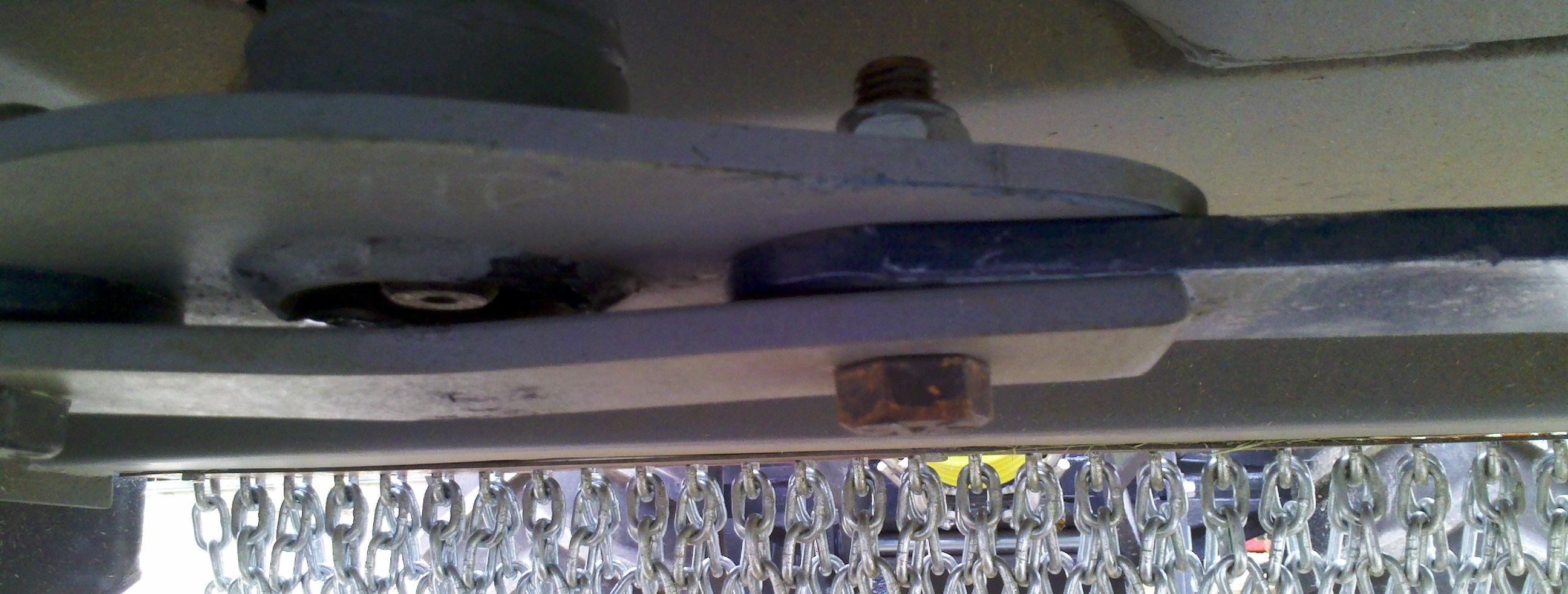

I've just taken delivery of a new MF GC2400 with a 4in1 FEL and 4' slasher and I'm having some trouble with the slasher.
I was trying to adjust the slip clutch on the slasher but every time I engage the PTO one blade swings back and jams folded up. The vibration at this point is fairly severe and I shut down the tractor. I have to use a 3lb hammer to free the blade. I am engaging the PTO at minimum engine throttle.
The blade assembly is two parallel plates with two blades bolted between them, one at each end, and the top plate has the vertical shaft through it and welded. It appears the blade is riding up the weld and wedging between it and the lower plate. The lower plate is now bent and the weld is damaged. Both blades have done this.
I don't know if there is something misadjusted, or if I am doing something wrong, or if this is just an issue of faulty manufacturing or poor design. Anyone have any suggestions?

I don't know. It is now how it came from the dealer. I cut about 350 lineal metres when it was first delivered last night, and then went out today after I'd read all the manuals to check everything over and setup the clutch when the problem started. The manual for the slasher only says how to check the oil and adjust the clutch, nothing else.
The blades swing freely when I've unjammed them, the issue seems to be that when the shaft starts turning and the blades are stationary momentum is going to make them swing all the way back and they hit the bottom of the vertical shaft with some force.
Is anything supposed to limit the swing back at engagement?

A photo is worth a thousand posts... Got one of yours???
Stump jumper is the round part that the blades attach to... in the middle.
/ Slasher swing back blades binding up
You should be able to see from the photo that the bottom plate is now bent, and the dent where the blade has swung back against the end of the shaft.
/ Slasher swing back blades binding up #9
I haven't seen that design before but it is apparent how the blade could bind in that gap. Also, the blade could certainly not rotate 360 degrees.
If it were me, I'd weld a small piece of metal, maybe a large nut, onto the top of the blade about 4" or so from the attachment point to prevent the blade from rotating back into the gap. Some will not like this solution because of welding onto the hardened blade metal.
Rotate the blade until just before the bind point and decide where on the top of the blade the nut needs to be welded to prevent the binding. Do it to both blades to keep the balance.
Further, the mower (slasher) doesn't have a "stump jumper" and the head of the bolt is exposed to the damage that can be done on uneven ground. A quality mower has a rounded head on the bolt and is secured with a key in a reinforced shaft. Can't tell if that is the case from the photo.
If something is struck the blade will not rotate all the way out of the path but it wouldn't anyway with that design. I'd have to say that the design is not the best.
If it is possible to exchange that mower for a better constructed / designed one it would be advisable.
Yup, a picture is worth a thousand words. Had you posted that photo initially, the issue would have been clear to everyone. Instead of a stump jumper, there's a simple retainer bar. And as you say, it's clearly bent. Should be no problem to remove and straighten in a hydraulic press. What's more important is what caused it to bend in the first place. If you hit something, perhaps it will never happen again. But if the steel is simply too soft, it's a manufacturing/engineering problem - and you can expect recurrence. I think the test will be how easy or hard the steel resists the hydraulic press.

The OP knows what caused, or is causing, the bend. The blades are swing back and getting stuck in the gap. The blade is acting as a lever.
Obviously, the blades have a bend in them that wedges into the gap (a photo of the blades would be informative).
The malfunction occurs when the PTO is engaged from stop and the blades don't rotate quickly to become extended. Not sure if the tractor has a way to gently engage the PTO and slowly bring it up to speed.
The mower is new and the problem has been observed from the beginning so it is not likely that something else bent the bar.
The solution is to determine how to stop the blade from sticking / entering the gap.

You can just make out in the photo the point where the blade is striking the weld, there is a slightly shiny spot about half way along the piece of the blade you can see in the photo. The blade has ever so slightly rounded corners.
The tractor is a MF GC2400 and I couldn't find any way to slowly engage the PTO, it seems to be on or off.
The manufacturer claimed that the bar was likely bent in transit and sent someone out this afternoon to fit a replacement bar. Engaging the PTO about 20 or so times since the new bar has been installed shows no sign of any damage to the new bar.
One specific difference this time from the previous is that I had started to adjust the clutch and so it now slips just a little on engagement and that may be enough to protect the plate from taking the full force of the swingback. I think it's a case of once the plate is damaged a little it's stuffed. The old plate actually had bits chewed out of it where the blade had swung back against it. It may also be the case that the previous one was softer or weaker than the new one.
I still don't like the design, but the problem seems to be fixed at least for now. I am tempted to get some kind of ablative or absorptive material to install between the plates, either timber or high density rubber (like the stuff that protects sledge hammer shafts from mis-strikes), to at least protect the weld at the bottom of the shaft (since this still takes the full force of the startup blow).

You aren't doing anything wrong. That's kind of a strange mounting system-parallel discc with the blades in between the disks! That design is asking for problems. My mower has a single "stump jumper disk with the blade bolted to the rim. The blades have an offset that keeps them away from the stump jumper.
I have an independent pto and when I stop the pto, the brake stops the shaft and the blades "fold" under the stump jumper from their inertia. When I start up, the mower jumps due to the torque reaction as the blades "unfold". Perfectly normal.
I'd take the "slasher" back to the dealer and get a different design. As rough a usage as these devices are exposed to, you need one with a better design.
/ Slasher swing back blades binding up #20
The bottom plate is bent allowing the blade enough room between the plate and the hub to get wedged in there. You could take the plate off and flip it over to close the gap between it and the hub and that should take care of the problem. But if its new equipment I'd just take it back to the dealer and let them worry with it.
