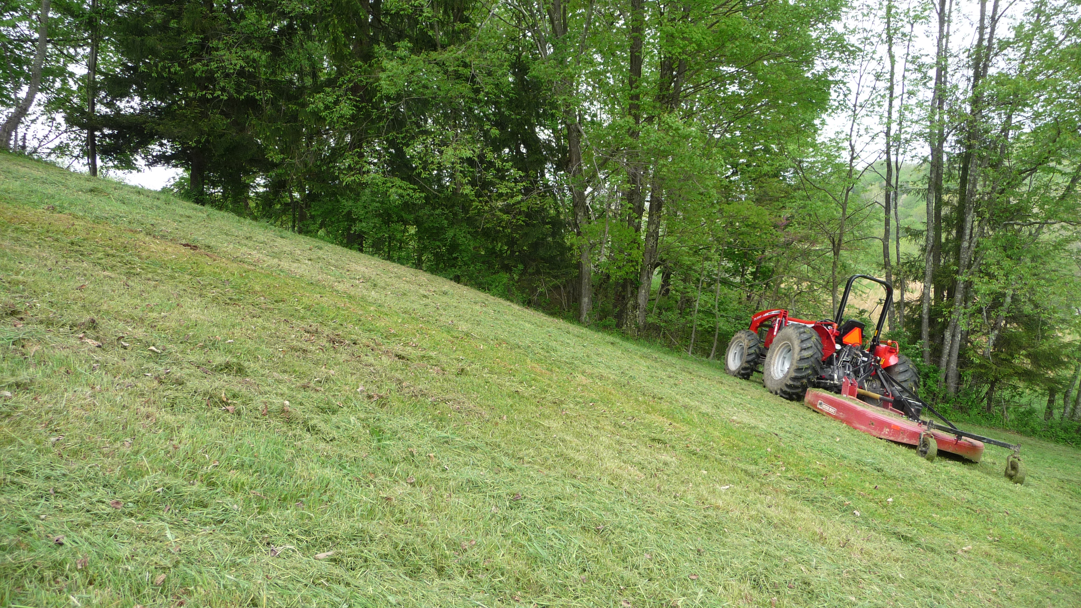

Land is full of 8-degree slopes with a few steeper ones at 12-degrees.
If I take my time and am not an idiot, would that slope scare any of you?
Answer: NO, not at all.
I encounter steep ground and variations of it every year bush hogging. Decades doing that.

3) With your 8 to 12 degree slopes there is very little worry unless you stumble into a big hole with the lower rear wheel, etc. 12 degrees is about a 20% slope which is still pretty mild. I mow 40% slopes many times every season without any problems. My limit is about 50%. Anything over 50% does not need to be mowed by me. A 40% slope can safely be mowed with my MF2660 tractor going across it but a 50% slope is too much cross wise for me. My rear tires are set 8' apart at outer edges and it is a low profile (lower c.g.) tractor. I hasten to say I ALWAYS mow steep slopes up/down unless I am boxed in to some momentary cross slope situation. There is no such thing as too much safety margin.
By the way, I know where every ground hog hole and sink hole is in my farm having been over every inch of it since I was in grade school. You need to get very familiar with yours.

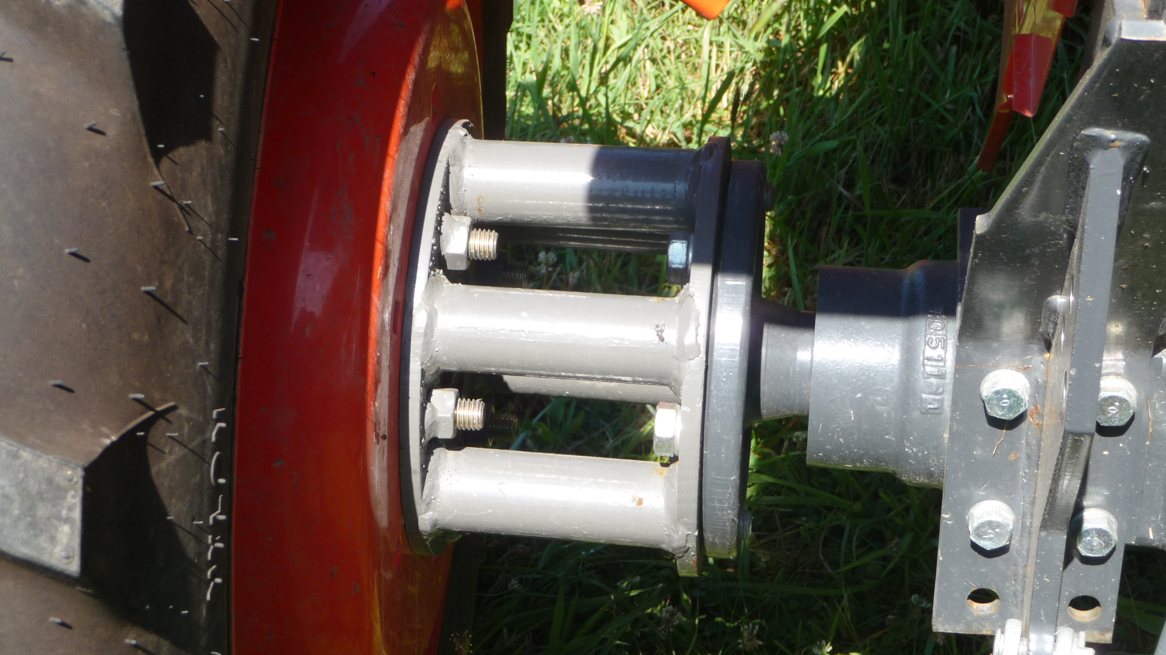

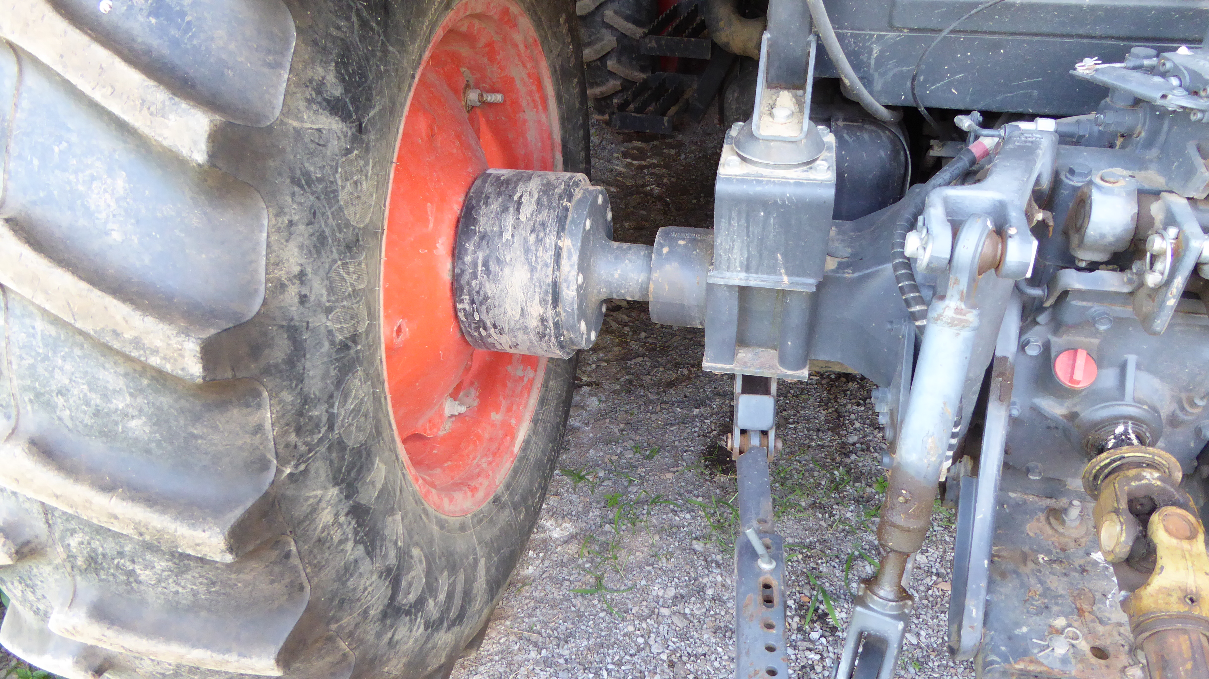

5) I know a lot of Orange folks don't like me saying this, but the Japanese have thick skulls -- they just cannot seem to understand that many of us operate on steep ground. Most Kubota mid size tractors (40-70hp size) simply do not have the ability to spread the rear wheels apart that they should have. My pasture renter uses an M6040 with 6" spacers on each side and were very uncomfortable until those were installed. The same is true with an L3040 they use. These picts show the spacers installed.
6) Unless you have some compelling reason not to, absolutely run those rear wheels of yours out as far as you possibly can. Try it and gain your own experience of course. If you have any discomfort, add 6" spacers on each side (like the M6040 above) and that will give you a huge margin of comfort on steep hillsides.
